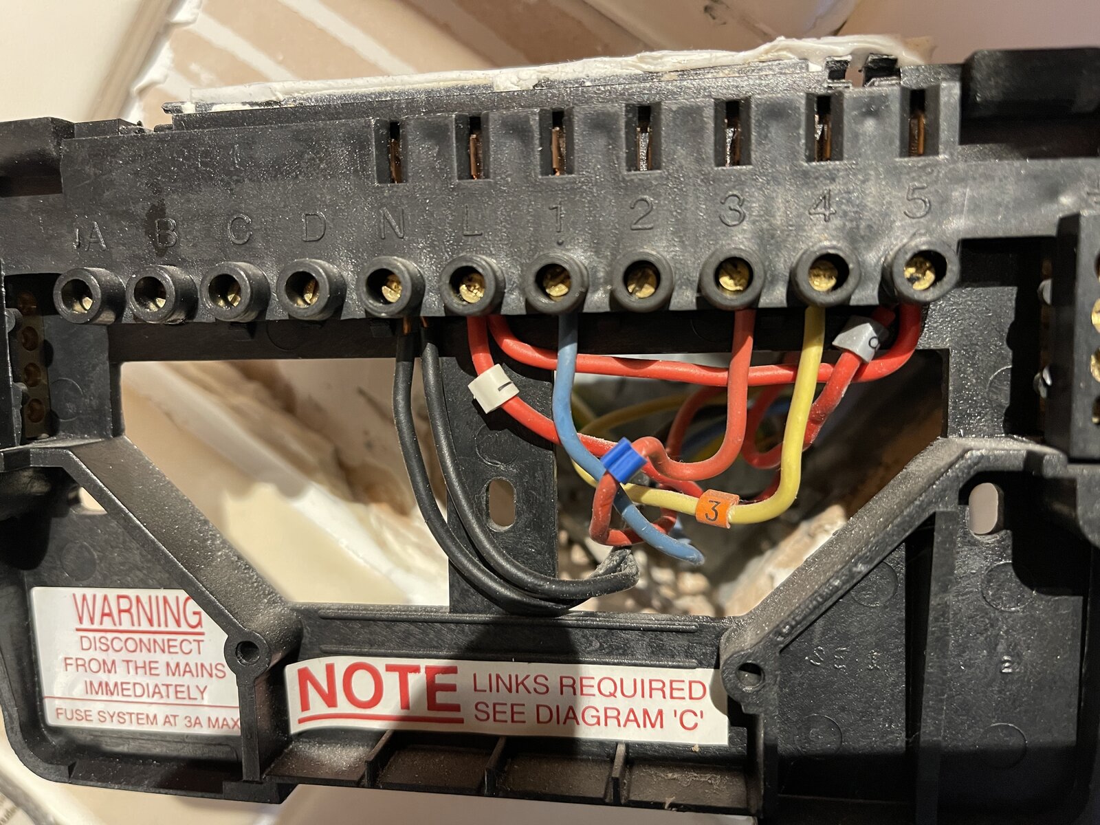

Moved into a new house and the heating is some what antiquated, I'm planning on changing the controller over to a Hive system but before I do I want to make sure its working correctly is the heating is.. pants and the kitchen Rad does not work but that another story.
The issue I have is the boiler seems to cut in and out all the time, and it looks like the system heats the HW when the CH is on regardless of the HW being on or off, now I'm thinking tell me if i'm wrong this is to do with the grey wire on the valve not being connected, so I connected it up, however this caused the heating to just be 'on' regardless if it was turned on or not, so I removed the grey wire again for now. I have removed the EP2000 from the all and looked at the wires to me it seems i'm missing the HW/CH off wires? or its just wired wrong, can some now cast their eyes over the photos and let me know.
