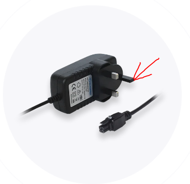

I have narrowed down my selection of Mobile Routers to just three. All have 4 or more Gigabit ethernet ports and WiFi integrally and far more functionality within them than i will ever need. Two of them have "Ground Screws" on the casing. I'll need to find out if these routers require grounding and if they do, do they need either "Grounding To Ground" or if they simply need earthing into a lighting circuit in the loft or perhaps a ring main say in a bedroom somewhere.

How are they powered? As has been said, if their power supplies needed and earth connection, that would be provided via the mains connection (i.e. a '3-pin plug/lead).
So do i ignore the Grounding Screw as it is not needed and rely on the three pin plug to provide a route to ground?
