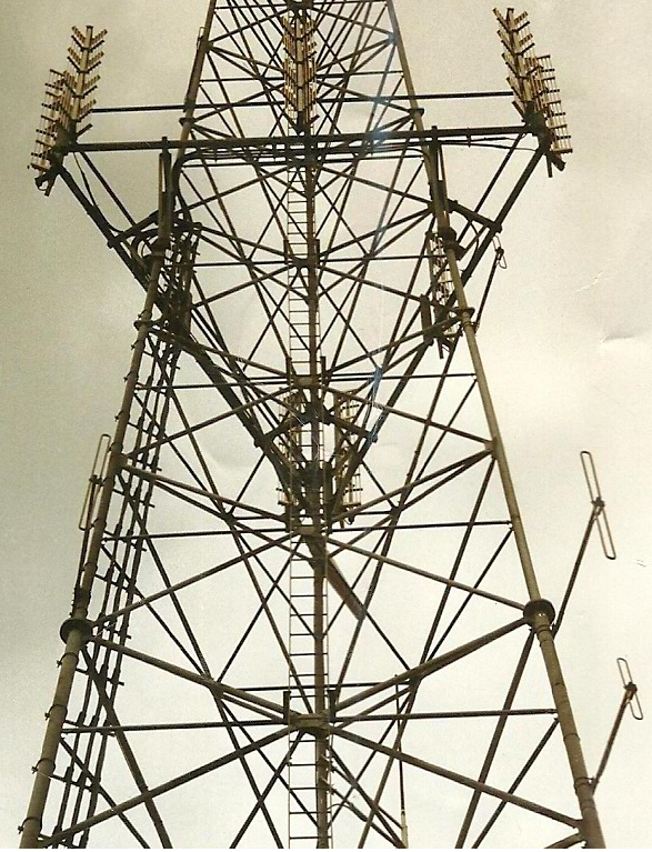

This was take about 1993 and the corner reflector aerials can be seen on the gallery at the top of the pic

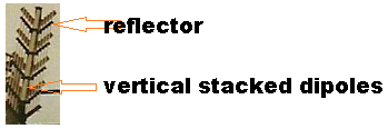

They consist of vertical stacked dipoles in a weather resistant radome [tube] in 2 reflector grills.
These would have been several years old at the time. by mid 90's the aerials made by CS Antennas [for example] were totally enclosed and made using 'stamped out' copper sheet as the elements and either vertical OR horizontal polarised, they would then deployed singly for single polarisation sites or in combinations of both to increase the number of channels available on site.

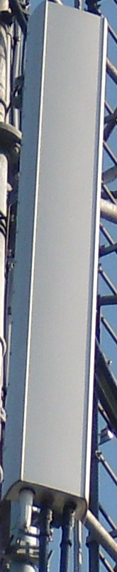

The next generation included both polarisations within the same radome:
Pic taken 2008 but still in use 2021.
The 2 feeders [vertical and horizontal] are visible at the bottom. 45° working can be achieved by correct phasing of H & V signals

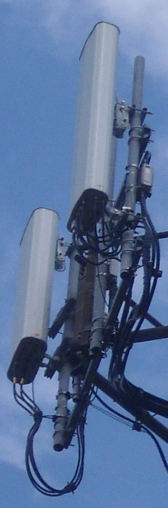

The latest generation are multi aerial multiband units, these have 12 sockets, left has 4 feeders right has 8 but sorry not very clear from ground level with a cheap camera. I have no working knowledge of these but some also have some sort of control cable going to them.
