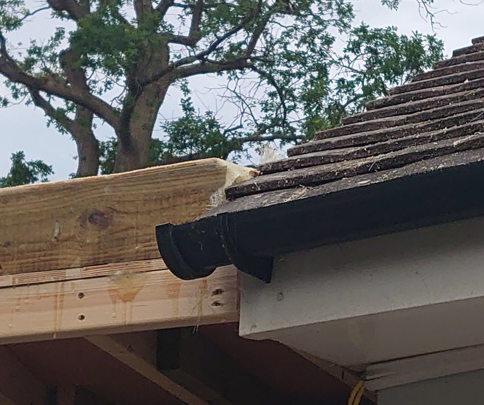

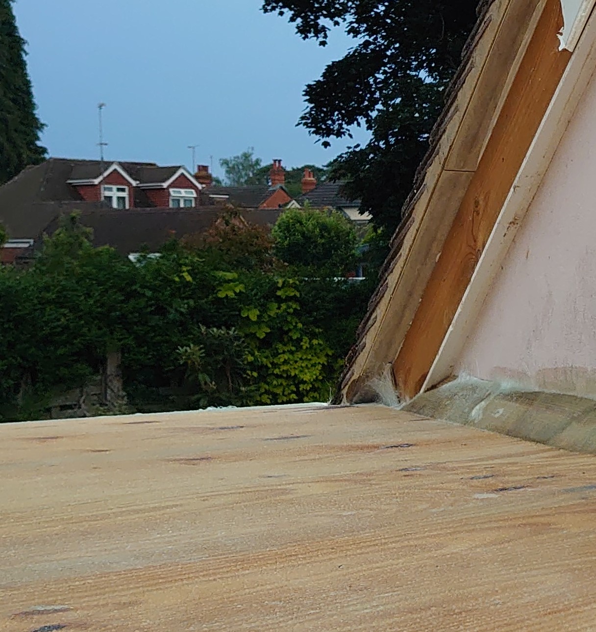

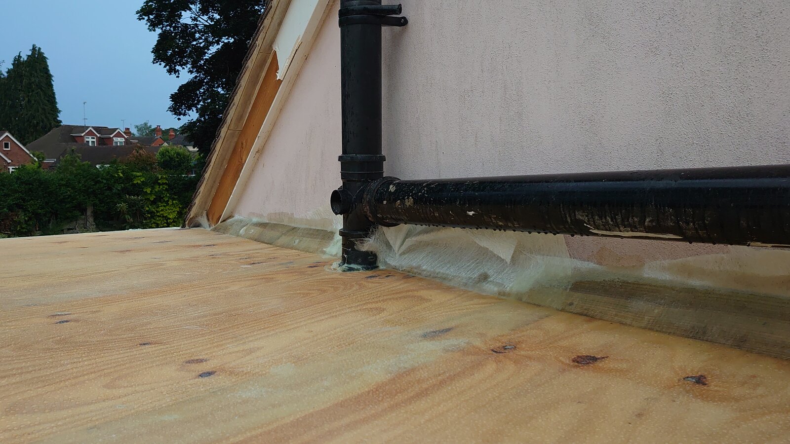

Hi all desperate for some help..
How do you join a GRP flat roof to tile where the tile would cut through as the GRP corner needs to be higher?
I'm guessing you try to keep the GRP under the tile..but I'm a bit kerfuffled on how to do this bit.
Any help greatly appreciatted.

That fillet effort up the wall isn't a particularly clever idea- usual deal is an upstand (moulding) and cover flashing.
