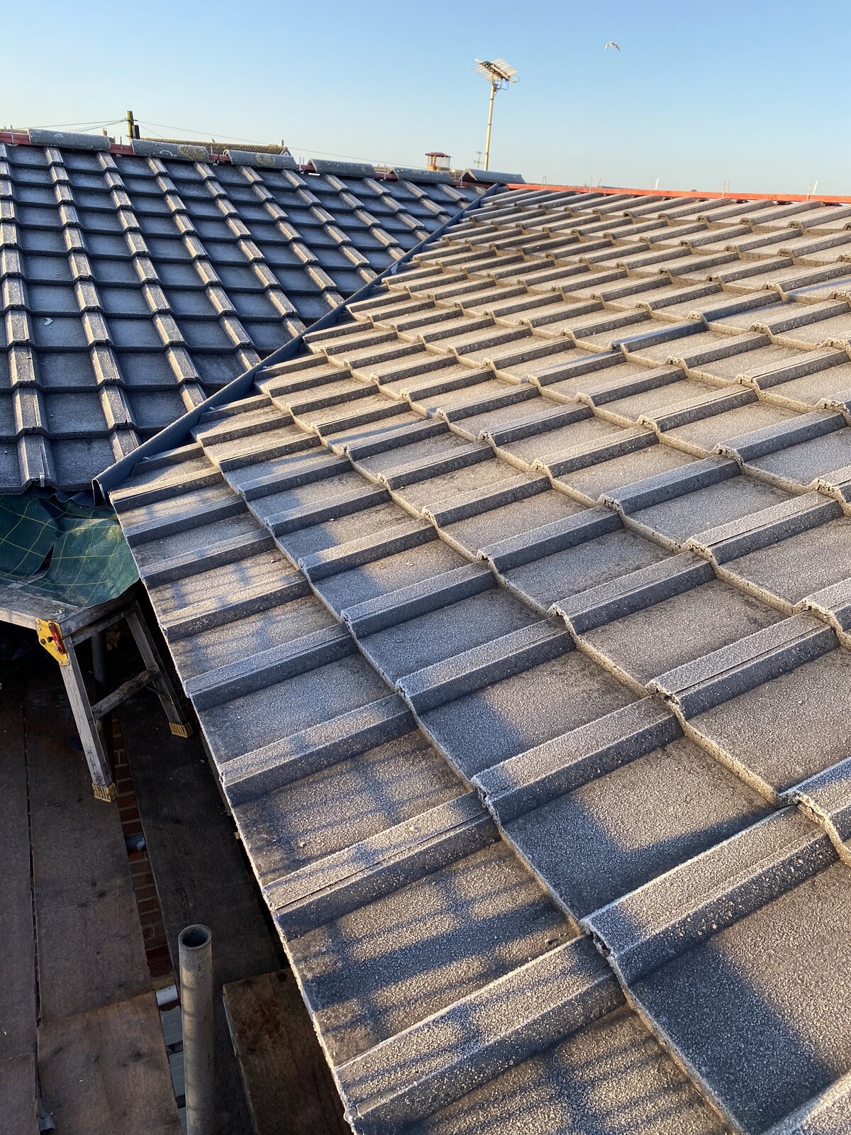

Doing mine myself at the moment - not fun in the winter...here’s today’s view.

Wow, bloody top work mate! Looked at those Marley's when doing my little extension - nice choice.
I think you've got a thread in the Readers Builds section? I'll go and have a catch up!
Thanks, not updated the thread in a while as been busy.
My roof had the Wessex on previously, and is a shallow 17.5 degree pitch, so my choice of tiles was limited to be honest.
