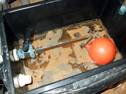

Earlier this year, I replaced several old Danfoss TRVs on my system with Drayton RT-111 TRVs.
I took the opportunity to clean the system using Sentinel X800 (applied strictly in accordance wit the manufacturer’s instructions), and having flushed it twice, then added Sentinel X100 inhibitor to the final fill.
All has been working well since, and the boiler (an old Pottertton Netaheat 16 22 Electronic) has been running more quietly.
I had a look in the expansion tank today, and found that it was full of gunge (best I can describe it – a bit like the skin that forms on custard when it cools). I’ve included a couple of pictures.
I’m concerned that eventually this gunge may find its way down the cold feed and block the pipework (which is microbore, distributed through manifolds)
Anybody got any idea what this gunge may be, and why it has formed so soon after a thorough clean?
Looks like brewers yeast!
When introducing the inhibitor to the f&e tank, I think you are meant to hold some back, when tank is full, pouring in the remainder, so that the tank has some concentration of inhibitor. The chemicals have some sort of preserver.
Stagnant water in a loft tank gets hot in the summer and all sorts of bacteria/mould will grow, especially if you have bats/mice/whatever falling in.
It could also be back flow or venting over.
tryitandsee: thanks for your reply - shall I draw off a pint for you, and would you prefer it in a tankard or a straight glass? :lol:
I've re-read the instructions on the Sentinel inhibitor, and it doesn't mention holding some back and pouring it into the f/e tank when full.
I take your point about water stagnating more quickly in summer, but bearing in mind I only added this stuff in March, do you think it will have stagnated that quickly?
Re: backflow and venting over - what could I do to check whether either of these are causing the problem?
thats the difference between a diyer and a heating engineer.
watch the tank when it starts/running.
or feel the water in the tank is it hot/warm.
