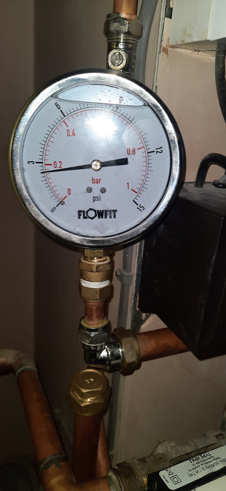

I assure you I'm not worrying about facts and figures, but I do wonder about the quality of advice of someone who holds them in such disdain. Here is how how I managed to measure pressures to 1 decimal place.
Moved into 4 bed detached Victorian house last year. Wasn't particularly warm over winter and have decided to investigate. Found boiler is short cycling, 2 minutes on 2 minutes off. Boiler switches off when outlet temp reaches about 75 C, and inlet temp is 55 C. Cleaned out system with Sentinel x800, but that has had no effect.
Found bypass valve was always open so took that off and found it jammed with black gunge. Put in a new one which stayed closed until I foolishly turned down pressure, now that one will not close!. Replaced it temporarily with stop ends.
Knowing boiler output and delta temp over output, calculated flow rate through primary and hot water tank circuit at 16 litres / min. Have put pressure gauge where bypass was, after pump and before motorised valves. Static pressure is 1.7m. This increases to 2.4m (0.7m above static) when pump is running and hot water tank circuit motorised valve is open. Gauge reads 3.2m (1.5m above static) when pump is running and valves are closed. Pump is BG Grundfos multihead G that I cant find curves for. Pump setting 3. Have curves for selectric and super selectric which I understand are similar and give a maximum head of 5 to 6 metres, and a head of 4.5 to 5 metres at a flowrate of 16 litres / min
So it looks as if the pump isn't producing the required flowrate and head. The piping immediately before and after the pump strongly attracts a magnet, and water drained from the pump is dirty. Could the dirt be affecting the pump? If I replace the piping could I clean the pump? I see there are cheap refurbished BG Grundfos multihead Gs available - are they any good? I'd love to hear your thoughts on how to proceed. Thanks
As suggested, standard gauges wouldn't go to that level of accuracy and it would be strange to see someone on here asking for DIY advice with that sensitive level of equipment. CH engineers wouldn't even have that as part of their usual toolkit. I don't hold any of the figures is disdain, neither did I suggest I did. All I said it that level of detail doesn't need to be focused on when it comes to fault finding poor circulation on a CH system, especially give the original info. This is a DIY site and it would be very unusual for anyone to go to that level for fault finding and fixing a circulation issue.

I don't really expect someone who suggests I shouldn't worry about facts to concern himself about the difference between "strip out", meaning "remove", and "strip down" meaning "disassemble". If it's inconsequential whether or not the crap got into the pump before after the clean, why mention it?. I'm not disputing that you mentioned "standard" gauges, whatever they are, simply answering your query.
Good suggestion. The impeller was nearly full of baked in crap. I spent 20 mins poking it out with a bit of stiff wire and now produces a 5m head rather than the 1.5m before. Thanks!
