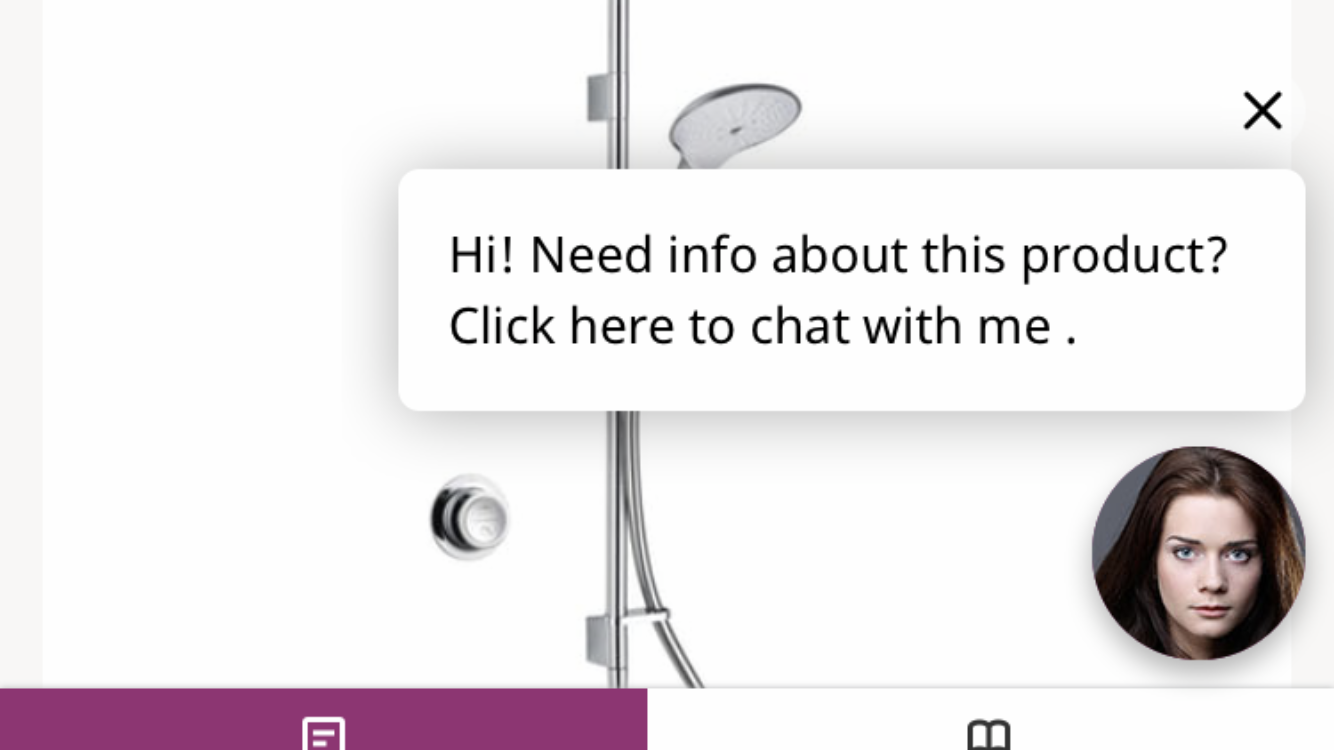

What a good idea to save having pipes in walls!!
The staff there look really keen to help
