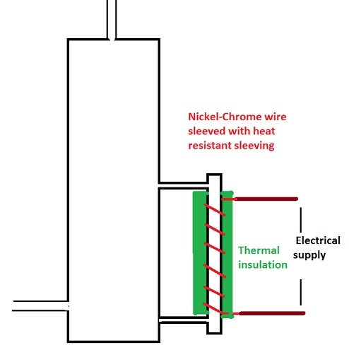

Depending on the pipe work around you hot water cylinder "alternatively generated" electrical energy can be used to heat water in the cylinder without the need for a second immersion.
One option is to remove the thermal insulation from the base of the cylinder and wrap an appropriate length of insulated resistance heating wire ( such as Nickel Chromium in fibre glass sleeving ) round the cylinder. The replace the thermal insulation.
Another option is

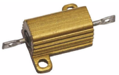

An apparently sucessfull installation from scratch was to stand the cylinder ( a smallish one ) on a copper plate to which several high wattage resistors had been bolted.
