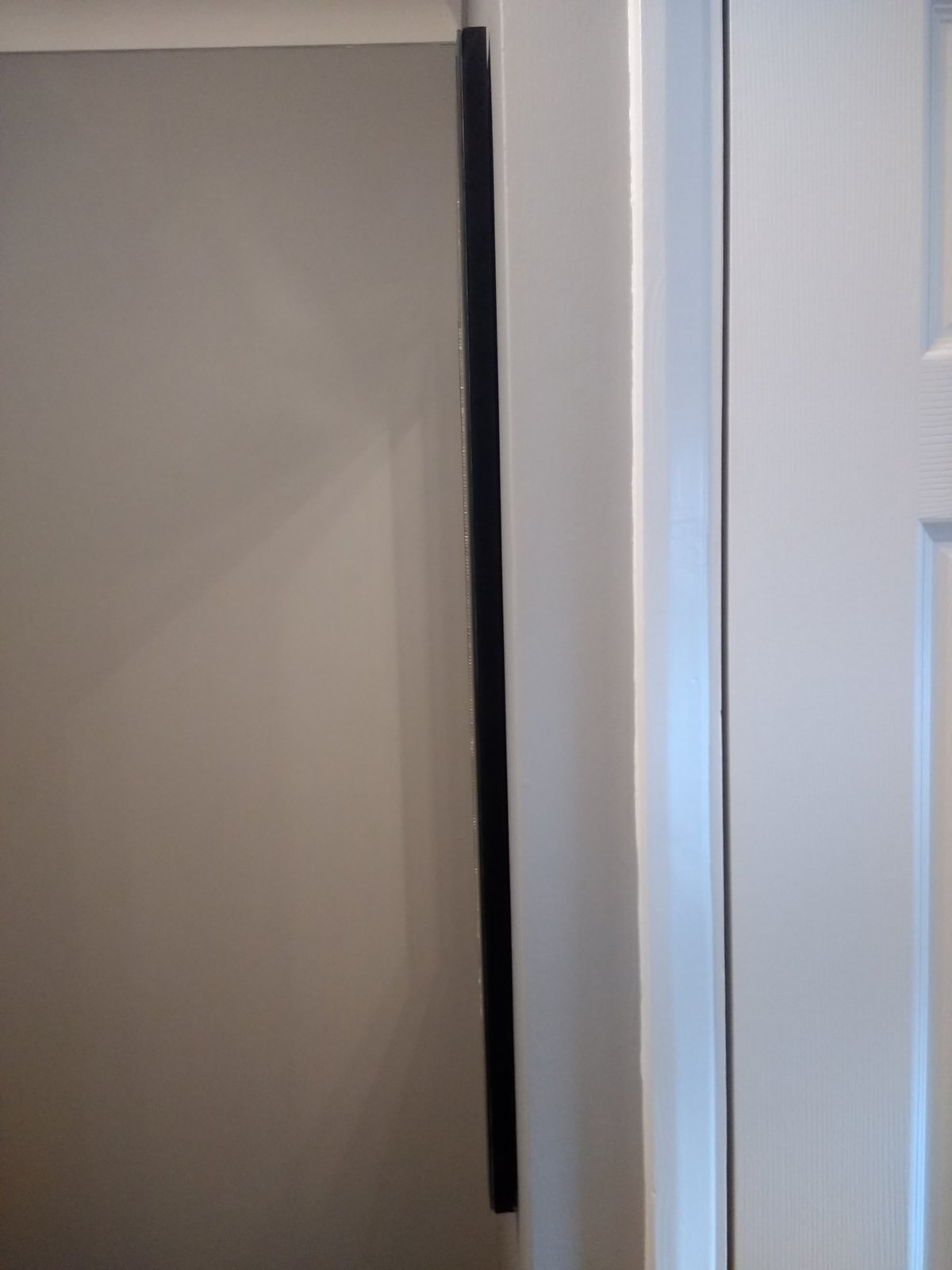

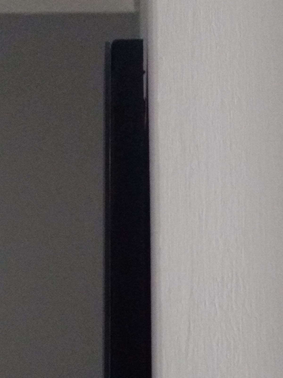

Wife is happy (temporarily). Thanks for your help people.
Congrats.
Which type of fitting did you go for in the end.
