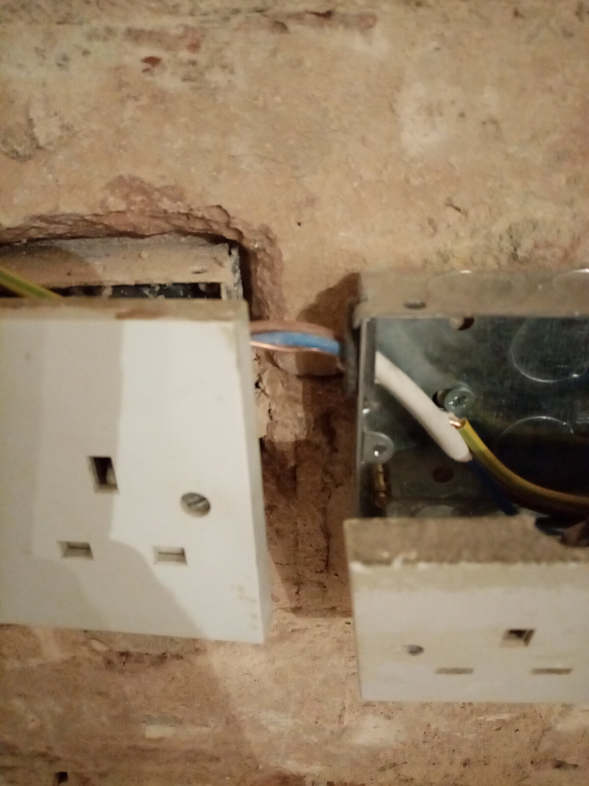

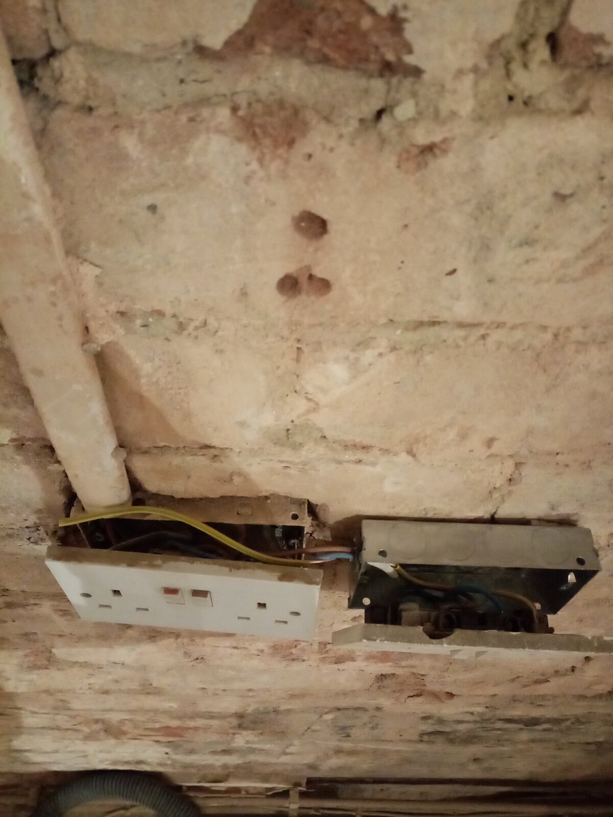

This wall is being overboard. Has the sparky done this right? Cant see how the board and skim will work with thr cable joining the two plugs?
Ignoring that cable is not properly double insulated twin and earth.
And cannot see if a spur off a spur.
And single insulated cables should not be outside the back box.
And Right Back box not sunk into wall so will protrude through plaster further than Left back box.
And earth is not also attached to back box terminal.
It appears that The wires are not passing though a hole in the left hand back box.
They are in-front of the left back box - ready to be chopped off when plaster board is fitted.

What do i do to correct this job? Should i do it myself lr wait until sparky comes round?
Its actually his mate doing the plastering so im sure he will say something?
