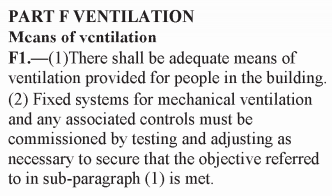

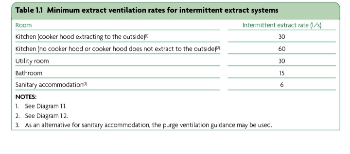

I wondered where you are getting your calculations from?
I believe the minimum ventilation requirements from Part F, are quite a bit lower...
And if, for example your utility room was constantly in use and 'wet', you could use continuous ventilation, recommended at only 8l/s

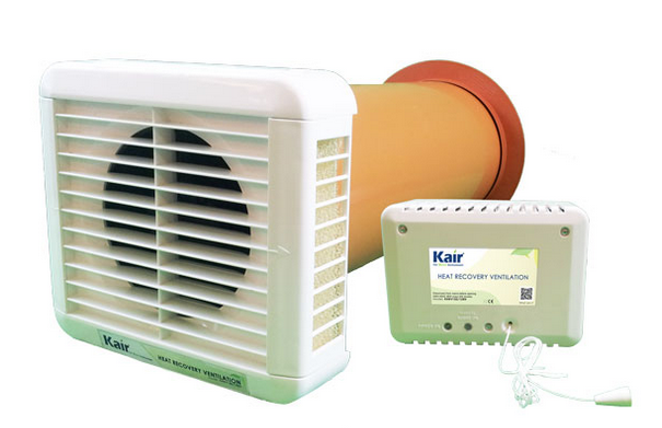

Also how long it is running for, units like this 1681777685795.pngcan run 24/7 as air going out heats air coming in, as @RandomGrinch has pointed out, although little point with a unheated utility room.
