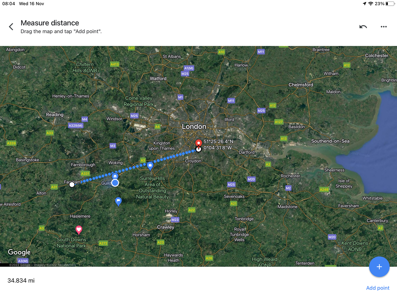

what i havent given you is the location, signal strengths etc for the muxes from crystal palace at the site.
But they are in Farnham and 35 miles from crystal Palace transmitter as the crow flies. Coverage map suggests inside good coverage area, but only just not much of farnham is. They,re on the south side of farnham up a hill to some extent.
Most other houses on the road point to crystal Palace. Guildford transmitter would be another option as it is virtually the same alignment but vertically polarised. Lower in output but quite a lot closer, say 8 miles or so at a guess..
A lot of other properties run mast amifiers, you can see them but that could be a hangover from analogue days...
But, to get to the point eventually, I don't think his signal strength is that high to start with on free to air. So although the single run I tested to the most remote point worked at 100pc quality, signal did say 30 or 40%. But percent of what value. I don't have a proper signal meter device.
That why I thought with 8db loss, maybe a little more, from a signal that maybe the low side of good would be wise to amplify, especially when splitting amongst another 2 x sets, 3 in total used.
