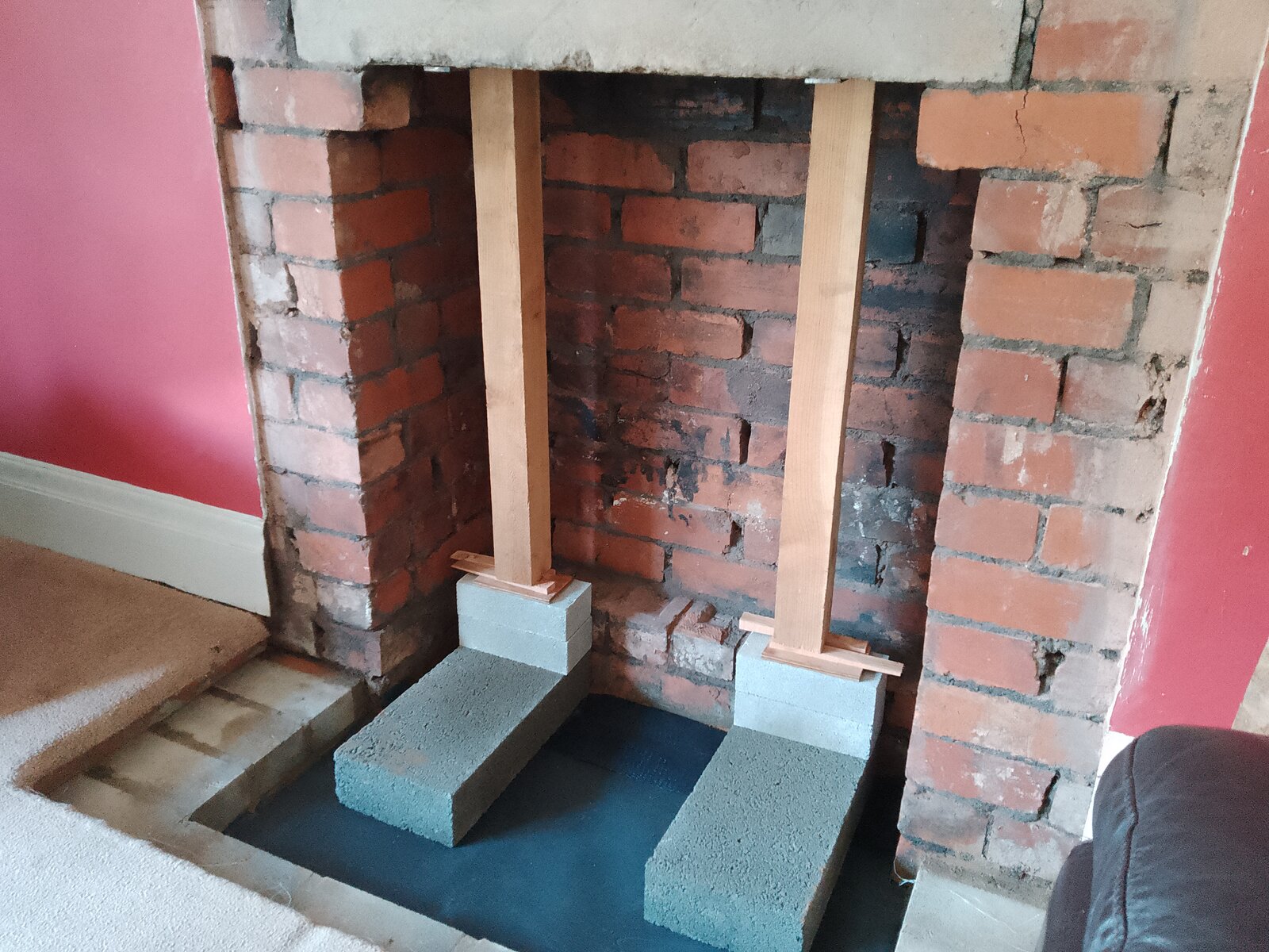

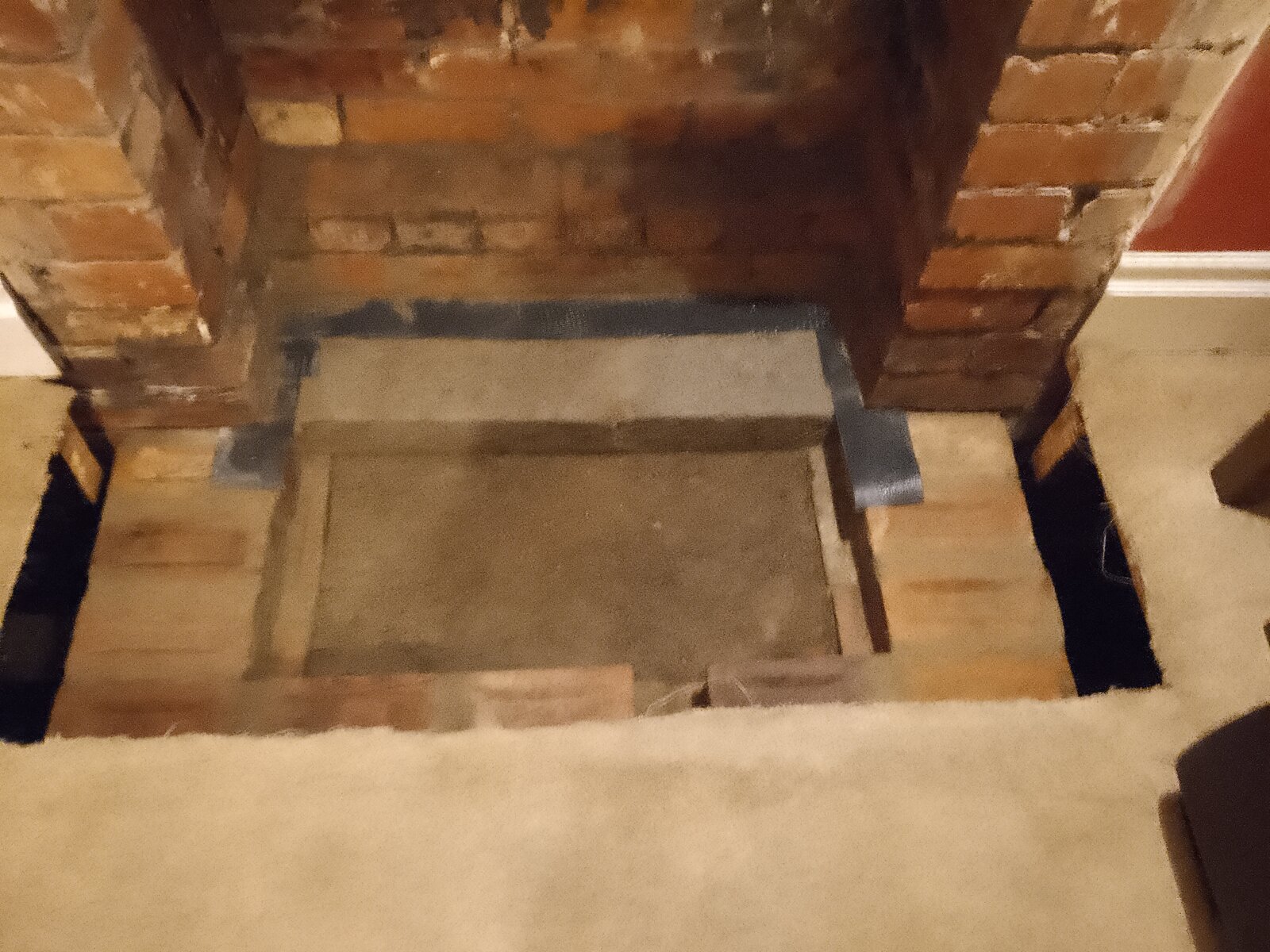

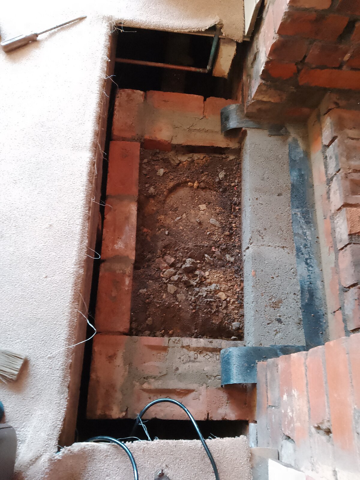

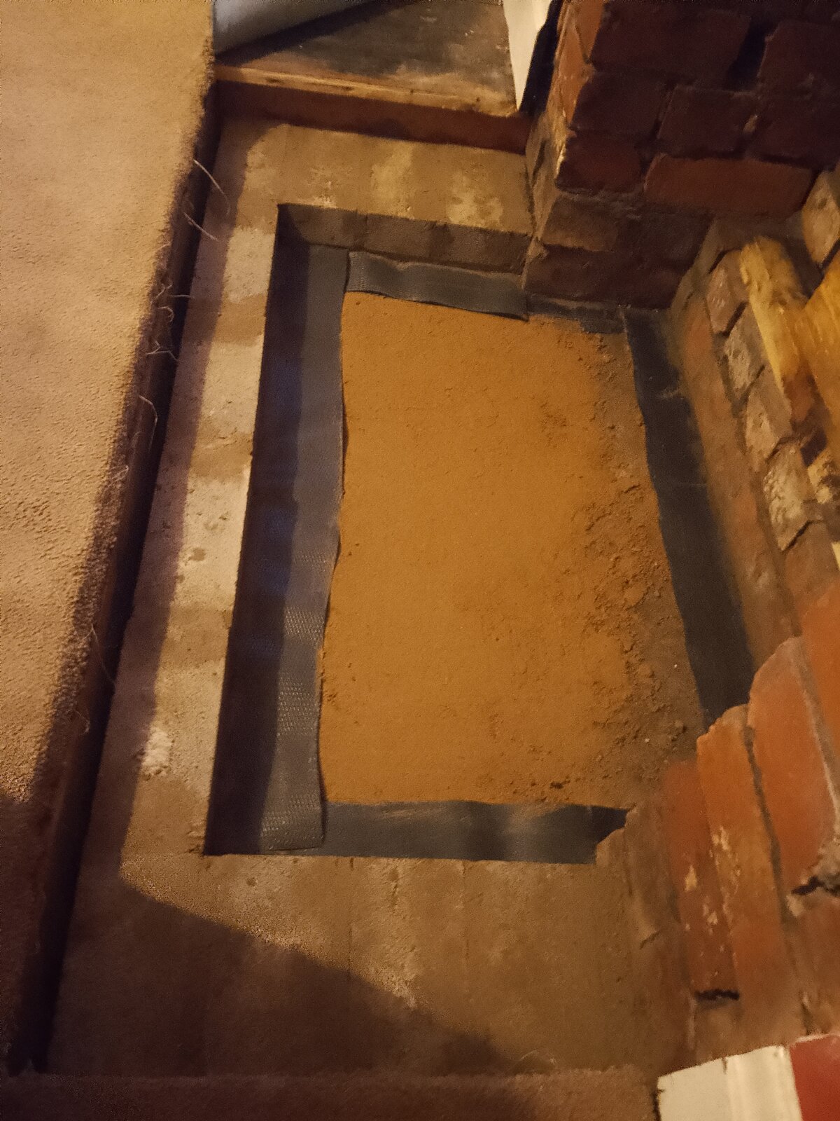

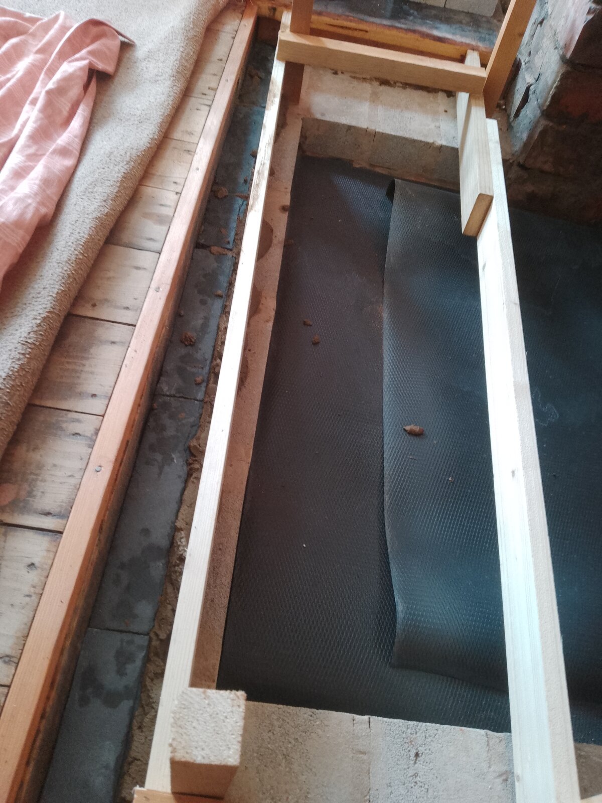

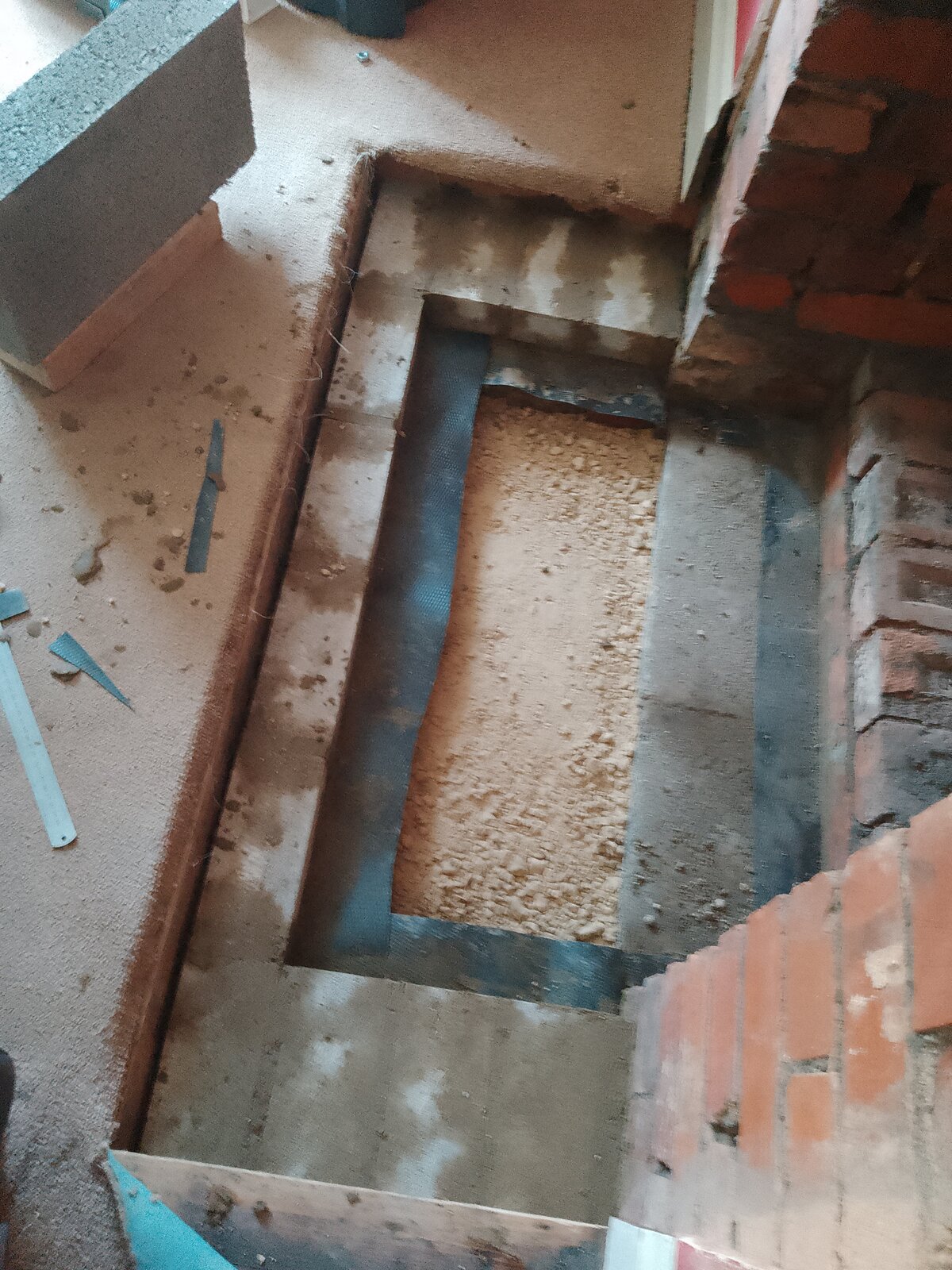

Hi. I'm rebuilding my hearth and trying to install some sort of dpc/DPM. There is a bitumen dpc running in the main wall and I have managed to rake out a little of the joint above this to allow me to insert some dpc sheet. I've attached some pics which show where I'm at. Basically my next step will be to infill the central area with sand so it's flush upto the brick work then apply a membrane across the whole area. I will then shutter the edges and cast concrete upto floor level. I know it's not 100% correct as I've obviously not got the specified dpc overlaps (will have a about 60mm min). But I think it's the best I can do in the situation. I'm basically I novice and am open to constructive criticism so just posting on here to see if anyone can a assure me I'm roughly in the right track or b tell me I'm doing it all wrong. Thanks in advance

Morning,
I’m assuming your floor is concrete that your building the hearth on, if so has it already got dpm under it? You only really lay sand on dpm when installing insulation in there.
If it’s a concrete hearth and you want dpm there’s no issue just fill it with concrete ontop of the dpm… id of maybe used liquid dpc in this scenario.

Hi Jake thanks very much for the reply.so The bricks that you see in the picture extend down (into the void under the floor) for about 1m and are basically just built on top of earth so there is no actual DPM/dpc.
Ah ok that makes more sense, then way I’d of done is type 1 , layer of sand , dpm, concrete or self Leveln g.
Ideally your dpm should lap
Your dpc

Thanks again. Yes I'll do sand before dpm then concrete in top. I'll get lapping on all dpc to dpm joints (might not actually get what regs say but I'll take my chance lol) glad to hear that I'm roughly on the right track as had a bit of a slating on another forum basically saying I was making a right **** up

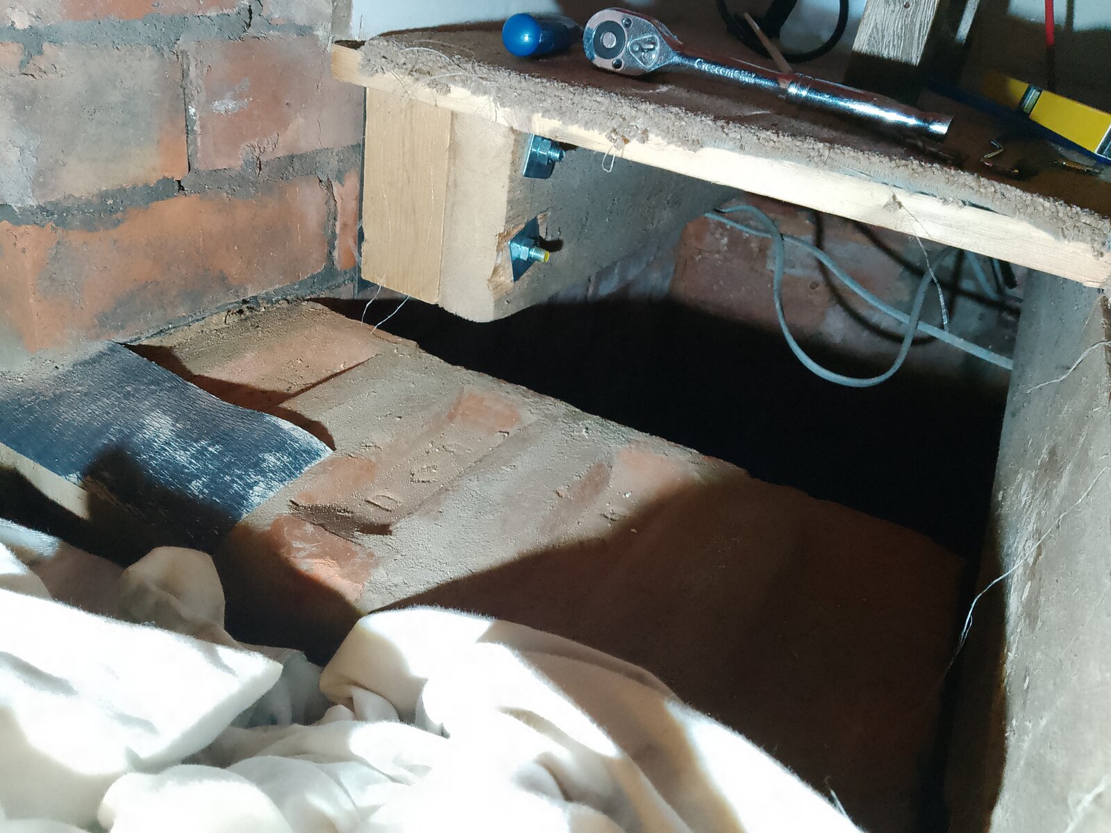

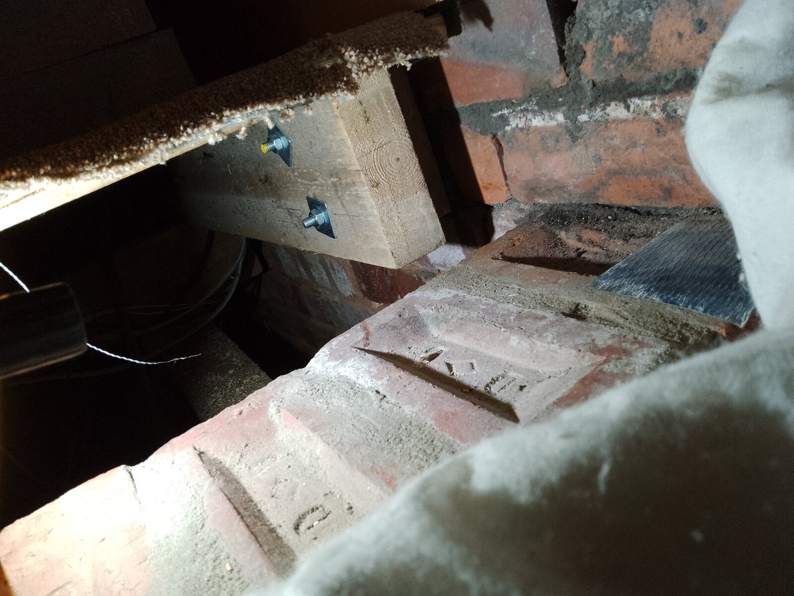

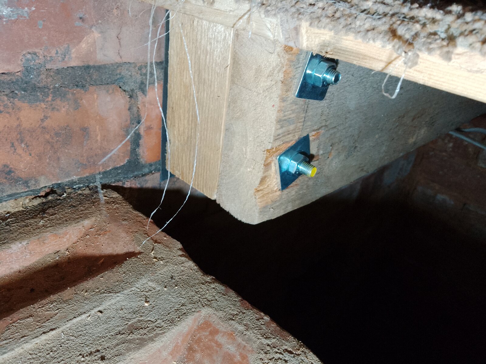

Just an update on my work as may help someone else. Not really sure if I'm doing things exactly by the book and always happy to receive advice or pointers. The 2 joists which originally sat embedded into the hearth are now cut back and chemical stud fixing into brickwork. The lower fixing in one of the joists pulled into the wood a little as it was still a little soft even after cutting back but the joists are now rock solid

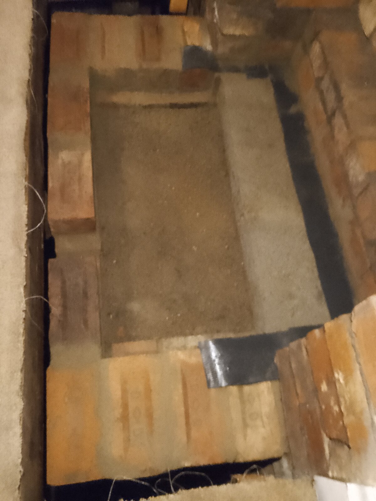

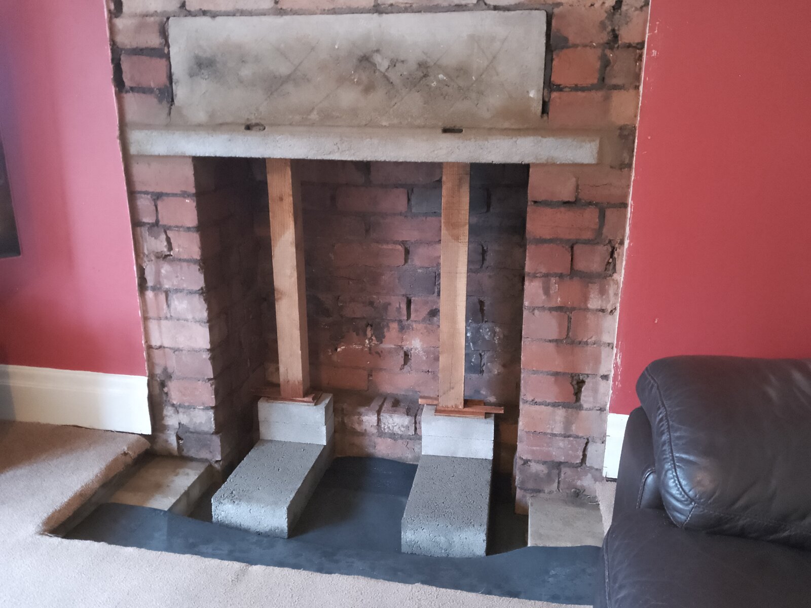

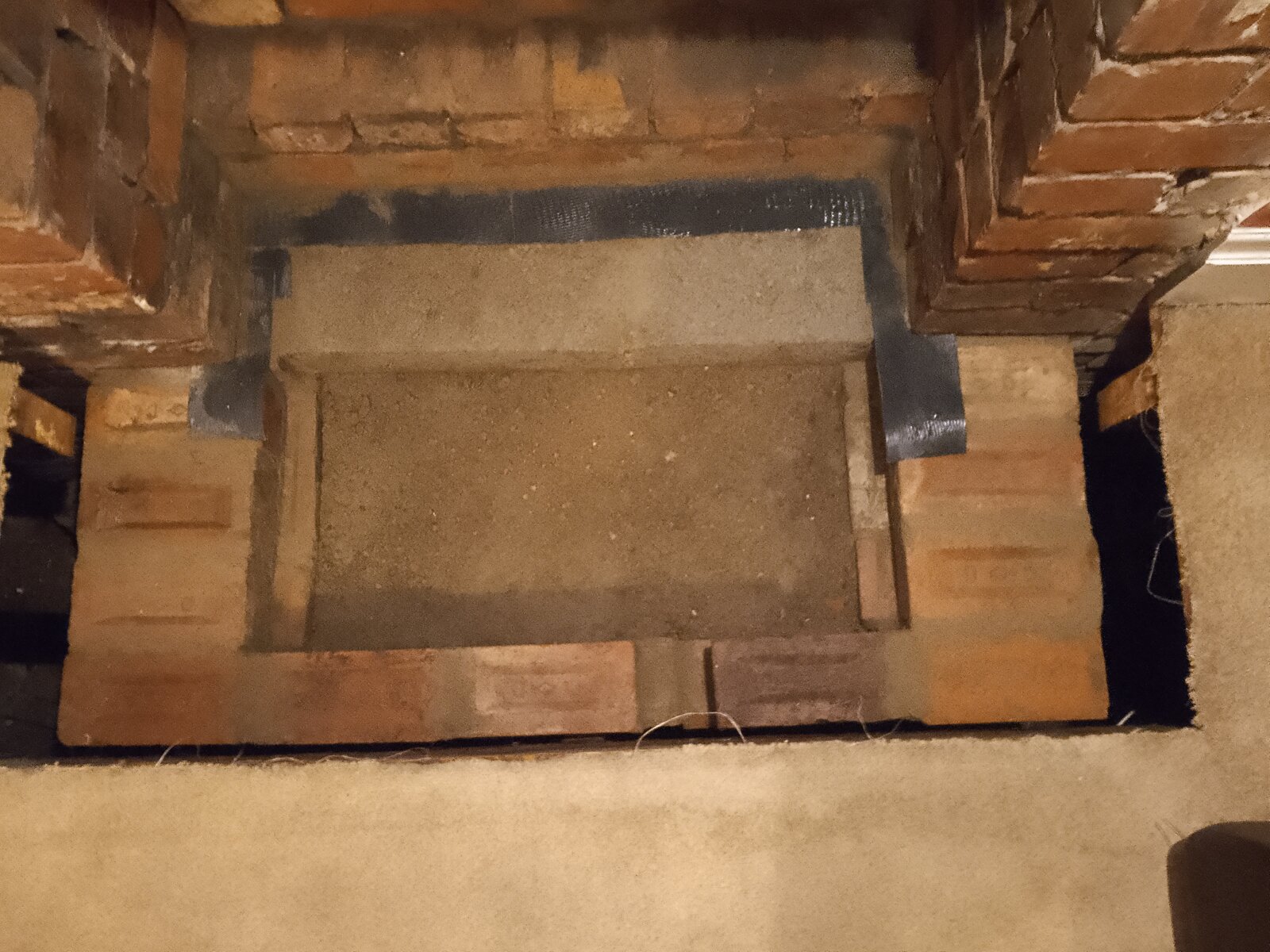

Last course of brick now in and damp proof. Just need some membrane for the central area. Then going to pour concrete to bring to floor level. As before I'm a complete novice just doing what seems the best way so any advice is always welcome

Little update.got the dpm in place and now all ready to pour concrete up to floorboard level.

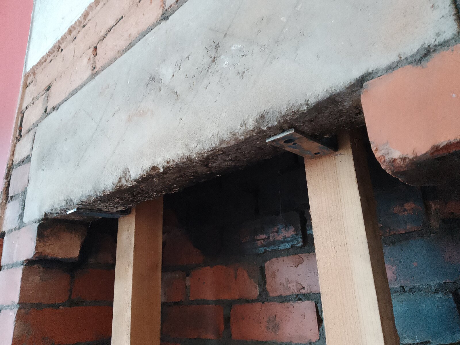

original lintel was poorly fitted. think they must have realised last min that the lintel was too short for the opening so stuck a couple of overhanging bricks in(suppose regs were very different in 1930s) suppose it's lasted like this for nearly 100 year but I've fitted another lintel while it's open

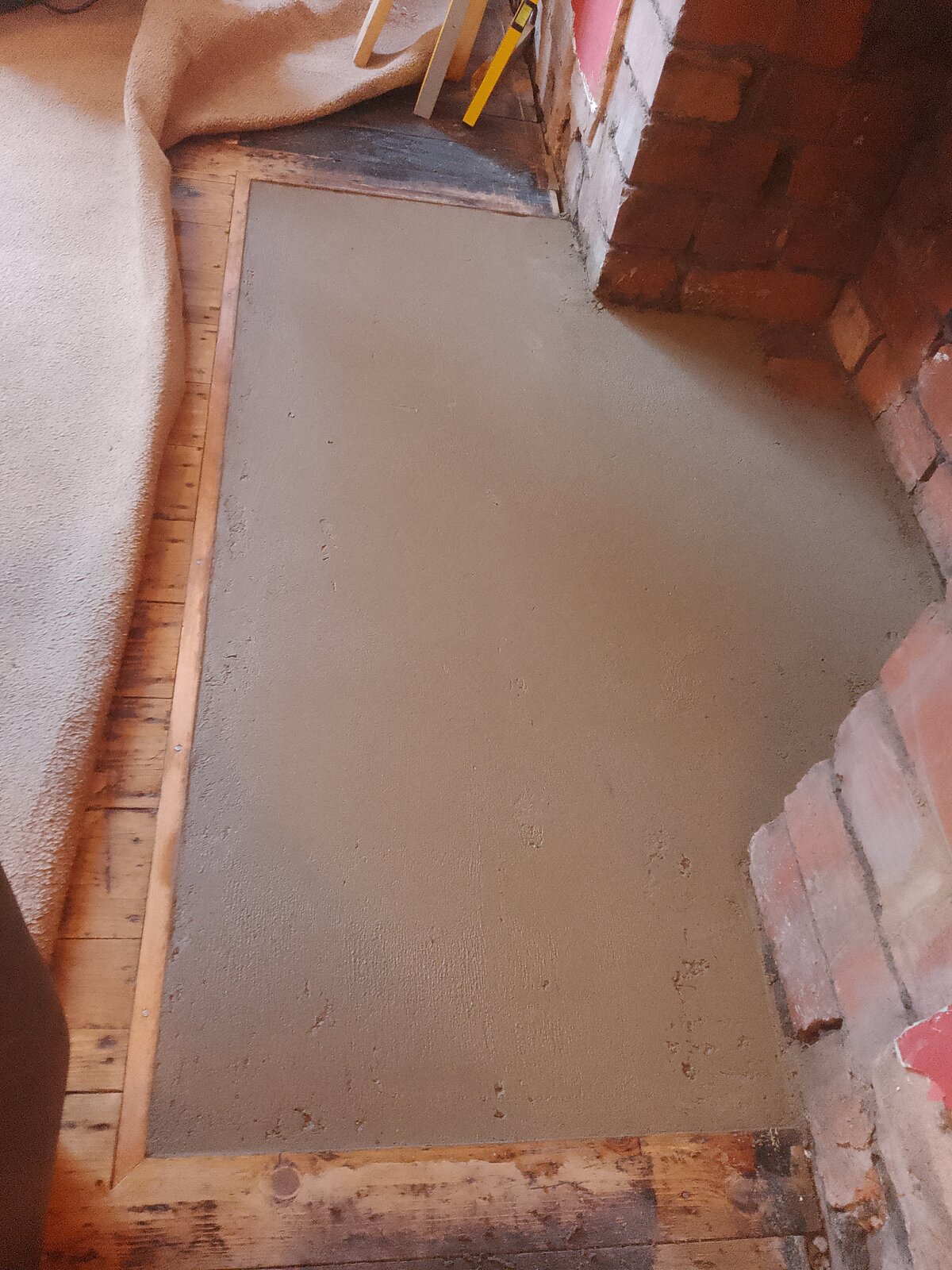

Finally got round to gettin the concrete in.floor is a little uneven and wanted to get the hearh nice and level so built a little frame to give myself a guide to work to

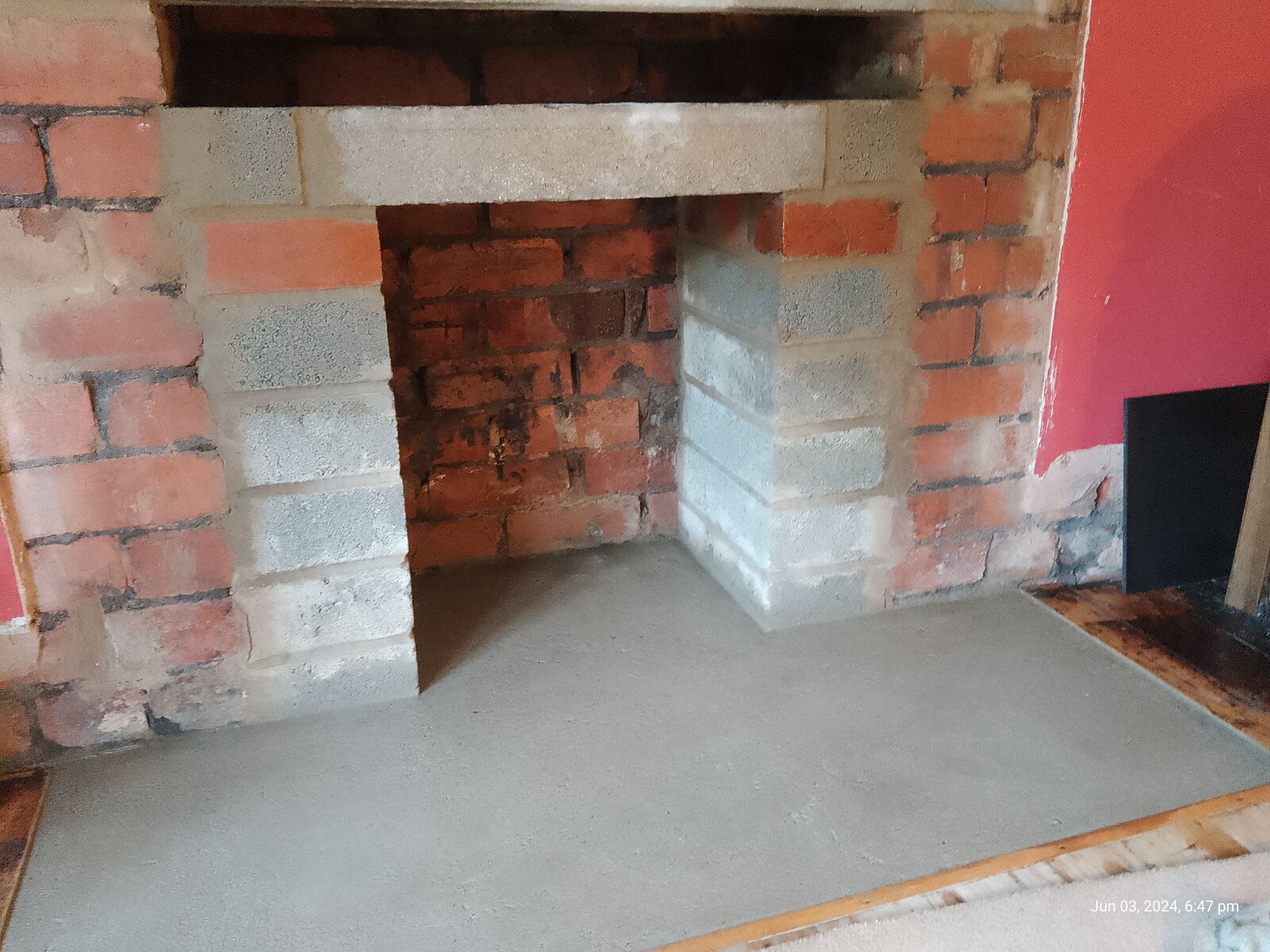

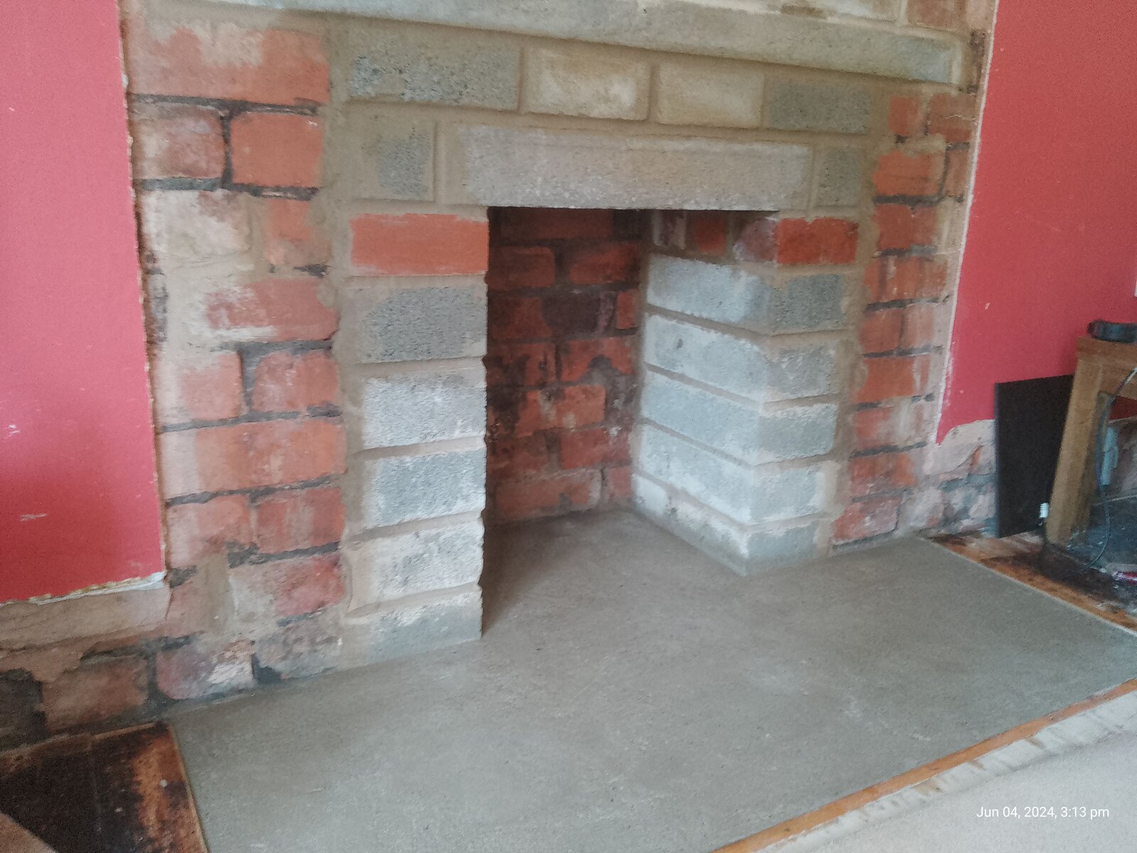

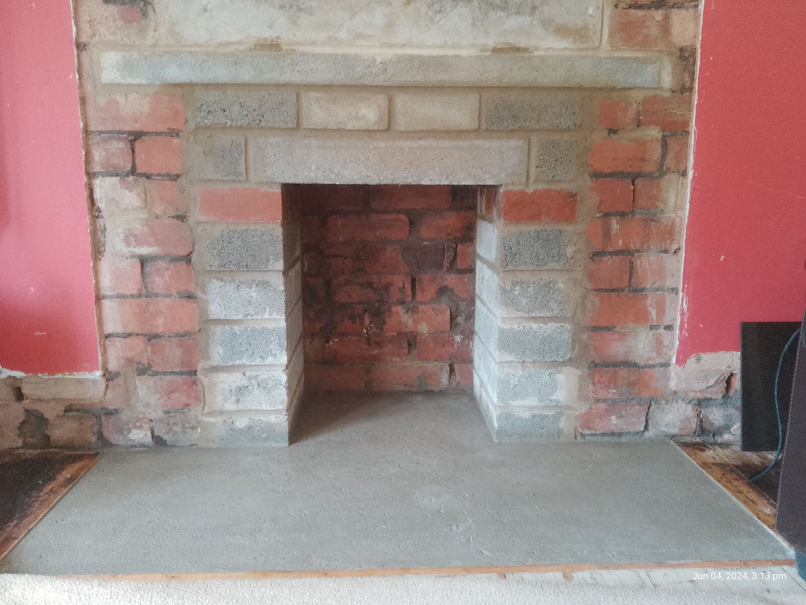

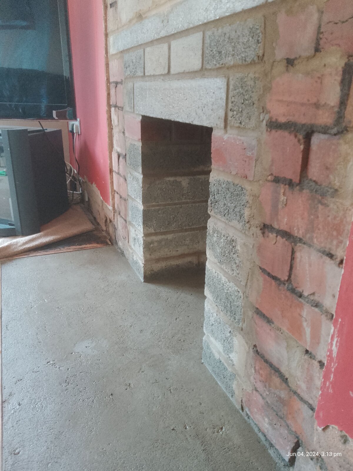

Again just an update on my project. hearth now up to final level and opening bricked up. It's been slow going but feel like I'm getting somewhere now. Always happy for advice

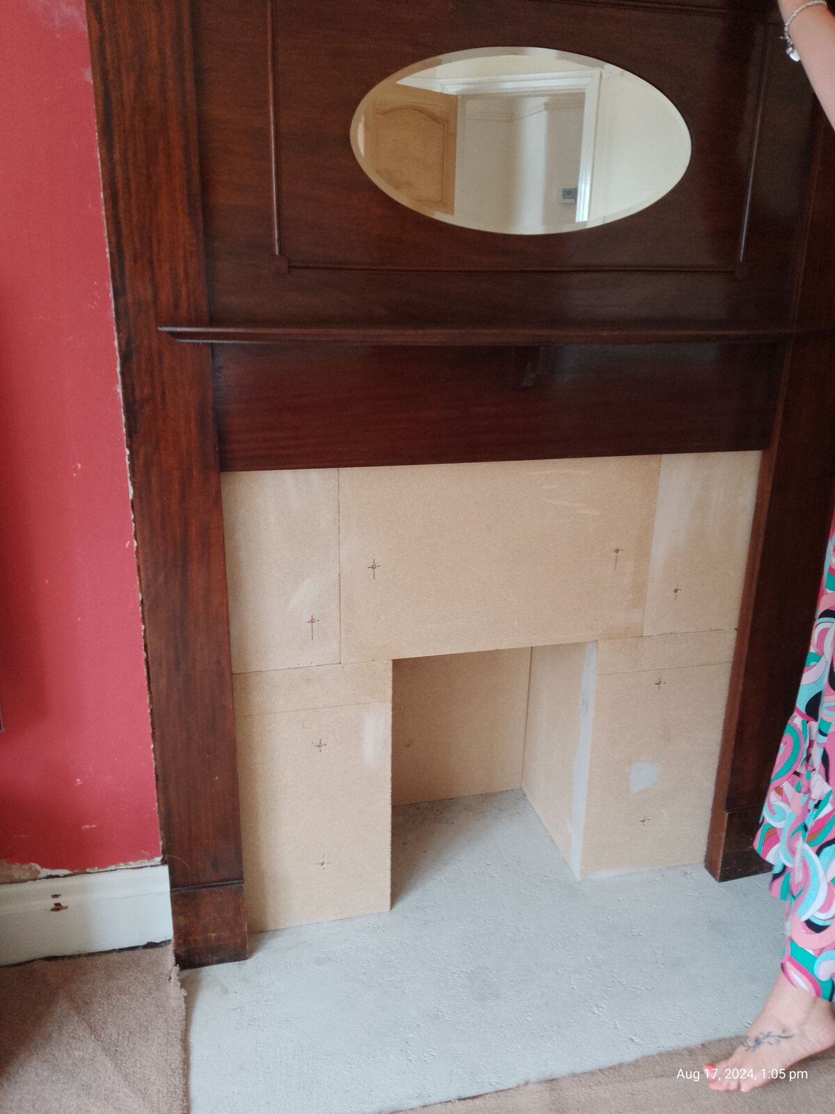

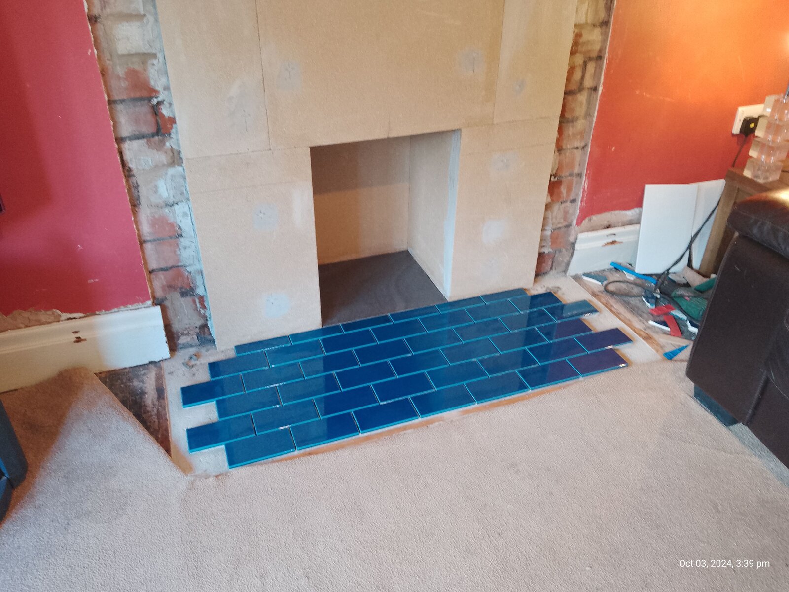

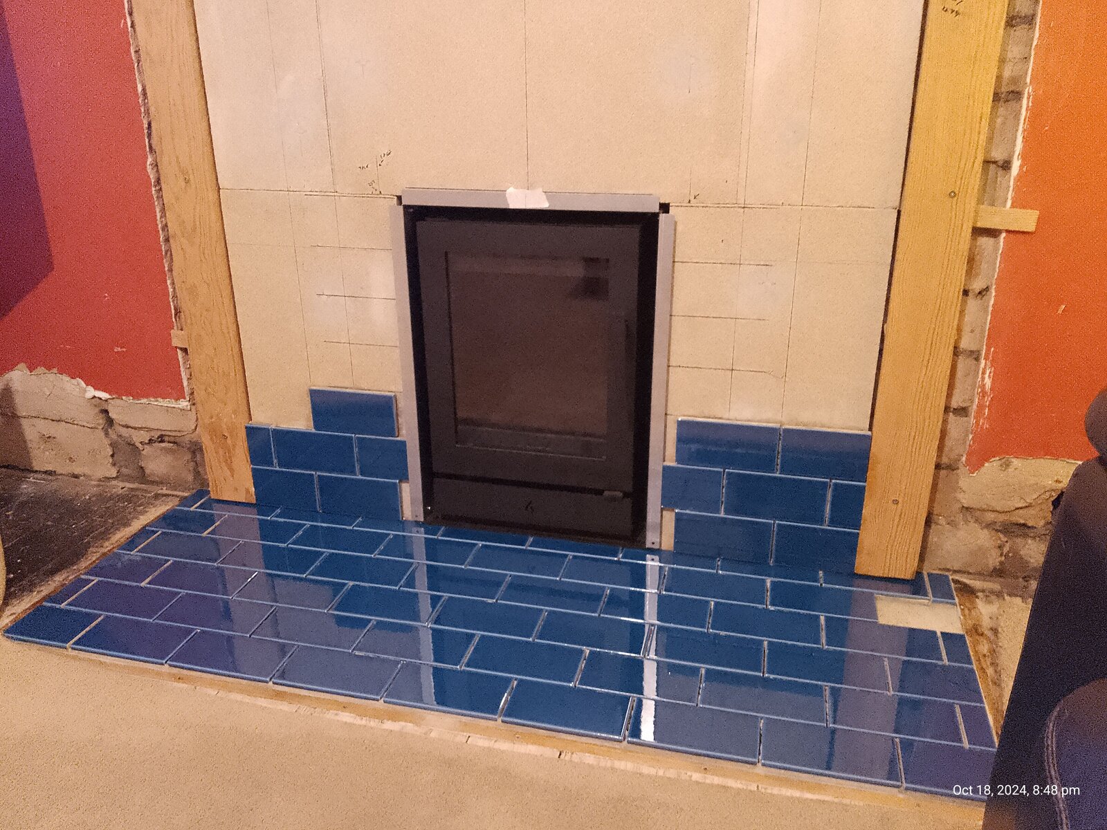

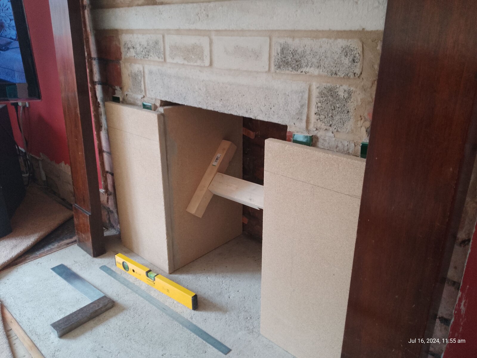

Just thought I'd do an update on my project. Slow going due to being a diy er and trying to fit things in when I can
