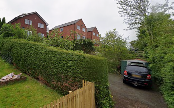

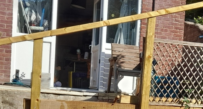

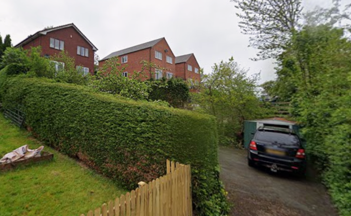

So looking for ideas. Inverter in the corner 1783845895774.png so we have a composite panel next to it. Behind the chair. Google Earth shows or rather does not show, 1783846341495.png how the flat is protected from the sun to some extent by trees, so we have time, is that the answer, a tree close to the flat so shaded more?
Looking for ideas, before we have to live in the flat.

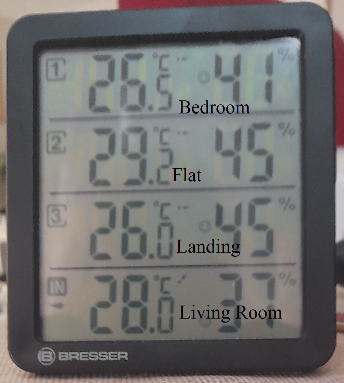

1783858093564.png So flat is the warmest area where I have thermometers. There are also thermostats, hall TRV 23°C wall thermostat 26°C living room TRVs 27°C and 25.1°C wall thermostat 27.5°C the dinning room TRV 21°C the rest are not readable online, so don't know the temperature, but flat is in spite of the door being left open the warmest place in the house, at 29.2°C.
However before solar, it was likely coolest group of rooms in the house. It would have been cooler than the dinning room, in the flats kitchen the inverter near the door, and the thermostat is at the back of the kitchen, mainly there so I can see when cool enough to start brewing again, which is why I know before solar, the flat would remain at 18°C or below so I could start a brew, if within first 5 days the brew goes above 20°C it can result in a bitter after-taste, so brewing stops this time of the year.
Had it not been for the brewing, I would be unaware of temperatures on previous years. The solar installers wanted to fit the inverter and batteries in the loft, thank goodness I didn't let them do that.
I know the flat ceiling has loads of insulation so no too much heat raises to living room, but some must of course.

So looking for ideas. Inverter in the corner View attachment 418221 so we have a composite panel next to it. Behind the chair. Google Earth shows or rather does not show, View attachment 418222 how the flat is protected fnf online from the sun to some extent by trees, so we have time, is that the answer, a tree close to the flat so shaded more?

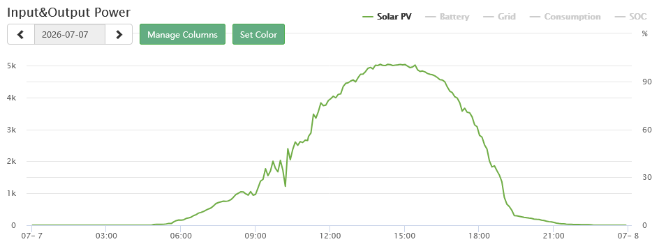

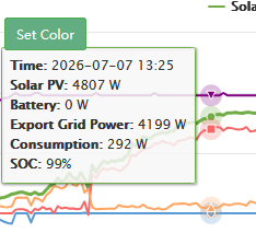

The inverter is 5 kW, the panels 6 kW, it was assumed it would be rare to have maximum output from panels, so 5 kW is enough for the inverter, and that does seem correct.

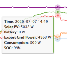

39 kWh on 7th July 2026 is the best so far, I expected more near the solus, but the panels are on a south-west roof. The graph on the 7th 1784189049630.pngdoes not show a flat top, so it seems the inverter was big enough. Peak was after true midday 1784189292959.png1784189365418.png around 13:35 real time, where I am, again likely due to panels not being due south. By 7:30 pm solar was near enough gone, there was a little until 10:30 pm, but such a small amount, could be counted as zero.
