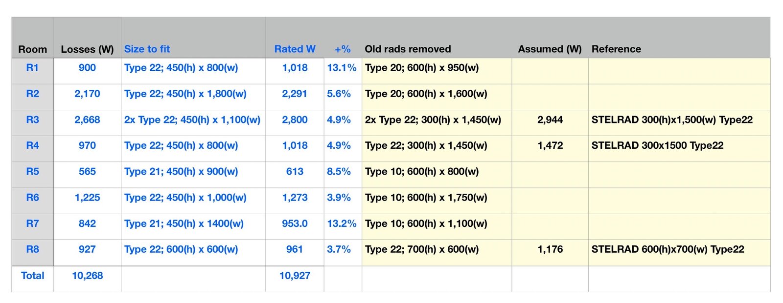

Thanks to advice gratefully received, I’ve generated my radiator shopping list (from U values / areas etc and no Apps).
I wanted to check against rads that came out (sensible advice from @oldbuffer) that I’m in the right ball-park.
I get the feeling the new rads are a tad larger capacity wise.
Trouble is, they are quite old rads and I can’t seem to find equivalent listing on line.
The type 22s I’ve found similar on stelrad site (their K2 listings).
But the type 10s (single panel no fins) and type 20 (double panels no fins) don’t seem at all popular.
Grateful if someone would give me a steer as to where I might find W/BTU values.
Or if someone experienced might suggest a rule of thumb value.
Thanks D

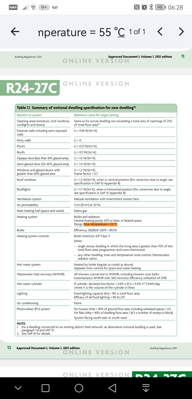

Size the radiators for a DT30 rather than DT50
Replacing all rads or installing new system then they have to be sized for low temperature heating to meet building regs.
Max flow temp of 55°C

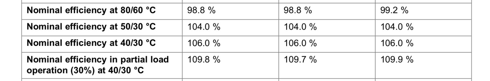

It’s not only heat pumps that benefit from larger rads; condensing boilers only actually condense when they operate at lower temperatures than older boilers did.
Here are your boiler’s efficiency numbers for different temperatures:
Note that the greater-than-100% efficiencies are because “100% efficient” is based on the best that a non-condensing boiler can do, i.e. steam coming out of the flue. A condensing boiler also recovers the latent heat of the steam and produces liquid condensate water.
Now we have to avoid the confusion of “delta T between rad and room” and “delta T between flow and return” at this point. I think - and maybe someone can confirm - that when you say “T 50” that means “room is 20 C and average rad surface is 20 + 50 = 70 C = mean of flow and return”, which is 80/60 in the table. And “T 30” means “room is 20 C and average rad surface is 20 + 30 = 50 C = mean of flow and return”, which is not even as good as the second row of the table. To have your boiler running as efficiently as possible - which will be 10% cheaper than you are currently proposing - you need even larger rads.

if I understand correctly - there is an opportunity here to make the boiler upto 10% more efficient by lowering the flow/return temps.
Consequently, I’d need physically larger rads to still get the same / required Watts.

If I’m calculating correctly……….
One of my rooms has two rads set against requirement of 2,668W.
My plan was (reading off the DT50 75/65/20 degC Table) 2x 1,400W Type 22; 450(h) x 1,100(w) = 2,800W (I can’t go taller than 450mm).
Factored for DT30; the I’d need the equivalent of 5,202W (reading off the same DT50 75/65/20 degC Table).
The 450(h) Type 22 rads max out at 1,800(w) = 2,291W (so 4,5682W for two but still 620W short of what I’d need).
I like the efficiency angle but the practicalities might be challenging.
This kinda suggests that DT30 will broadly double my rad sizes ?
D
