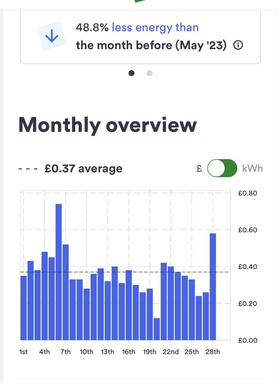

Two of us in the house, gas hob for cooking, numerous hot water hand washing throughout the day, both of us have a shower every night, occasional baths. Hot water is on 24/7. When the heating is not used, we average 37p a day gas usage so personally, I CBA with switching the hot water on and off or even putting it on a timer. I might come home from work or the allotment in the middle of the day and want to jump straight in the shower so it’s nice to know I always have a cylinder full of hot water at any time of the day.

Two of us in the house, gas hob for cooking, numerous hot water hand washing throughout the day, both of us have a shower every night, occasional baths. Hot water is on 24/7. When the heating is not used, we average 37p a day gas usage so personally, I CBA with switching hot water on and off.
