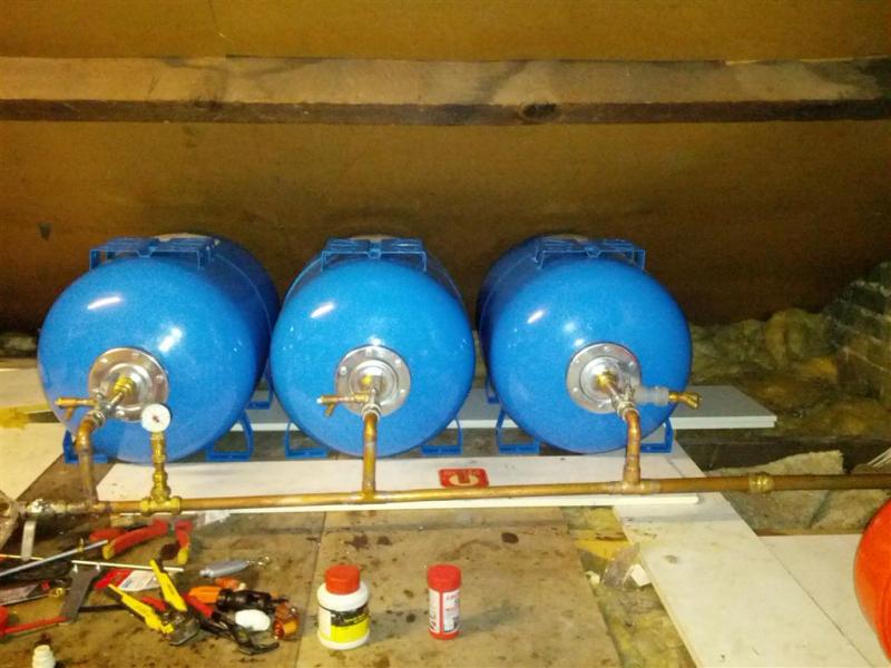

The other three all suffer from a common limitation - no stored water, so you are reliant on what pressure/flow the mains can provide (with the addendum that you can fit accumulators as mentioned earlier).
