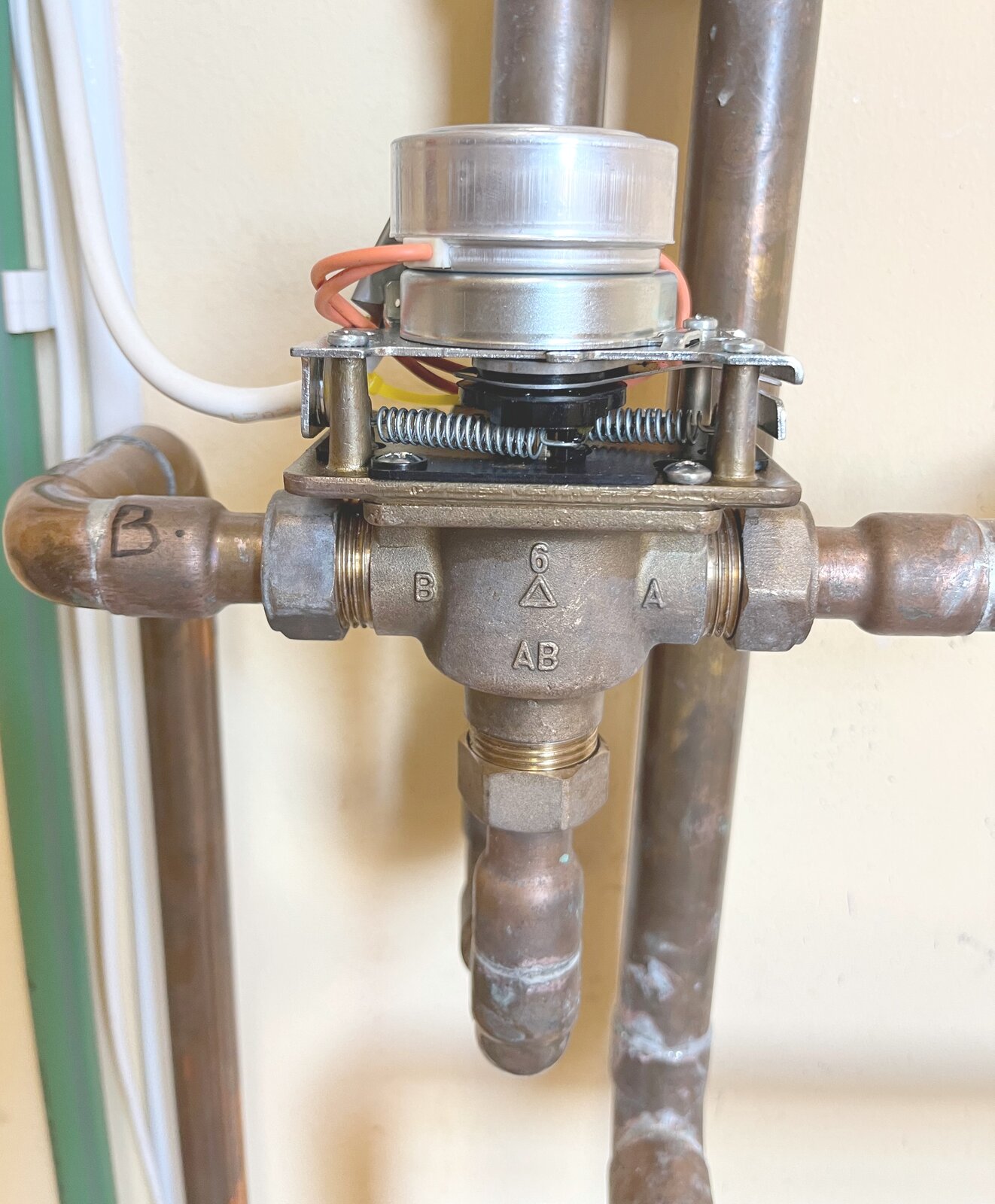

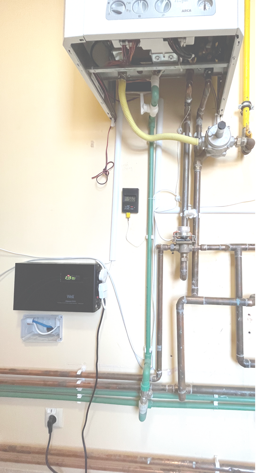

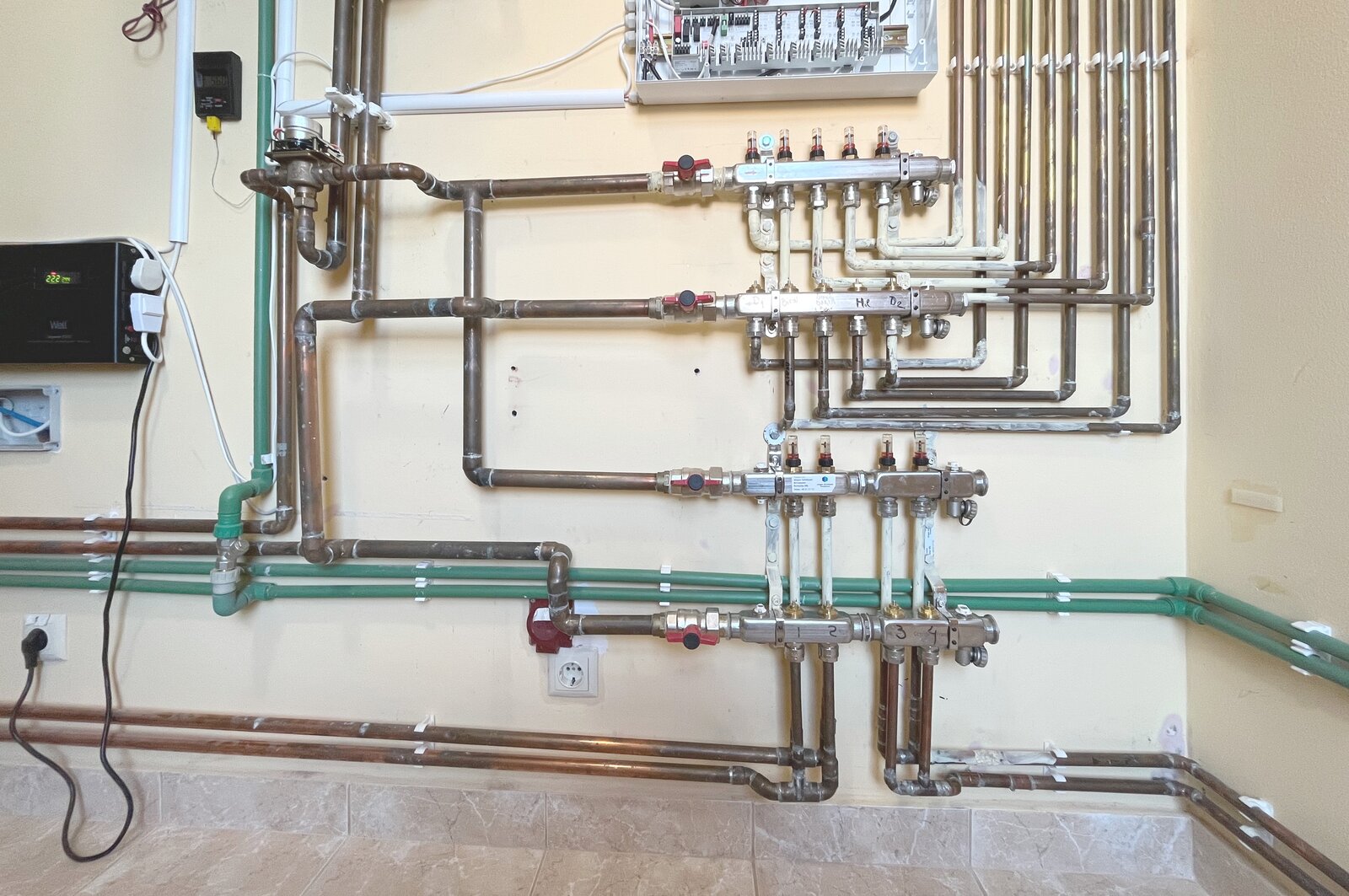

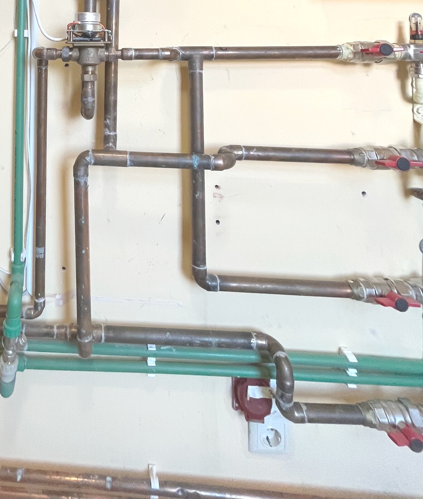

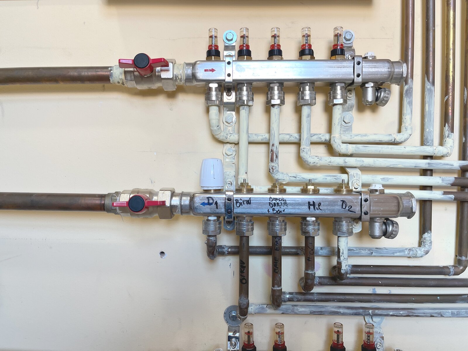

Two years ago, a forced draft Arca Ecofat 32 FR boiler was installed (heating only), with a 3-way servo-motorized valve and a 150l external Vaillant boiler. Central heating circuit settings: 56 degrees and 1.3 bars. There are also 2 radiator distributors from Jurgen Schlosser Armaturen installed, 1 with 2 ways (ground floor) and another with 5 (first floor); on the flow there are flow meters now all set to 1 l/min, and on the return there are valves with actuators (the actuators have not been installed yet). Heating was wanted in zones/rooms - the radiators in the upstairs bathroom and the upstairs hallway will be permanently open, plus 2 radiators on the ground floor (kitchen and hallway) - so a bypass for the distributors was not installed. The pump in the boiler is a classic one (CIRCOLATORE 6M ATTACCO 1" MONO) and it has been running for 2 years on the whole system. I don't know what problems there will be when I install the actuators, the room thermostats and the control unit, all Jurgen Schlosser Armaturen Blue Line.

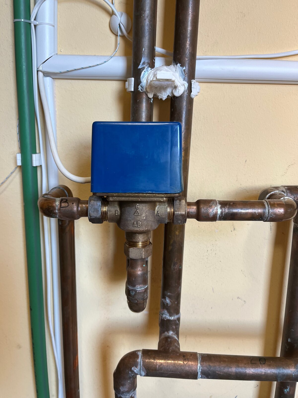

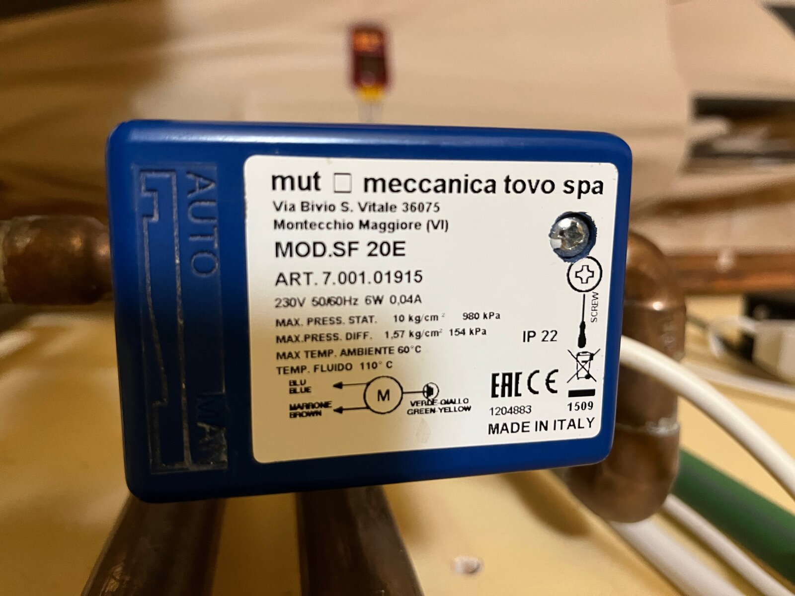

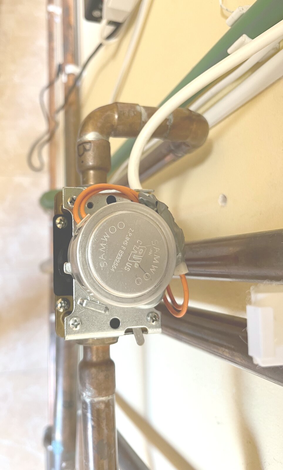

On the ground floor there is a circuit with 5 radiators "in series" (living room) - the first of them, the one next to the technical room, has now started to make a regular rattling noise, after the boiler is switched on to heating, which lasts about 2 minutes. At the same time, when switching to heating, the 3-way valve seems to sometimes make a louder or less loud "clacking" type noise ( clank ), with vibration in the flow pipe that goes from the boiler to the radiator distributors. The (external) 3-way valve probably needs to be changed immediately. I have bled all the radiators - many "beads" (like in a water pipe :)) in the container where I took a little water from the air vent. I should mention that the distributors do not automatic air vents were installed, but classic ones, like on radiators.
I am attaching some pictures. Any suggestions for improving the heating "system" are very welcome. THANK YOU!
