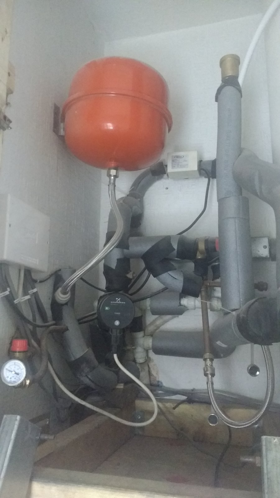

Thanks for your assistance (although I don't think I'm fully understanding the discussion), if it makes a difference the vessel is at the highest point of the system (along with an aav on the cylinder return).
I've pressed the valve on the top of the vessel and for what it's worth air hissed out. When I get chance I will drain the vessel and check the air pressure.
My own simplistic "logic” for thinking that the air pressure in the vessel should be slightly higher than the (cold) system pressure was that otherwise the water will compress all the air and there won't be any capacity left for when the water gets hot. However, what I think you're saying is that when the water is cold it should be partially compressing the air so there's a bit of ”spare” water in the system but still room for expansion when hot. In my case a small water loss is resulting in a large pressure loss.
Sooo - if I try the air at 0.8 and the water at 1 it should (till the remaining older and suspect parts of the system are replaced) take longer for the little bit of water loss to affect the system pressure?
It loses about a quarter of its 1 bar pressure over a few weeks. Only needs.a one second burst from the filling loop to bring back to 1 bar so not much loss. No visible leaks. It's ex open vented, now sealed, with a megaflo. Rads and pipework are a mix of new rads with new plastic pipework and 40 year old copper pipe and rads. I am repiping and replacing the old stuff as I work round the house but in the meantime is it likely that I'm losing a bit from the old parts and it's evaporating off?
FFs hope the remainder of the installation is better,even a maze is designed better View attachment 134022
Hi and thanks for your advice. I'm sorry if my posts come across as lacking in manners. Unfortunately as I'm not particularly knowledgeable in this subject area even writing the basic details of my problem seem to result in quite lengthy posts so I have tried not to make them worse by filling them with platitudes, but this does not mean I am not extremely grateful for any advice from members of the forum.
Regarding the ”maze”, it honestly doesn't look as bad in the flesh, or didn't until I put all the insulation on it, and it is all squashed into a very small space.
