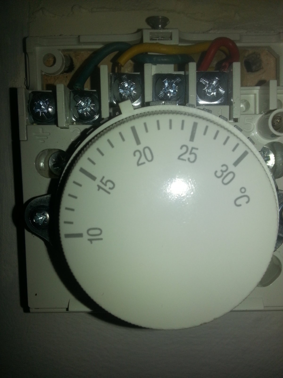

Hi can anyone help my heating system is giving me hot water but no heat.have checked the 2way moterised valve which is not opening. But will open manually and give me heat.suspected faulty thermostat. Bought new one but before conectig up had wires loose and checked for power the three wires red blue yellow .not showing live when programer off.but when calling for heat the red a yellow are showing live.if the blue is neutral I thought one of red or yellow would be switched live and become live when thermostat is wired up and calling for heat.or have I got that totally wrong. I want to make sure I have it wired correctly before I move on to checking if moterised valve is faulty ..any help much appreciated Stuart

Photos world help of the thermostat, valve and associated wiring entering them.
How are you testing for live? If it's a one contact screwdriver they just light up for anything with a potential, even earth. You should have an earth at every termination point. You need a proper two pole tester eg multimeter. Make sure the leads are CATIII rated and all potentially live terminals are shrouded before starting your tests.

To answer your question, if it's a standard thermostat you can just bypass it. But start by understanding how it used to work. And photos would still help. No idea what a flute tester is, photos would help of that too.
Hi john wired it up to honeywell directions it is a T6360 thermostat .when I turn dial it clicks and light comes on at 20 degrees.suggesting wired right.but does not open moterised valve . Just wanted to try bypass just as a double check
It's hard to advise what procedure to follow without photos to be honest. You need to follow fault finding procedures to isolate the problem then change the offending part.
Hi john trying to load pics see If this worksI
