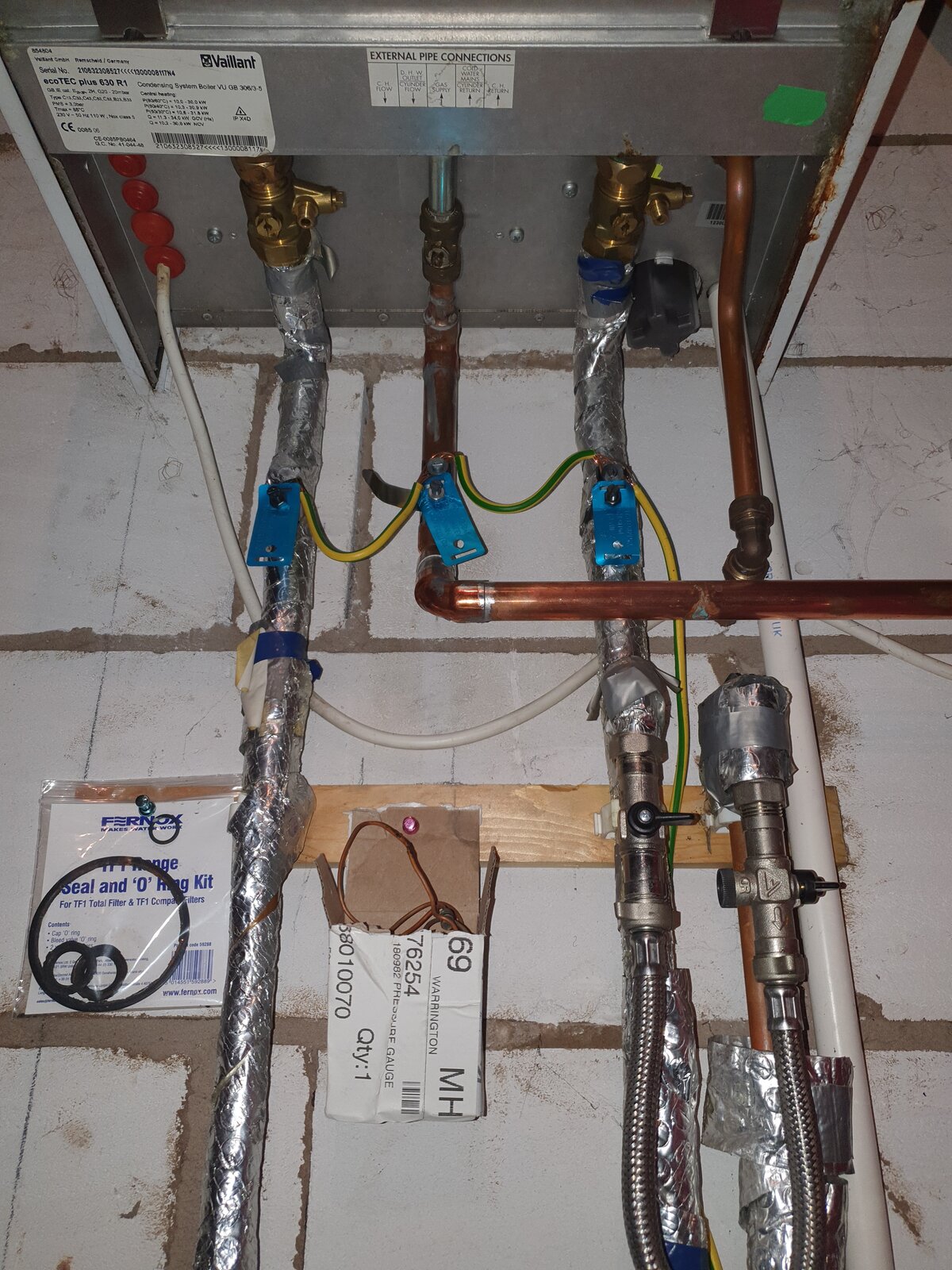

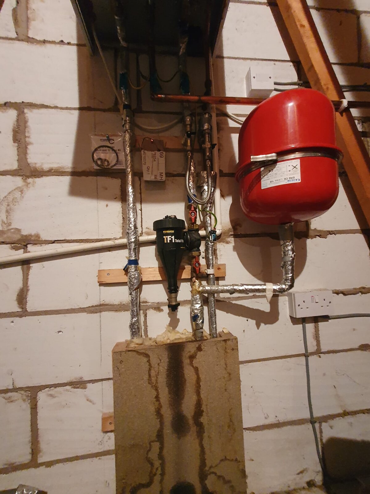

Hi,
My central heating stopped working, recently after the wife turned the heating on whilst the mains water was off :-(.
The boiler displays an F22 fault code (low water pressure) and the pressure is at 0.1 bar at the moment. I've had a check and it looks like there's a leak from the Fernox filter (a Fernox TF1 Total Filter).
Is it wise to isolate the fernox filter, clean it out and then re-pressure the valiant boiler?
I've turned off the valves to the Fernox filter in the meantime.
Advice much appreciated.
Thanks,
pics below
Hi the valves are not off in the photo. Looks like you have a spare washer set on the left change these then repressurise to 1 bar
Thanks, I've taken the top off, replaced the o-ring, but it still leaked, so I've added the original and new ring - a little better, but stil a small leak.
I've found the video below and am considering replacing the unit
Although I'm not sure it's worth my effort and whether I'd be better off just paying a plumber to sort it...
