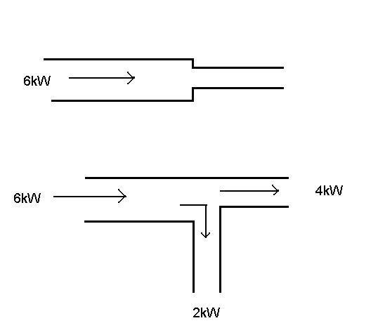

Pray explain how you don't suddenly go from 22mm to 15mm ? is there some magical fitting that does this gradually ?
I was talking about the OP's particular situation where the suggestion had been made that the pipe from boiler to the rads could be upgraded from 15mm to 22mm for the part which was accessible (The yellow bit in the OP's diagam). In this case the flow rate will be constant, but the velocity will increase when the pipe changes from 22mm to 15mm.
A change of size would normally only take place at a T-junction where part of the flow was being diverted to a radiator, so the flow rate leaving the junction is less than the flow rate entering.
Compare these two diagrams.
That is the situation that would occur.
Would this be a significant issue? Is it going to cause excessive noise as the water gets funneled / increases velocity? Any other reasons not to do it?
What I then see is that the flow rate (and thus velocity) would be increased in the remaining 15mm section, and I fear this may introduce a noise.
The flow rate, i.e. volume of water stays the same; it's only the velocity which increases when you change from 22mm to 15mm.
