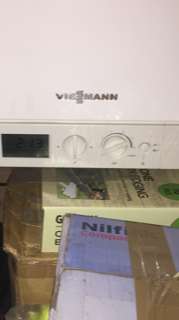

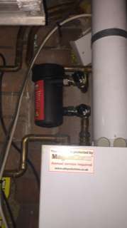

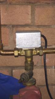

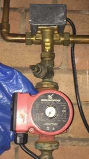

When we turn thermostadt up heating comes on but when we lower the thermostadt even to 0 the heating stays on, even if we turn the timer off. Only way to reset it is to go to the boiler and turn it off and then back on, that's fine until we higher the heating again then the same thing happens.
Had a heating engineer out last year and he said it was the wiring and it seemed to sort it but its doing it again now. if nothing has been renewed why would the wiring suddenly start to play up?
Veissman boiler
Sunvic timer
Honeywell Thermostadt
Hot water cylinder: YES
2 port valve Don't know I think so is there such a thing as 3 port valve ?
Hope this helps

you have a 3 port valve or Y plan system if you want to give it the correct name, sounds like it is faulty but could be other things
yes but could be other things , needs testing properly
Cheers, we have had 2 so called heating engineers out last year, one said he had no idea why it wasn't working properly the other said it was electrical and spent hours doing something with the wiring which we thought had fixed it but obviously not. :(
It is important that you only do this if you have a multimeter; know how to use it properly and can carry out this test safely. If not, don't proceed and engage the services of someone competent to fault find for you.
1) Set the room thermostat to be 'off' and reset the system as you describe below:
2) If the boiler is hot, wait a few minutes for it to cool slightly, and then turn 'off' the power supply to the entire heating system at the fused spur.
3) Follow the black lead from the motorised valve to the junction box / wiring center that it is connected to. Note where the white wire at the end of the back lead is connected and remove it from the terminal making sure other wires in the same terminal remain securely in place. The white wire shouldn't become live during the test, but move it safely out of harms way, just in case.
4) Turn 'on' the power supply to the entire heating system at the fused spur.
5) Measure the voltage between the terminal where the white wire used to be connected and a known neutral it should be a low value 0v or thereabouts.
6) With the heating timer set to be 'on', now turn up the thermostat to initiate the heating, and measure the voltage again. It should now be 230v or thereabouts. (the heating shouldn't come on with the white wire disconnected)
7) Turn the thermostat down so that the heating would be off and measure the voltage. It should have returned to 0v.
If what I describe above is what happens, then the thermostat is wired in correctly and appears to be working as it should. If, when you carry out step 7, the voltage remains at 230V then there is a problem with the wiring or the thermostat, if not the problem is elsewhere.
