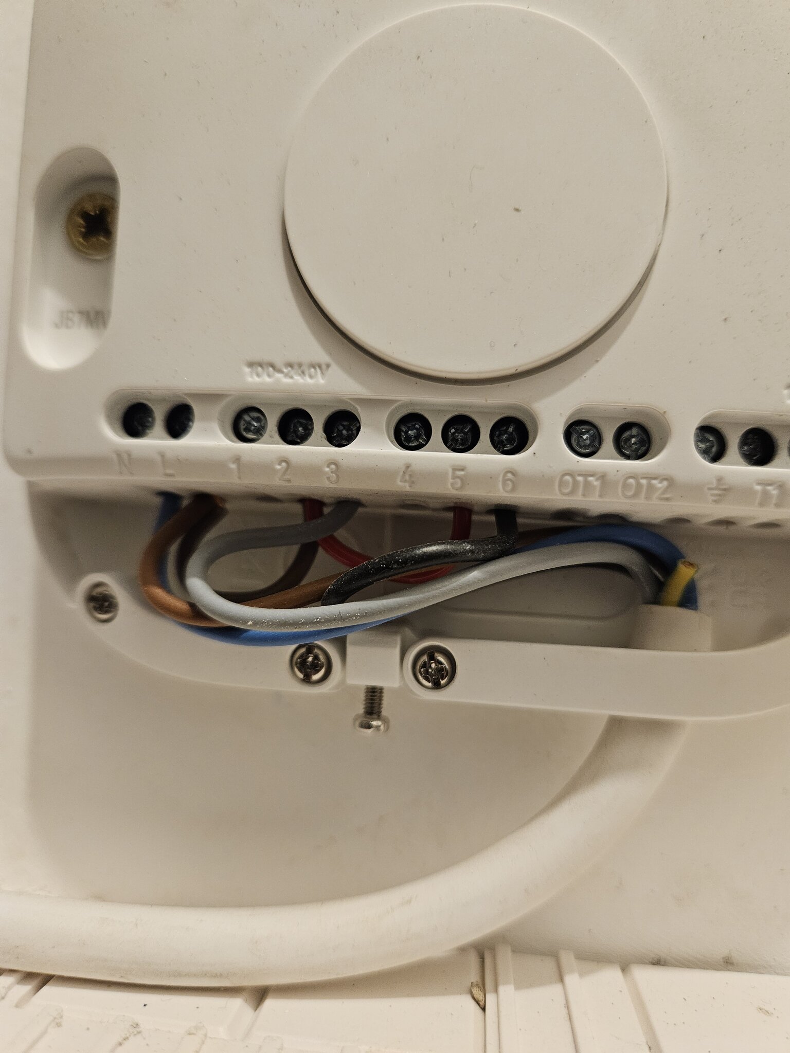

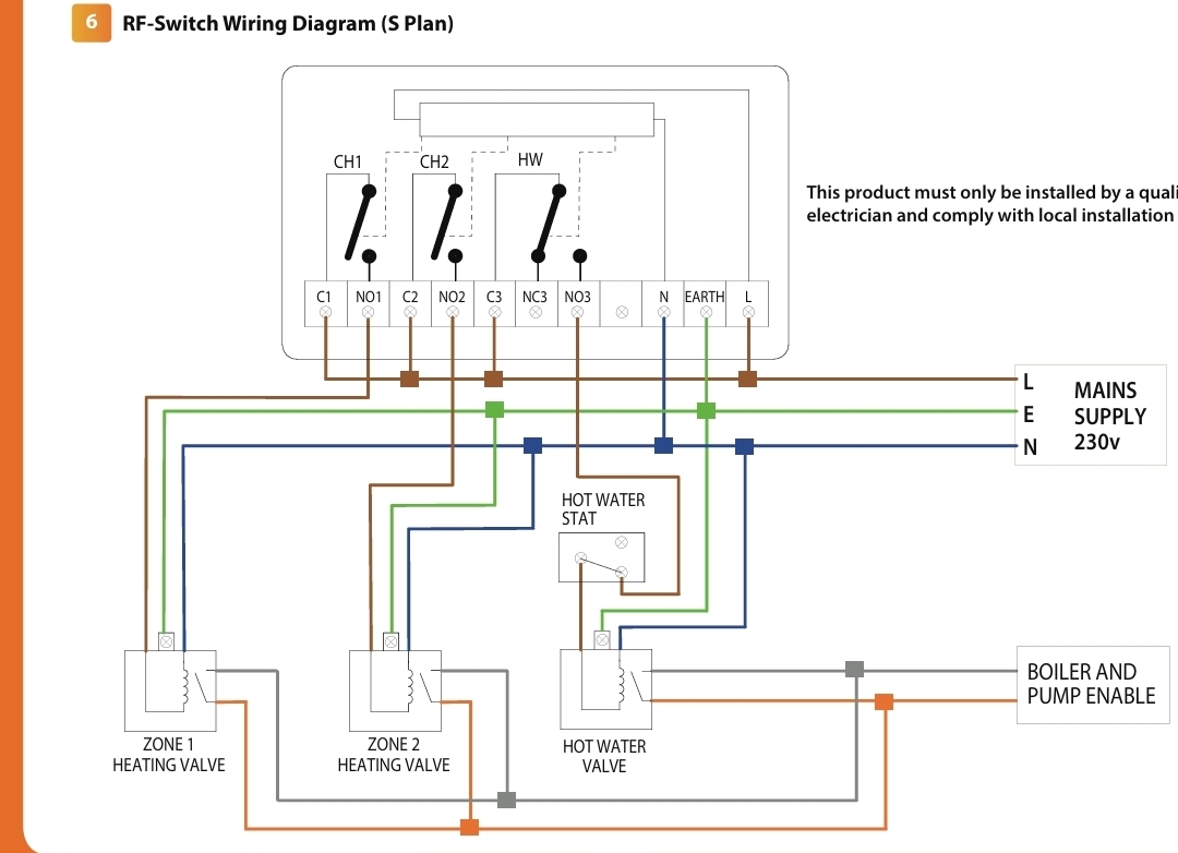

Heatmiser rf switch v2 receiver wiring
10 Oct 2026
6
Switching from nest heatlink
Would this be correct for the heatmiser

NEST RF SWITCH V2
N (blue) → N
L (brown) → L
2 (CH) → C1
3 (grey) → NO1
5 (HW) → C3
6 (black) → NO3
LIVE LINKS:
Nest: L → 2 → 5
New: L → C1 → C3
CH2 unused
The ufh stats are wired directly to the uh4 so the rf switch just controls the heating and HW cylinder
