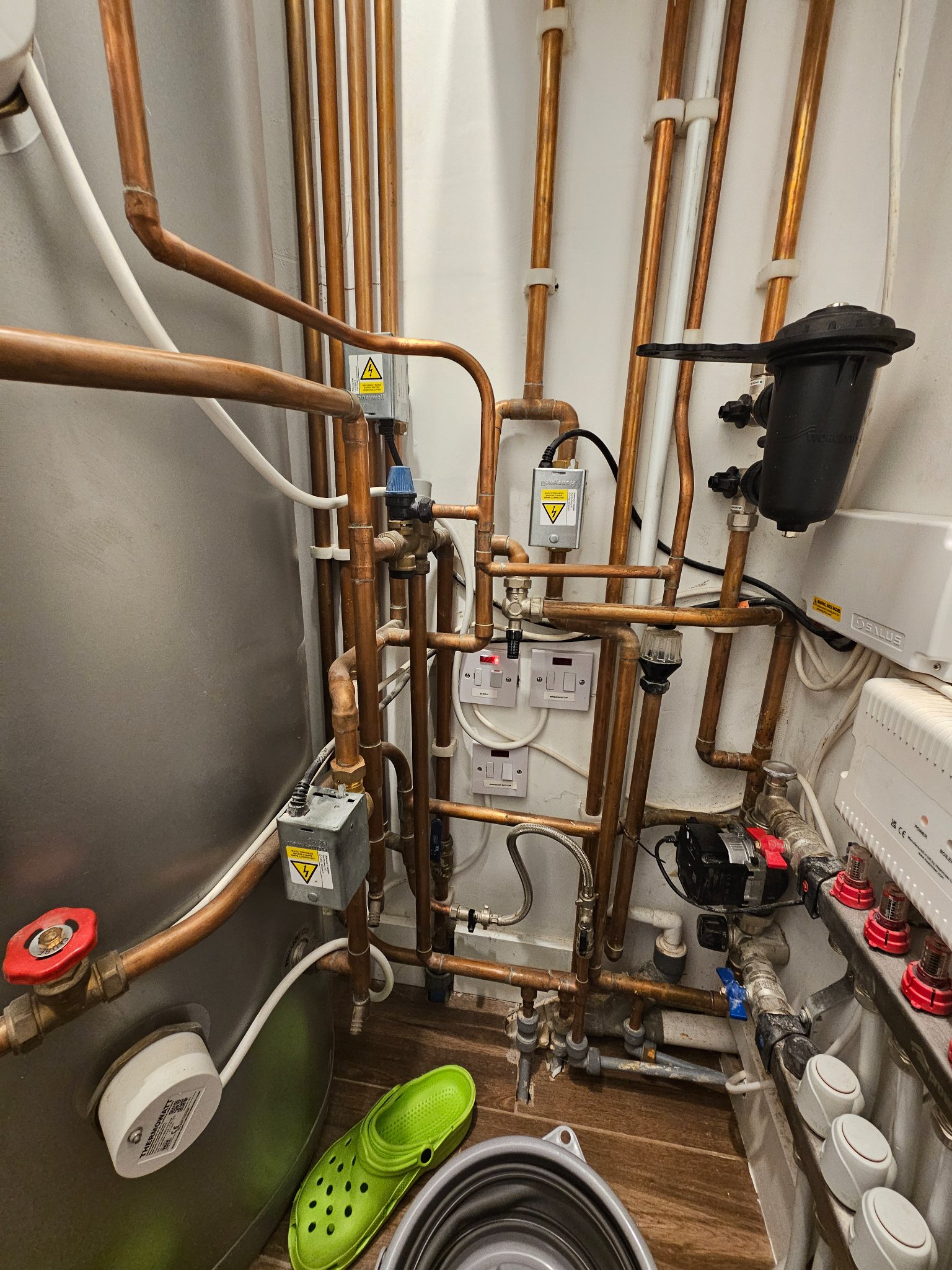

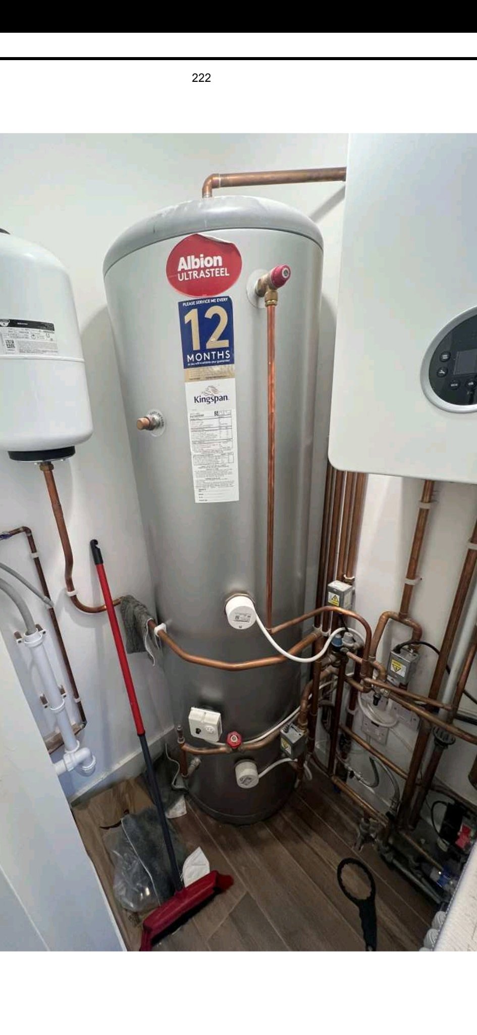

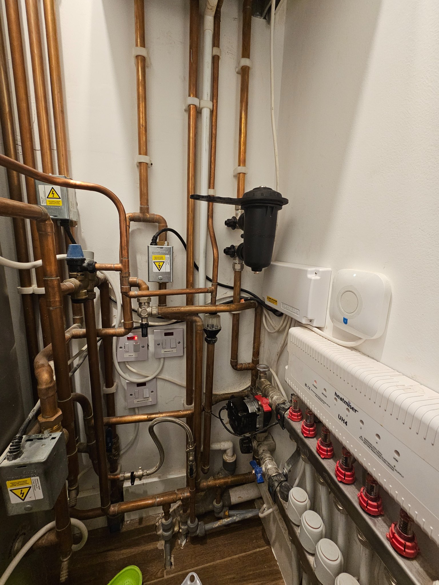

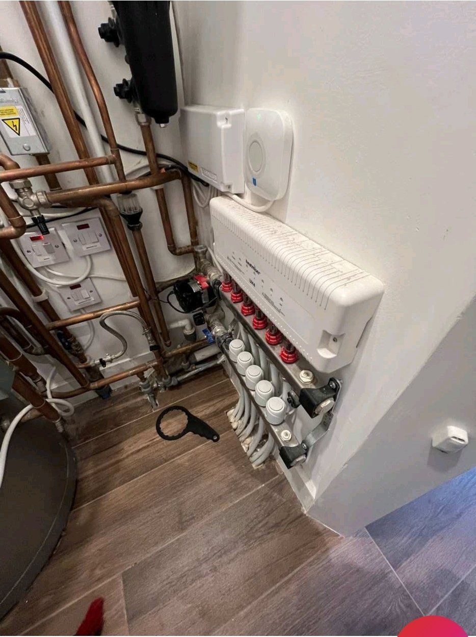

In my property we have a Worcester bosch 8000 life system boiler and kingspan Albion 300l unvented cylinder.
We have a two zone ufh heating downstairs. 2 neostats v2 wired to a ufh4 and a neohub gen 3 so I can control via the app.
We also have a nest heatlink and wireless plug in Gem 3 thermostat. The nest controls my central heating and my hot water heating for the unvented cylinder.
Both systems work independently. Eg I can turn on only my ufh heating from via the neo app. Or I can turn on just the hot water from Google home or the ch. Or both. Or turn all 3 on via the two apps

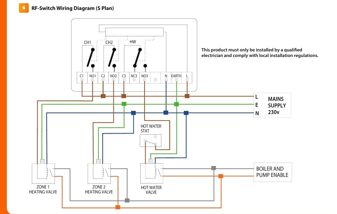

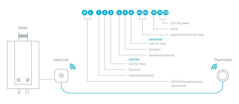

This all works fine but I want to switch to a single heatmiser solution. I've been told I need to replace the heatlink with an rf switch v2 and the thermostat with a neo air v3. Is this the best solution or is there a better one?
If it is the best solution should it be completely straightforward process for any heating engineer to take the wires out the heatlink and put them in the corresponding terminals of the rf switch v2 or does some extra things need doing?

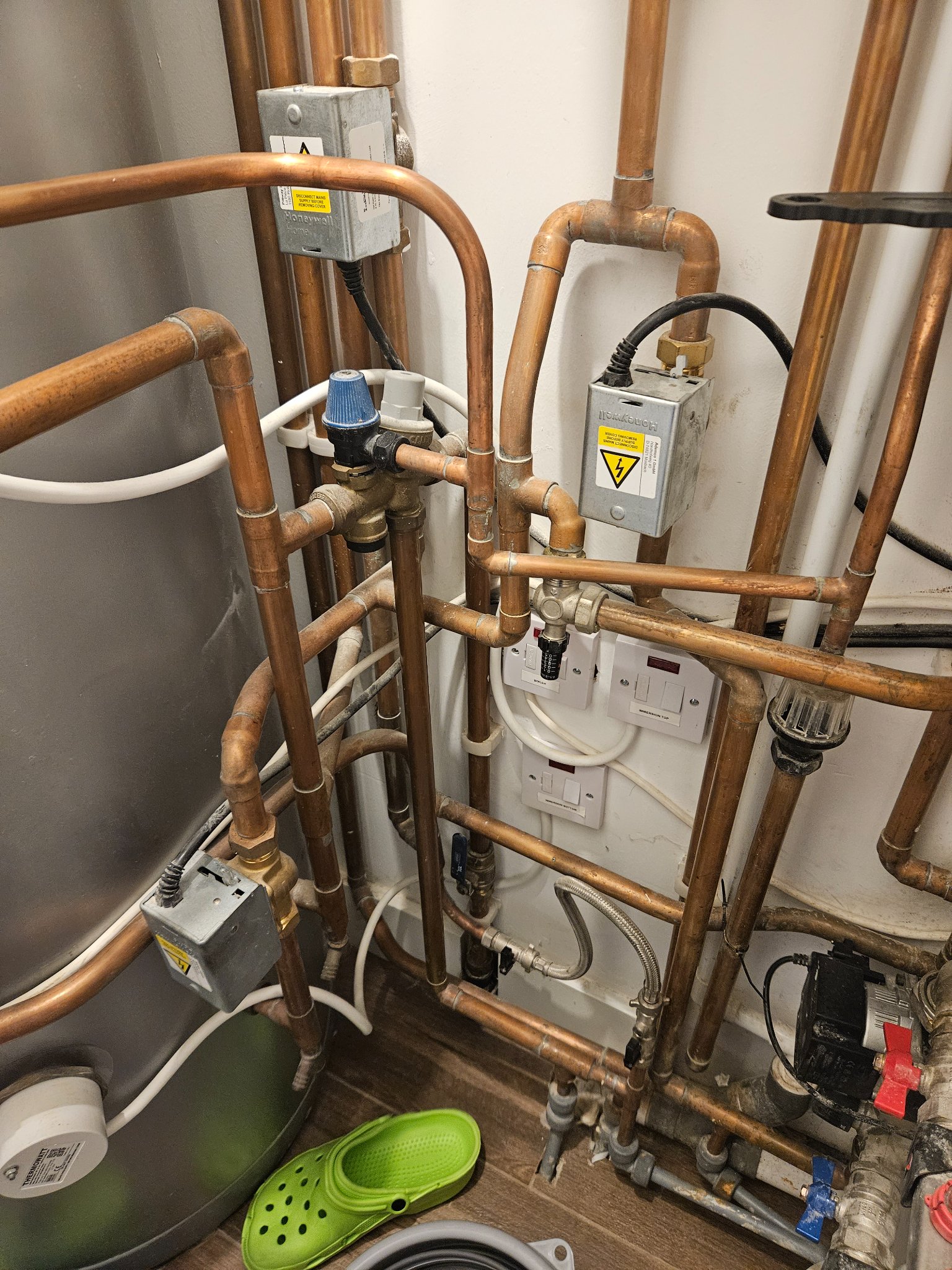

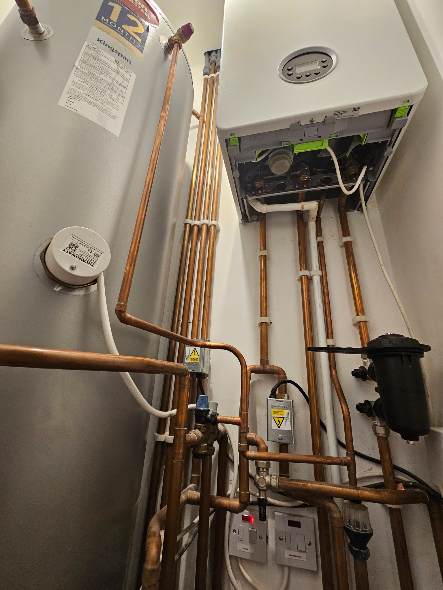

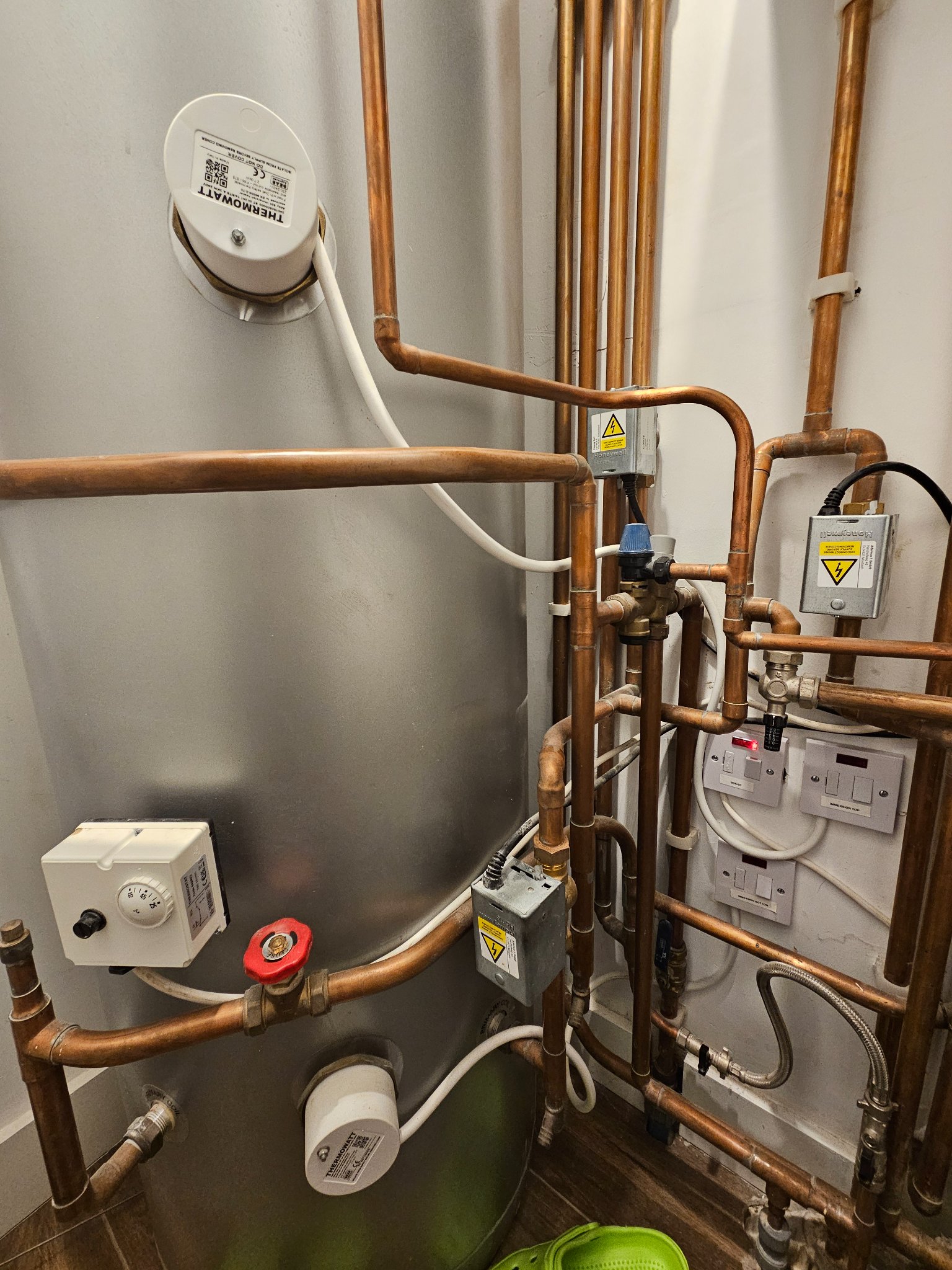

It seems the best solution, as I think what you have is Heatmiser for ufh, and I only see 3 zone valves, so can't see one for the ufh - or is that from one zone and the other controls the house?
There are three Honeywell motorised valves.

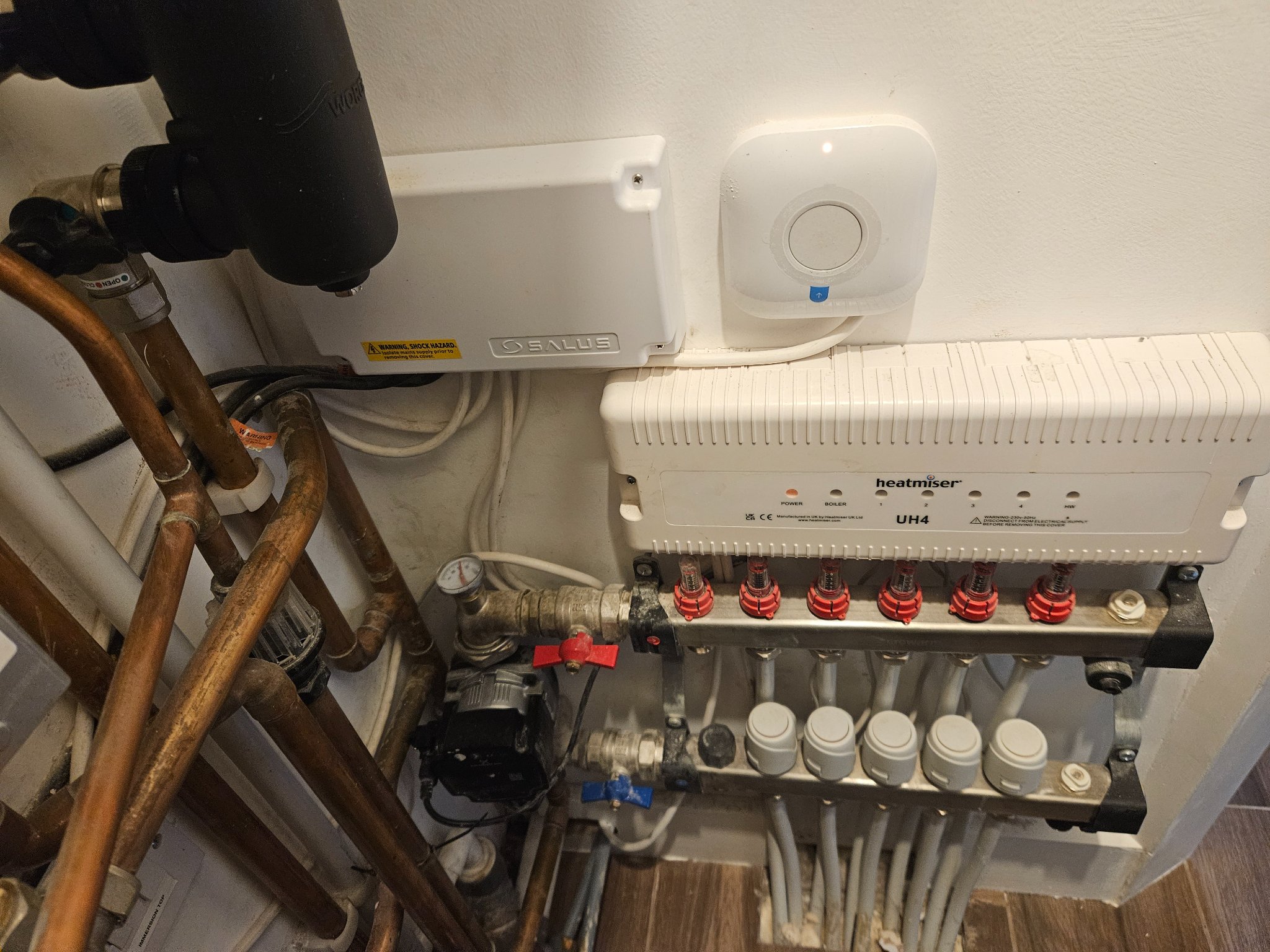

I have two independent UFH zones, but both are supplied through the same UFH manifold, which has its own circulation pump, mixing valve and individual thermal actuators controlled by a Heatmiser UH4.
My understanding is that the three Honeywell valves serve the radiators, hot-water cylinder and UFH respectively, with the two UFH zones controlled separately at the manifold.
All three main circuits can independently call for heat from the boiler, so the system appears to be an S-plan-plus arrangement.
If that's the case and one of those Honeywells do control the UFH, then I suspect you can use whatever you want as long as it's a 3 channel type
