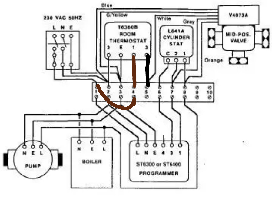

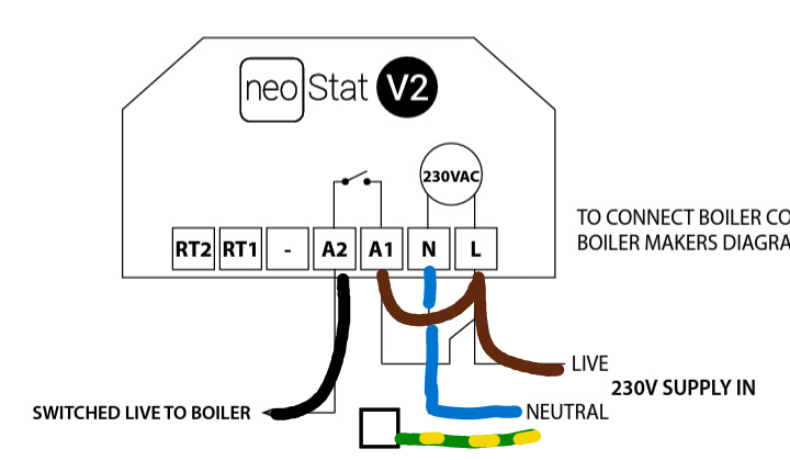

Taking the thermostat first, and assuming that you wish to mount the new stat where the old one is and reuse its wiring...
On the neoStat V2, connect:
Brown to L
Blue to N
Safely isolate the green/yellow earth wire in a separate terminal block (there doesn't appear to be an earth terminal on the neoStat)
Black to A2
And a link wire between L and A1
In the wiring centre, disconnect the wire from terminal 4 (probably, as we haven't seen inside your wiring centre yet!) going to the ST6400C (black wire?)
And replace it with a link wire between L (Terminal 1) and terminal 4.

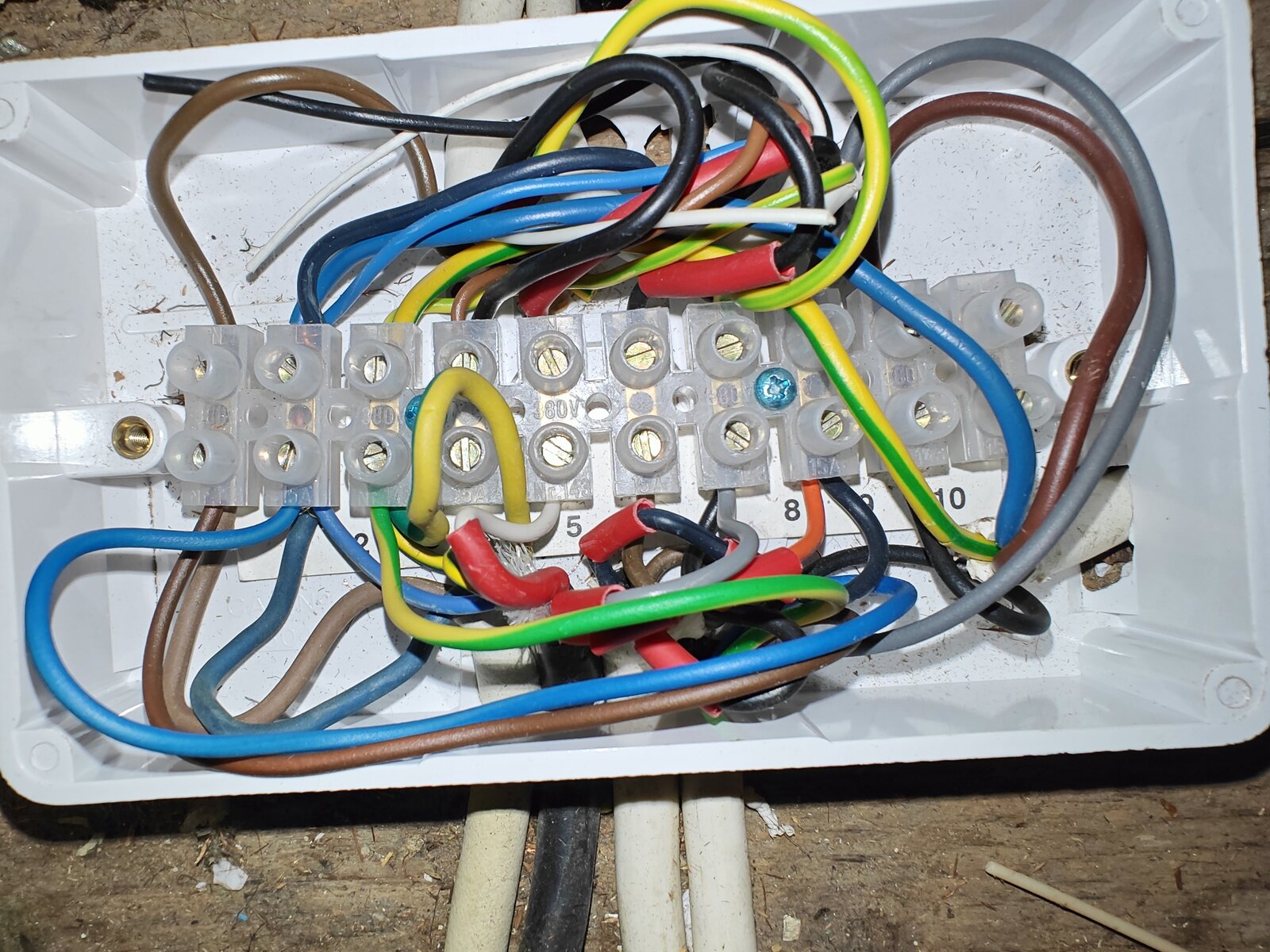

Attached is the picture of wiring center. It's in the loft so I can only make a good guess by looking at the wiring thickness that the room thermostat wire is slightly thinner than the others. Brown wire from Thermostat terminal 1 is already attached to terminal 4 in wiring center and black wire from thermostat terminal 3 is attached to wiring center terminal 5 as already shown in your diagram.
So does that mean only change in wiring centrr is to link terminal 1 with terminal 4 so it becomes permanent live?
