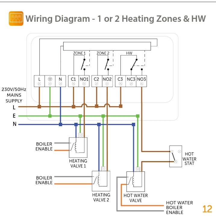

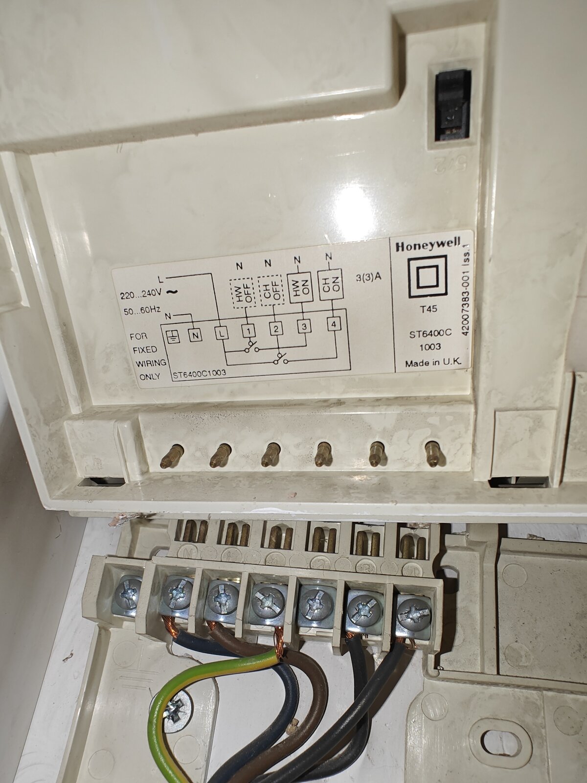

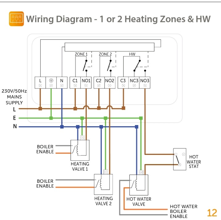

The Heatmiser Neohub Mini HW should be able to replace the ST6400C - if you are happy to take it off of the backplate, we should be able to confirm which wires you need to connect. It may look something like this:
As @CBW states above, some link wire will be needed on the Neohub to connect L to C1 and C3.

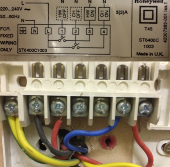

Just read your reply after posting mine. I am happy to leave old thermostat with turned to max settings. Attached is the picture of existing controller and neoHub Hw mini diagram. I have Y plan though instead of S plan shown in the neohub diagram but guess it won't make a difference.
It's now considered unaceptable to use a green/yellow wire for anything apart from an earth connection. Although the regs aren't retrospective, ideally you should have a five core + earth flex.
At the least, cover the green/yellow wire with brown sleeving.
Apart from that, I believe...
L to L
N to N
Link wire between L, C1 and C3
1 to NC3
3 to NO3
4 to NO1

It looks like the old controller doesn't have earth coming in so hopefully that's not a problem? I'll put brown or red tape on the green yellow cable to mark it appropriately. Anyhow, during renovation, all this will be replaced so hopefully they should follow the latest standard.

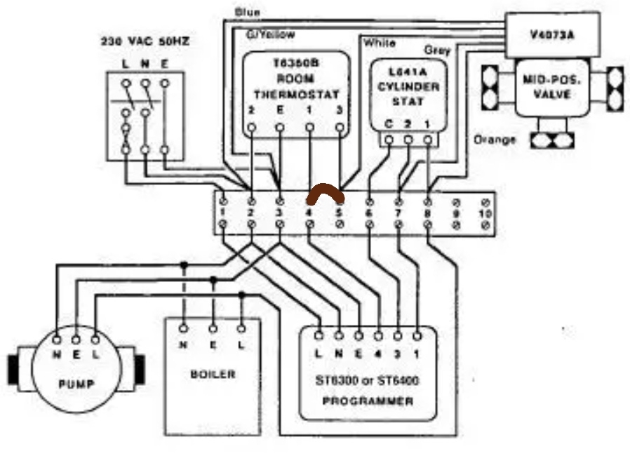

Just to confirm my understanding on "link cable between L, C1 and C3 means making a w type wire connection between these three points so they are like permanent live? (As shown with the red ink in the picture?
It shouldn't be a problem - the ST6400C is double insulated, and althought I can't confirm it from the internet, it is highly likely that the neoHub Mini will also be DI.
Brown please! ;)
Yes, exactly :)

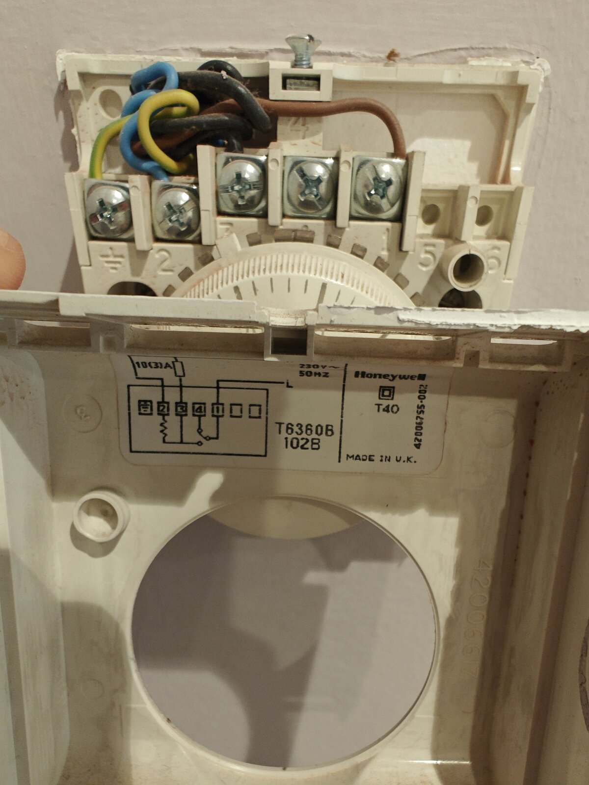

...and if you do have the confidence to delve into the wiring centre and have a go at permanently disconnecting the thermostat - Follow the switching wires from the stat (probably those connected to terminals 1 and 3) back to the wiring centre and simply link them out (probably terminals 4 and 5)..
Good luck! :)

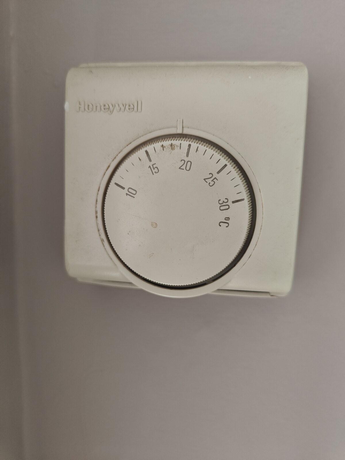

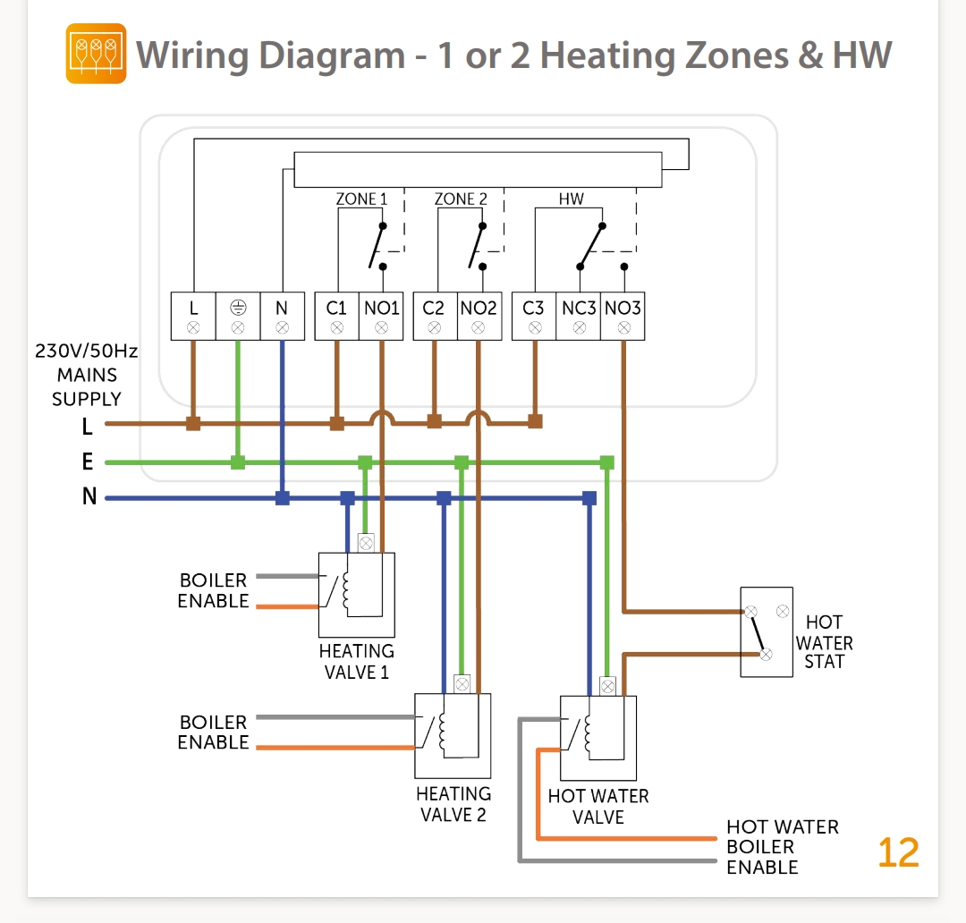

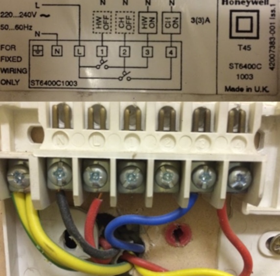

Attached are the pictures of existing honeywell timer and dial thermostat to control HW and CH. I am also attaching the wiring guide of NeoStat HW for 3 port valve. But looking at the attached pdf of CH thermostat, not sure which wiring diagram to use.
Any help is appreciated.
Existing controller picture
Existing thermostat wiring
Wiring diagram of new NeoStat HW controller for 3 port valve (and pdf)
