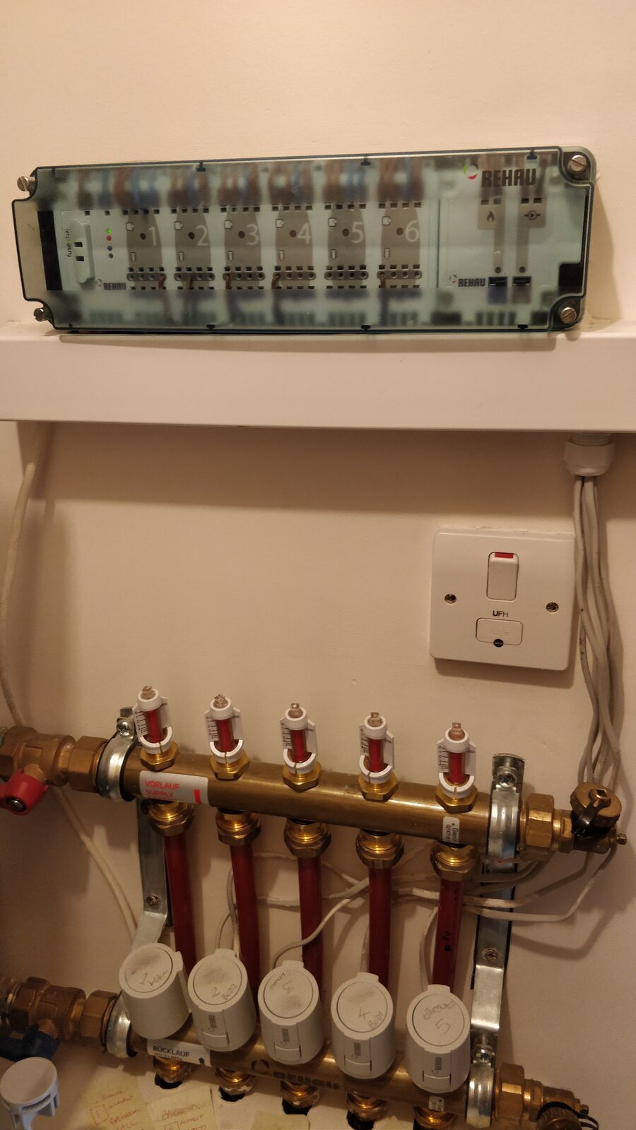

I have a property with wet underfloor heating, a REHAU system with 4 zones each with their own REHAU Star 20 thermostat. These are basic analogue dial thermostats. My intention is to upgrade these to digital thermostats with remote control, hence buying Heatmiser neoStat V2 controls. I have the hub also, but first things first.

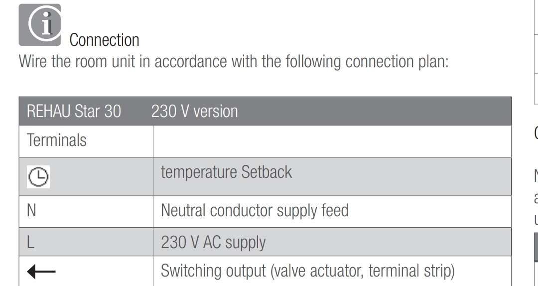

However, I am having trouble matching the wiring from the Star 20 to the neoStat V2. Please see these images for what I mean.
REHAU STAR 20 wiring:
Terminal explanation - this image is for Star 30 but it is the same for Star 20 also.

The wiring centre:

Adding, desired state is:
  1. The neoStat should work in a thermostatic mode (not time clock)
  2. I want to be able to set the target temperature on the neoStat to control this zone specifically. When the neoStat is calling for heat, I should see the corresponding actuator valve in the closet (wiring centre image) open up.

Have you actually opened the instructions included with the Neostat yet? It's all explained in there. L to L, N to N, A1 is input, A2 is output
Thanks muggles, I must admit I was confused by the 4 different wiring options included in their instructions. I’m also not totally confident interpreting the wiring diagrams.
L to L, and N to N is fairly obvious admittedly.
But, I’m still unsure how I map from the Star 20 to the neoStat the arrow terminal (switching output to valve) and the clock terminal (temperature setback). Which one of these goes to A1 and A2?
