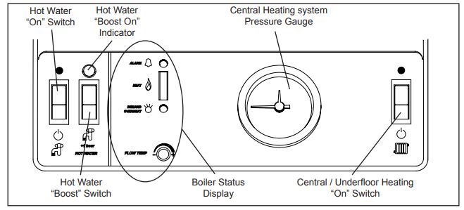

can you advise how you can set a timer etc so that the water can come on at say 6-8am then say 4-6pm as currently its just on all the time.
Hence why a 1/4 electric bill was £1600
Looking at the photo i have been sent i dont see how to do it ?
There must be a way than turning it on/off manually each time,i mean i cant get up 1 hour before i want to have a shower in the morning etc.

There is no time control per-se for the hot water. The idea is that it heats up a store of hot water using off peak electricity which is about one third the cost of normal electricity
The boiler should be wired into an off peak supply which will heat up a full tank of water when the cheaper electricity is available. To do this, the 'hot water on switch' should be left 'on' and it will store as much as it can during the off peak tariff, which should last all day (usually overnight, sometimes with an afternoon boost, depending on your electricity supplier and tariff)
Should you run out of hot water during the day when the off peak rate is not available, you can switch on the boost switch during the day. But you will be paying three times more for the electricity it uses.

The hot water on switch,would that be the the first item on the left which is shown green in the photo supplied above.
It would, see below for details of your control panel.
