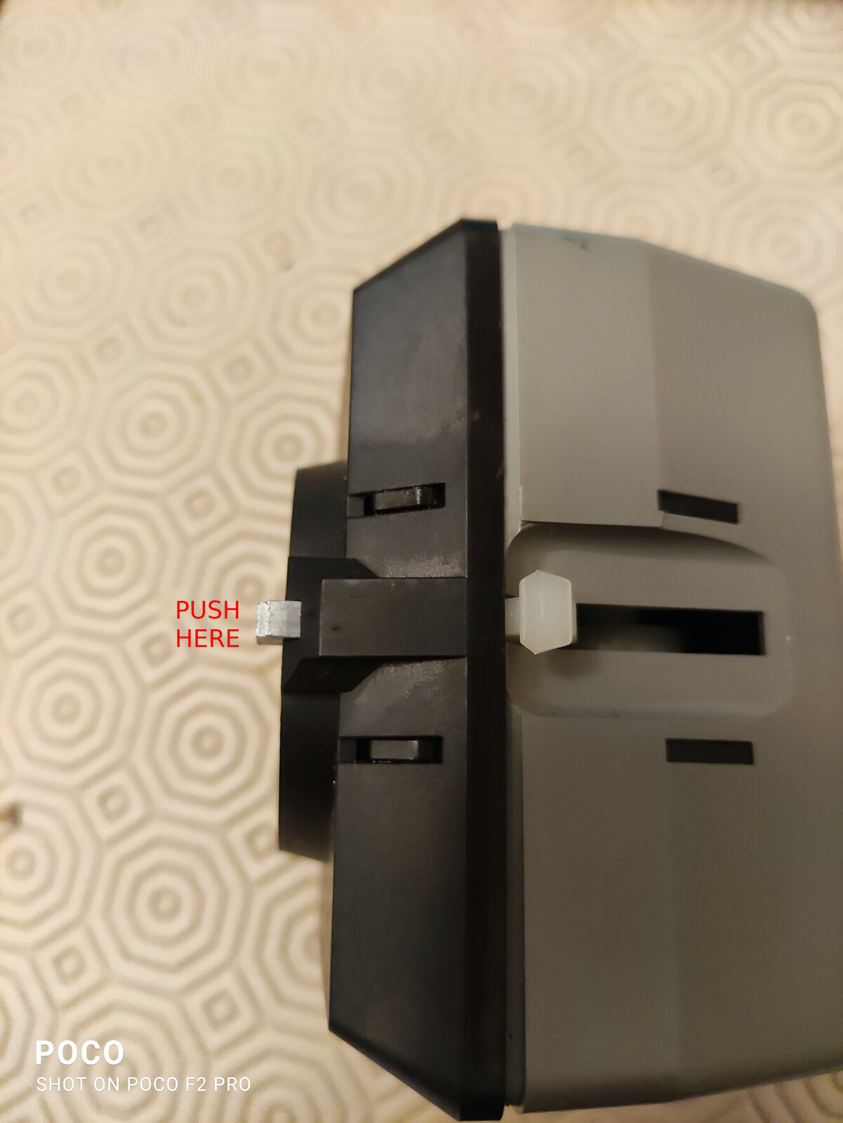

I have an ideal isar boiler and currently seems to be heating the radiators, even when the central heating is not acttivated, so it seems there is a problem with the diverter valve
I have read on these forums this happens when the diverter valve is not working properly
I do have the Service manual, so was thinking of looking at it myself
However, when I try to remove the head of the diverter valve is just stuck and cannot remove it
This is a big problem, as if I cannot remove it, I may need to change teh whole boler - which is going to be very costly
Any ideas will be appreciated
It is simply 1/4 turn anti-clockwise then it will pull off, remember and disconnect the electrical plug
I tried that, but it won't bulge a millimeter, and do not want to break it!
If it's already not working, what's the problem with breaking it?
Just figure out how to do it
I do have a spare valve and its head , so played a bit with it , and noticed there is a small "lever" at the back of the head, so all is needed is to push it white you twist the head anticlockwise. See the picture
Also needed is some clearance to fully rotate the head, but should be easy to achieve

Actually it IS working, but not 100% correctly, so if I break the valve - and cannot fix it - I will have no hot water or central heating
My wife will not be amussed!
Removing the head is faily easy if you push the lever on the back of it. as I said, you also need to make some clearance so you can turn the head
Oddly enough the manual only says you need to twist and then pull out, but does NOT mention anything about the lever
Maybe the original boiler didn't have it?
