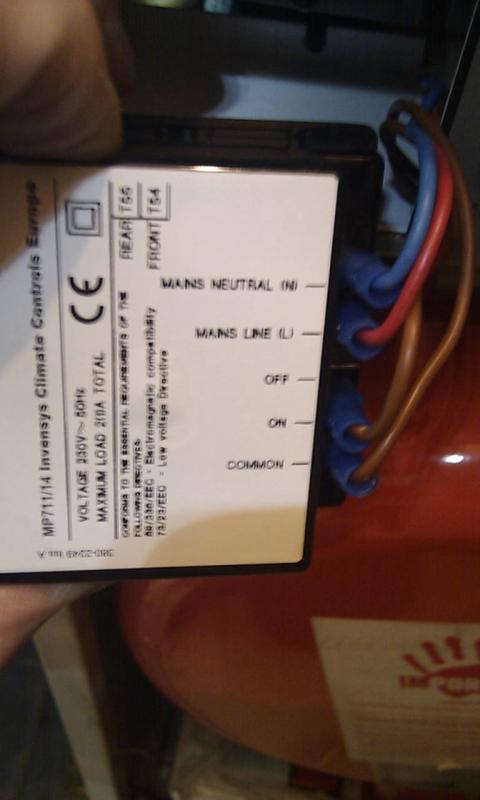

Could anyone please help me connect a Ravenheat R/F thermostat to a Grant Combi 90 V3?
The Ravenheat R/F thermostat is model number TH-920E(TX) transmitter unit and the receiver unit is RV-0356.
(The Granto Combi has a basic programmer which I would like to change to a controller with a thermostat).
Picture 1: is the rear of the Grant programmer. It has five ouputs with four connections:
Mains Neutral (N)
Mains Line (L)
Off - no connection to Combi
On
Off

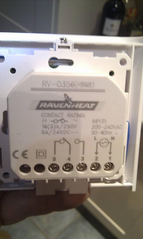

Picture 2: is the rear of the Ravenheat unit.
It has five inputs:
1 - N
2 - L
3
4
5
My question is this: The L and N connections aside, which connections do I need to make?

Blue to Nuetral
Red to Live
Brown to 4
Brown to 5
(Doesn't matter which brown goes where)
away she should go!! :wink:
