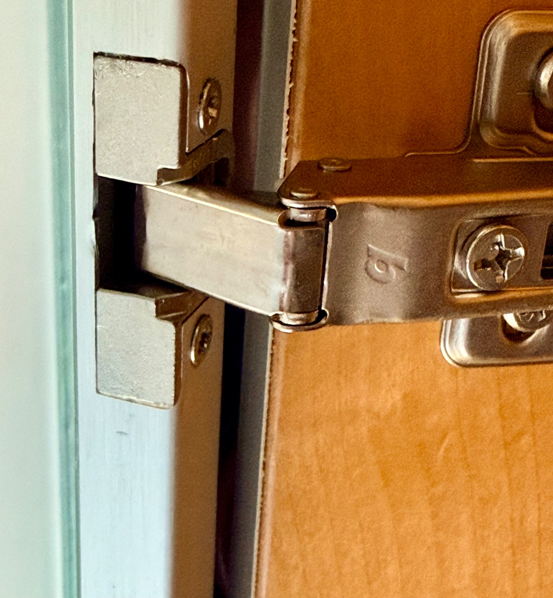

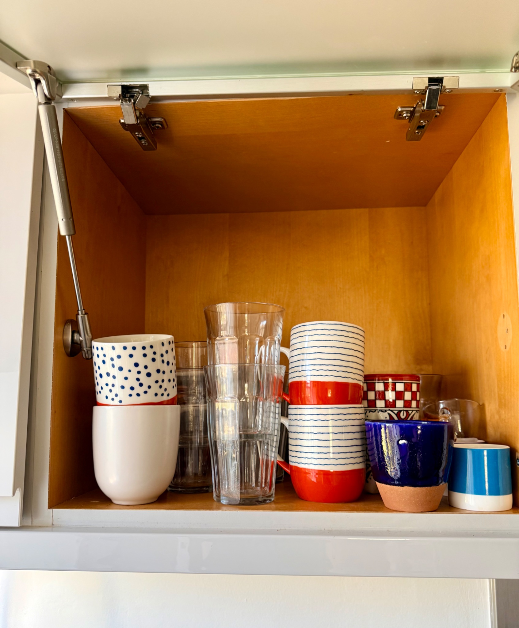

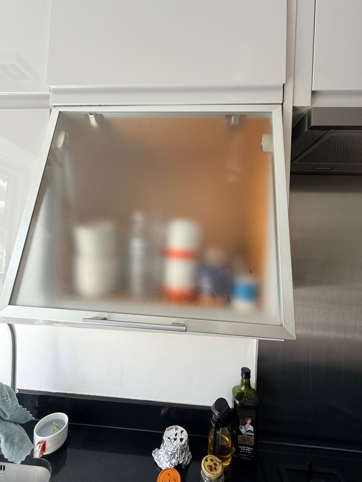

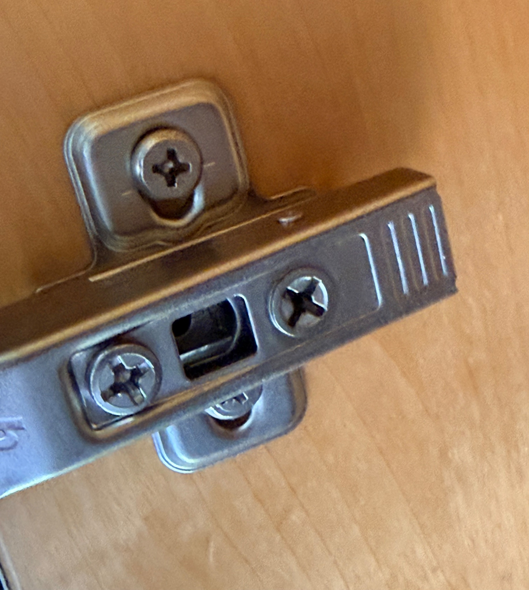

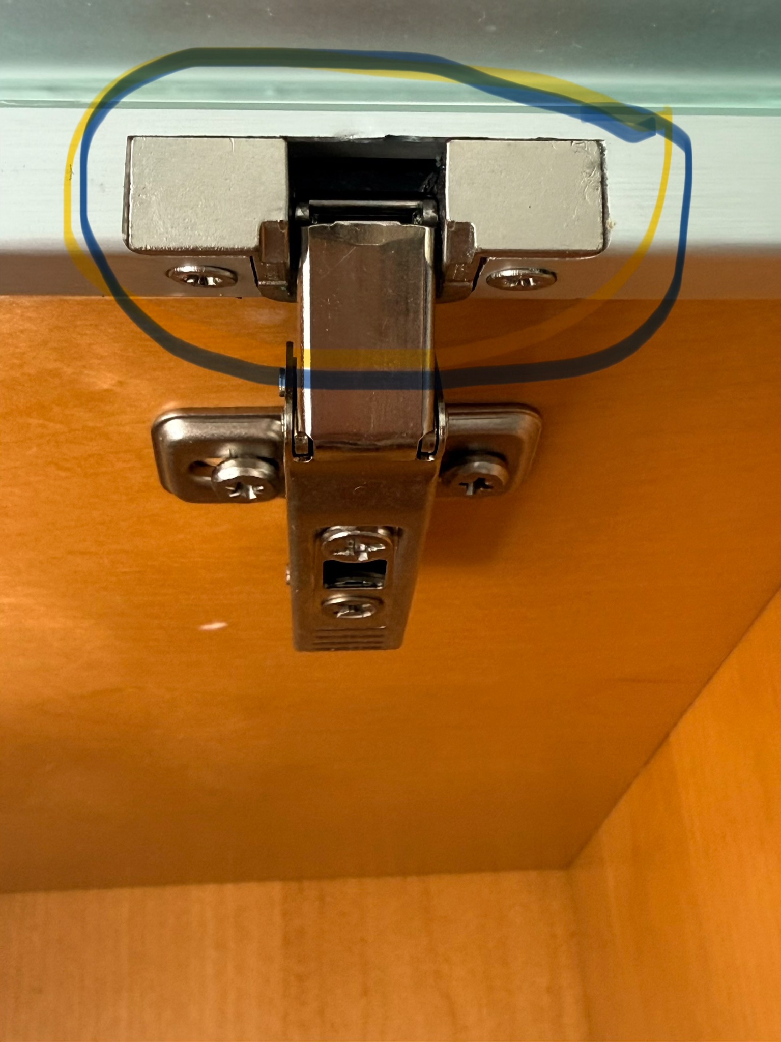

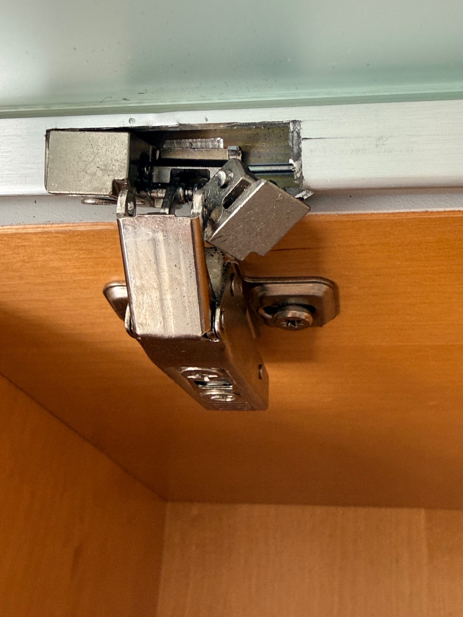

I'm hoping someone might be able to help me identify a replacement hinge for an upward-opening kitchen cabinet door. I've tried local shops and been in touch with online retailers, and no one seems to be able to assist.
I've attached several photos showing the hinge. One side is still working, while the other has failed. The broken hinge needs replacing, but I've been unable to identify the correct part.
The main difficulty is that the metal insert that screws into the top edge of the door is a very specific size. It measures approximately 1.7–1.8 inches (around 43–46 mm) long, so I can't simply buy a similar-looking hinge without knowing it will fit inside this top edge
Unfortunately, I don't know the manufacturer of the kitchen or the hinges, as they're quite old.
If someone is able to identify the hinge I need from the attached photos, or recommend a compatible replacement, or where I should go to find what I need i'd be very grateful.

The hinge in your photo appears to be the Blum 71T950A (CLIP top, 95° aluminium-frame door hinge, overlay)
