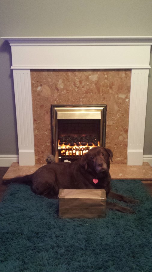

I have finished it. The 1-2-3 primer worked well. Im now using it on door frames as well.
Green rug isnt staying. Walls are grey now and white and grey accesories.
I think I need to put some sort of protector over the fireplacem what would you suggest? I dont want clear shiny varnish. But i want something so that if I wipe fingerprints of the firesurround it doesnt wipe the paint off. What would you suggest.

Best just leaving it to harden for a few weeks then giving it a good sand with a sanding block, then see what it looks like.
The more you mess with it the worse it will get. You need to let the paint fully harden before you sand it, otherwise it'll end in the skip.

I think were we have gone wrong was thinking it wasnt indented where the mouldings had been. It honestly didnt look it or feel it! So after 2 lays of paint and hand sanding it still not looking I got a powerful torch and shone it down the length of the fireplace and then it was obvious it was ever so slightly indented.
So I bought a black & decker mouse sander (which was fantastic by the way!) And sanded till I was happy the middle bit was all at the same depth and no indents. Then used 1-2-3 primer and 2 coats of paint. :)

I wouldn't really go down the route of adding a protective layer unless you expect the satin finish to be bumped by putting things on the mantel, etc, because water based paints will scuff more readily than oils.
If you do feel the need to protect it, I would recommend Polyvine Decorator's Varnish which is available in matt, satin and gloss finishes. It is used regularly within the trade as a protective coat for this type of thing, but be aware that it may slightly alter the look of the finish you have now.
