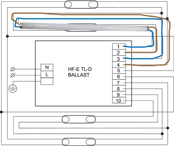

I have a Philips Essential HF-E 418 TL-D 4 x 18W electronic ballast which I want to wire to 3 18w tubes and I'm using T8 Push on fixing lampholders like below.

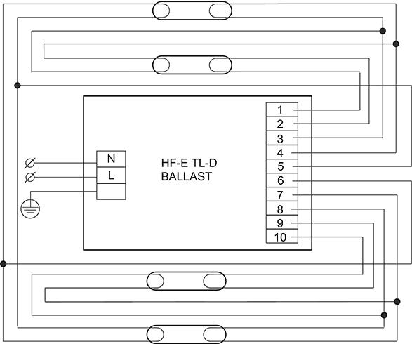

I have tried wiring up the ballest with one tube so far and it hasn't worked so I want to make sure I'm doing it right to rule out a faulty ballast, here is the wiring diagram
I have wired it (with 0.50mm2 2 core flex) like this so far:
It will not drive a single lamp on its own. All four tubes should be connected before testing.
Your plan to drive 3 tubes isn't going to work, to do that you'll need one ballast designed for two tubes and another designed for 1 tube
Strange. Must be a typo on that page. If you download the PDF data sheet it says it's for four lamps.
So generally the way these florescent electronic ballasts work it that they have to be at their capacity or they don't work?
Or a 3 tube ballast would be neater :)
