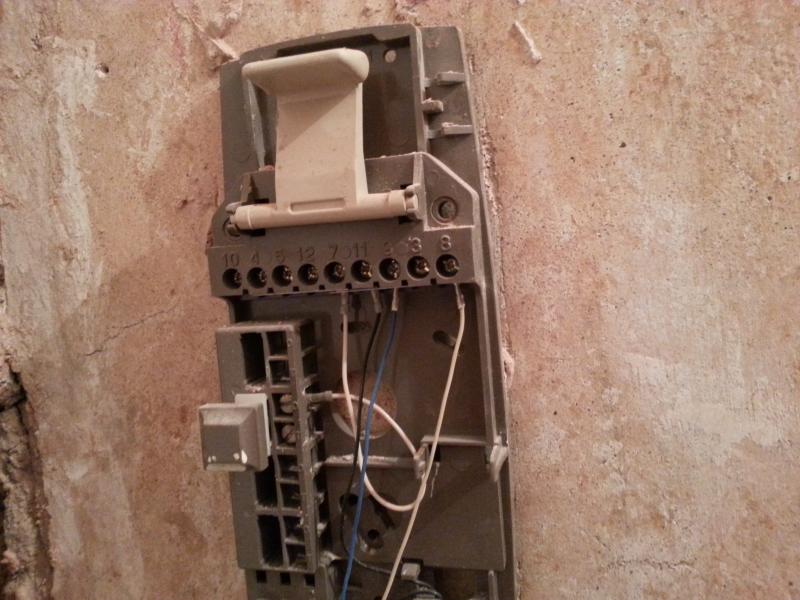

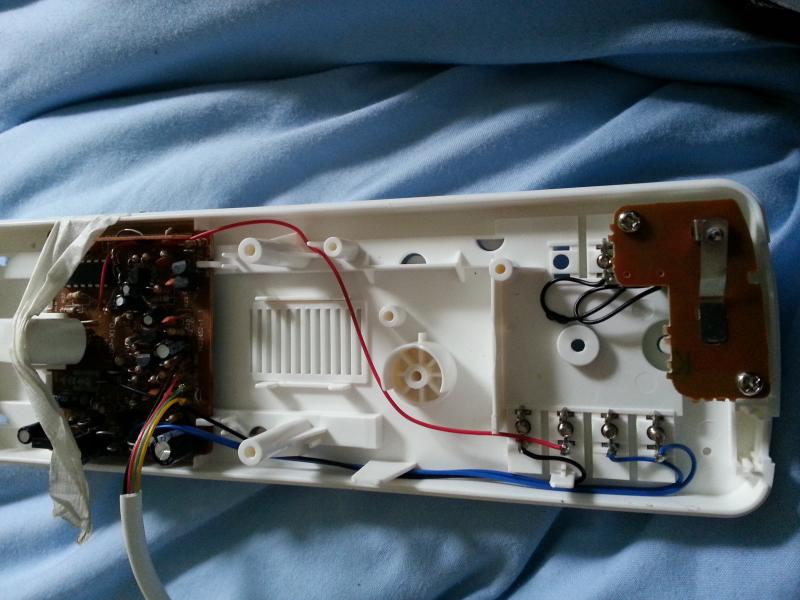

Hello, I really need help with the correct wiring for my intercom. I am not sure where to put the orange/white white/orange blue/white white/blue wires etc.
Can someone please advise? I would be really grateful.
The settings are:
On the left (top to bottom)
D
S
G
On the right (top to bottom)
2
3
4
Please can you tell me where to put each wire.

There is no standard colour code, so assuming you've got the right handset, ask a neighbour if you can look at theirs.
If you haven't got the right handset then there is no guarantee it will be compatible.
Pictures of before you disconnected may have assisted. Is this your property or a shared/rented? Are you aware you could damage the whole system and be charged for the repairs?
As it happens the two handsets can be interchanged but the wiring would be needed to know as the other poster mentioned.

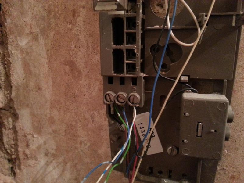

Thank you very very much for your response. It is my own property. I have taken a photograph of the handset before.
I would be really grateful if you can advise on which wires go where.
You have made life difficult for yourself.
A new Citron Universal handset would be easier to connect to.
However, it looks like an old elvox you have. 5,1,2 will be the speech and common.
5-Common
1- Speech from Door
2- Speec from Handset
The button will also share a common and use a spare core to activate the door release which should be 6.
7- will be the buzzer.
On the new 1,2,3, would be the speech terminals, probably 3 being the common.
D & S being the release with that link on the back being the common again.
4 is probably the ringer/buzzer.
Try that and see how you get on.
