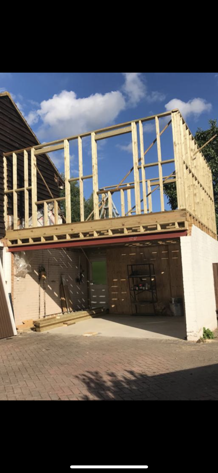

Hi all.
we had an extension done above our double garage to make the new master bedroom.
I am having issues where the floor in the master bedroom is creaking like mad on every step all around the room.
the extension was designed with floor joists going horizontally across the width of the garage. See attached pic where you can see the floor joists on the right hand side
Chip board flooring was used. I’ve found over time the floor is getting noisier and noisier and the builder said it’s most likely due to the length of the beams and nothing can be done.
any advice on whether this makes sense or could it be due to the installation of the chipboard floor?
I was thinking of lifting up carpets and putting more or longer screws down.
Will this even help
many thanks for assistance in advance. Stuck and what to do without ripping off floor which is also plastered in the garage.
Apologies for the spelling in the title. Can’t seem to find how to amend this

there's construction adhesive catridges specifically for gluing down sheets to the joists - glue and screw. screws are specific and on a fixing schedule, not just anything anywhere. careful about new or longer screws or you could hit a cable or something.
Did all t&g edge joins come together and were screwed down over joists or noggins - never free floating.
Whats the span and section of the joists?
any heating in the floor?
are expansion gaps say 10mm at abutments?

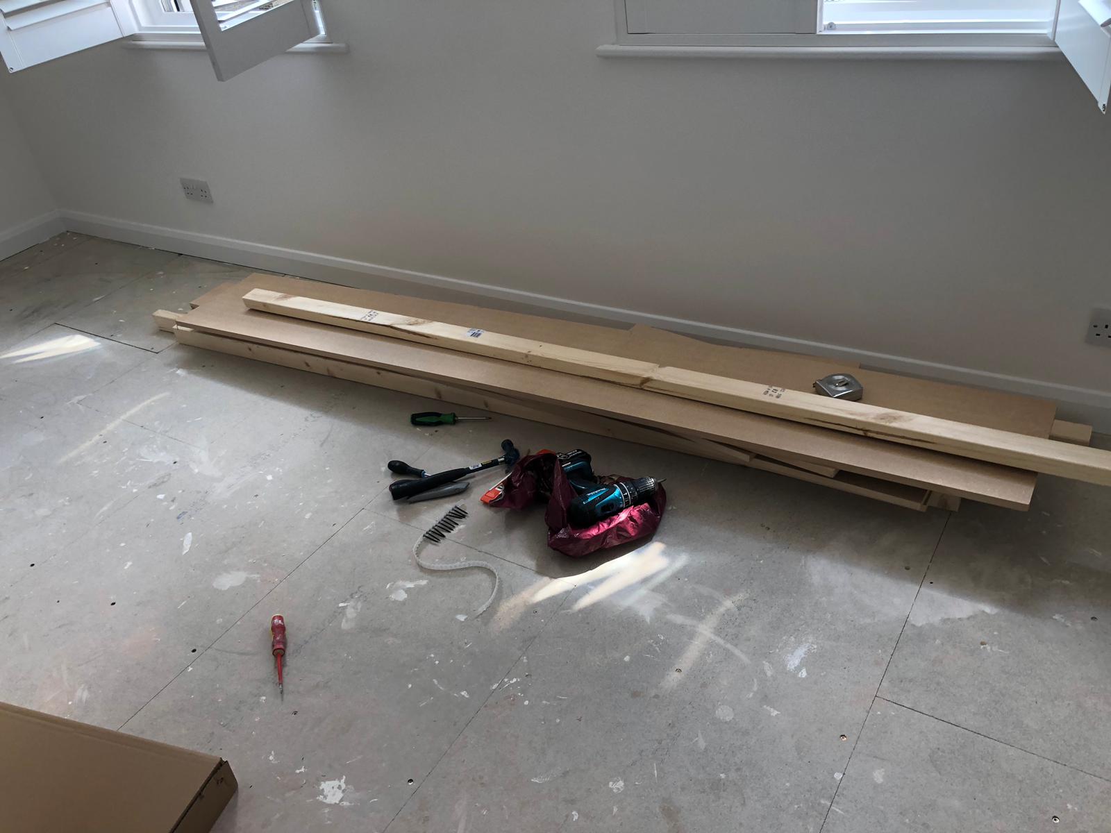

Thanks for the reply. Unfortunately there are joints that are not screwed down. See pic that I found.
There is no heating in the floor and the joists are about 45cm apart. I can’t even get under without cutting up the boards.
Yes they put expansion gaps all around the outside of the room where the plasterboard sits on top.
Is there anything I can do without ripping up the flooring and skirting?

Doesn't appear that the short edges are sat on joists
You can pop a load more screws in, if you take an existing screw out and get some the same length you shouldn't hit anything underneath , screw to all the joists too
Squeaking says that your floor is not glued down , that's my bet anyway !

thanks for this. Poor work by the builder then.
Is it worth getting the boards cut out and putting some support under the short edges and getting glue down on joists? I know it’s a big job but would need to work from middles to sides if I wasn’t to rip off the skirting.
You would still need to remove the skirting , remember you shouldn't need to remove all the skirting just two sides should do , if you get a nice thin pry bar you shouldn't cause too much damage to your skirting

No no you remove a long side and the short side next to it so you have a corner with no skirting and that's where you start lifting the flooring and the flooring underneath the remaining skirting will just slide out
gorilla glue? which one? it could be pva or super glue which is wrong . the joints in these floors should be bonded using polyeurethane adhesive.
