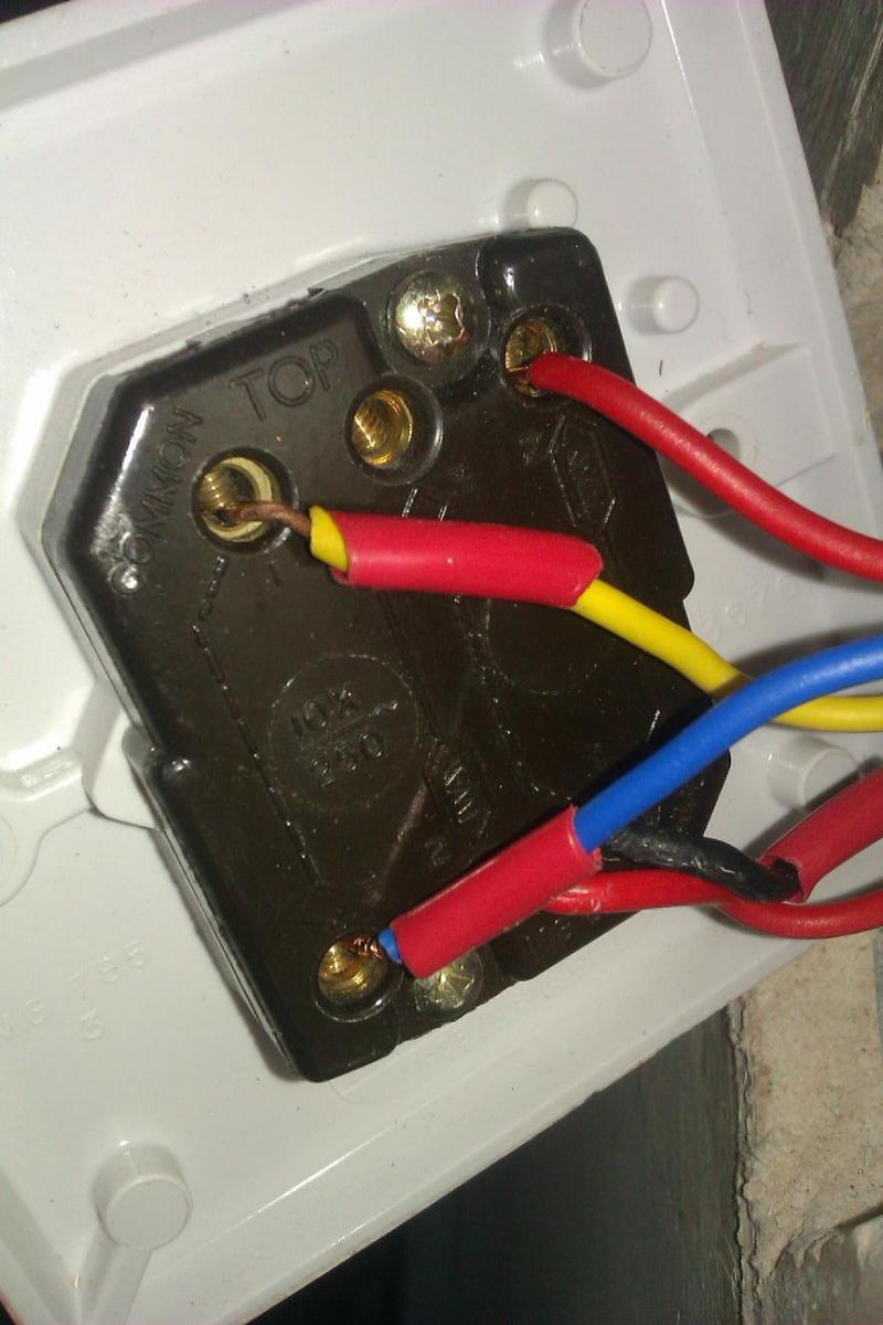

The original set up is here, this is a picture from a two way switch in my front room operating the front room ceiling lights and the landing light.
This picture below is the switch on the landing.

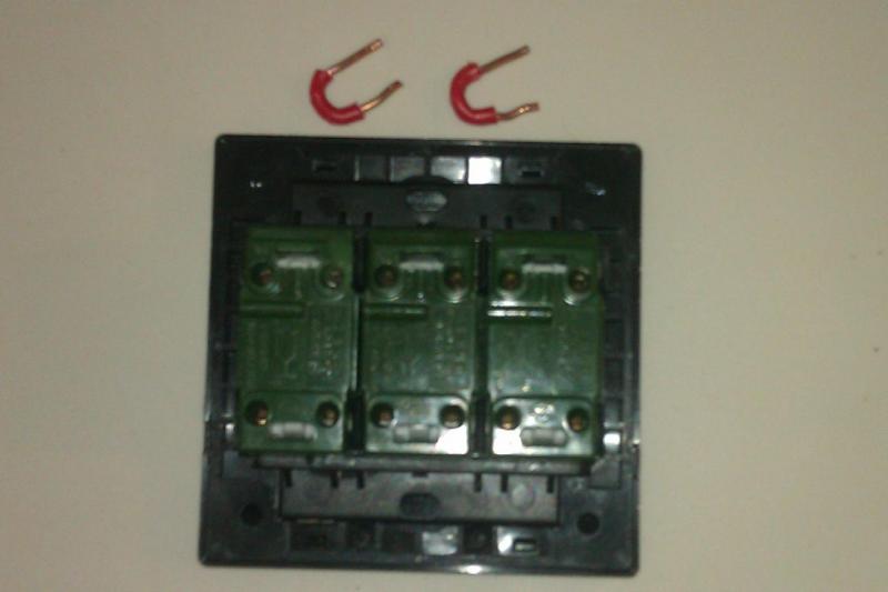

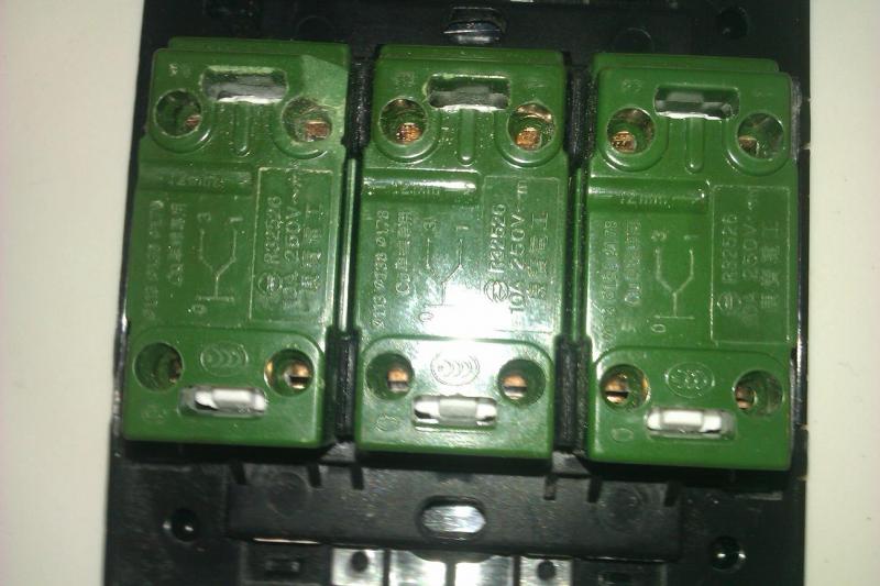

The pictures below is the new 3 gang switch, on the left of the switch it is marked 0 for 2 wires to go and on the right it is marked 3 at the top and 1 at the bottom of the 3 individual gangs, their is also 2 red loop wires that came with it.
I have tried to connect it up almost had it ok the problem was i could not switch off the landing light at the landing light switch.
At some stage i would like to connect wall lights to the spare gang at the bottom of the new switch.

Your existing switch is laid out like this
In the new switch all the switches are the same way up.
The wires in the COM terminals will go in the one marked "0" the other two cables go in 1 and 3.
I never saw a switch marked like that.
