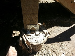

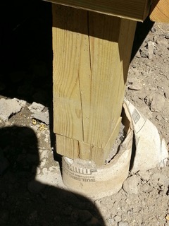

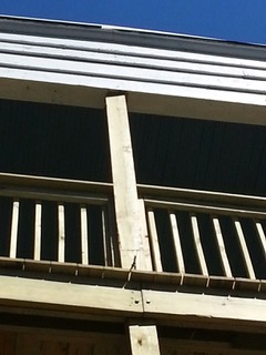

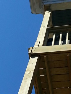

Hi, I just had new rear porches done for a 3 unit building in MA. All work for these porches were new. See attached pix. The main wooden posts sit on, not in, the concrete footings. Is this standard practice? That's my main concern because the porch doesn't seem secure. In another pic, the concrator put in a piece of wood under the main post because the posts were too short ( see pic ). This looks all wrong but the town inspector signed off on the work. I couldn't believe it. I still hold the final installment. I do not feel I owe it to the contractor. Please le me know what you think of this work, and what I should do. Thanks.

Not sure what your weather conditions are like over there, but do you have any high winds that will shift the posts that haven't been fixed down. The inspector isn't worried about how bad it looks, but he shouldn't have signed it off without the posts being fixed into what I assume are the concrete suppots.
You know the works shoddy from the pictures you've posted. They should replace the short post, redo the joined post, and reposition the central post in the second picture. In the thirs picture, they should replace the board that's too short, and if they are not prepared to do it, then you withold the final payment to get someone else to correct it. And I'd query the inspector as to why he signed off on the unfixed posts.

The porch is obviously unsafe and not fit for purpose. Dont go on it or allow the porch deck to be used for any purpose.
Much propping might be needed while remedial repairs take place - in fact, you might be looking at a complete demolition of the porch and a re-build - not just repairs to the sono tubes & post base connectors.
The rim joist connections are wrong and unsafe - & how the deck is connected to the house might also be an issue? As it stands, that deck could shear away from the house due to wind pressure or loading.
If you live in a rural area or small town then the Mass Building Code will still apply & you could apply to a larger jurisdiction, ie a county or large town, for another inspection.
FWIW: I dont believe for a minute that your porch was passed by a licensed inspector.
