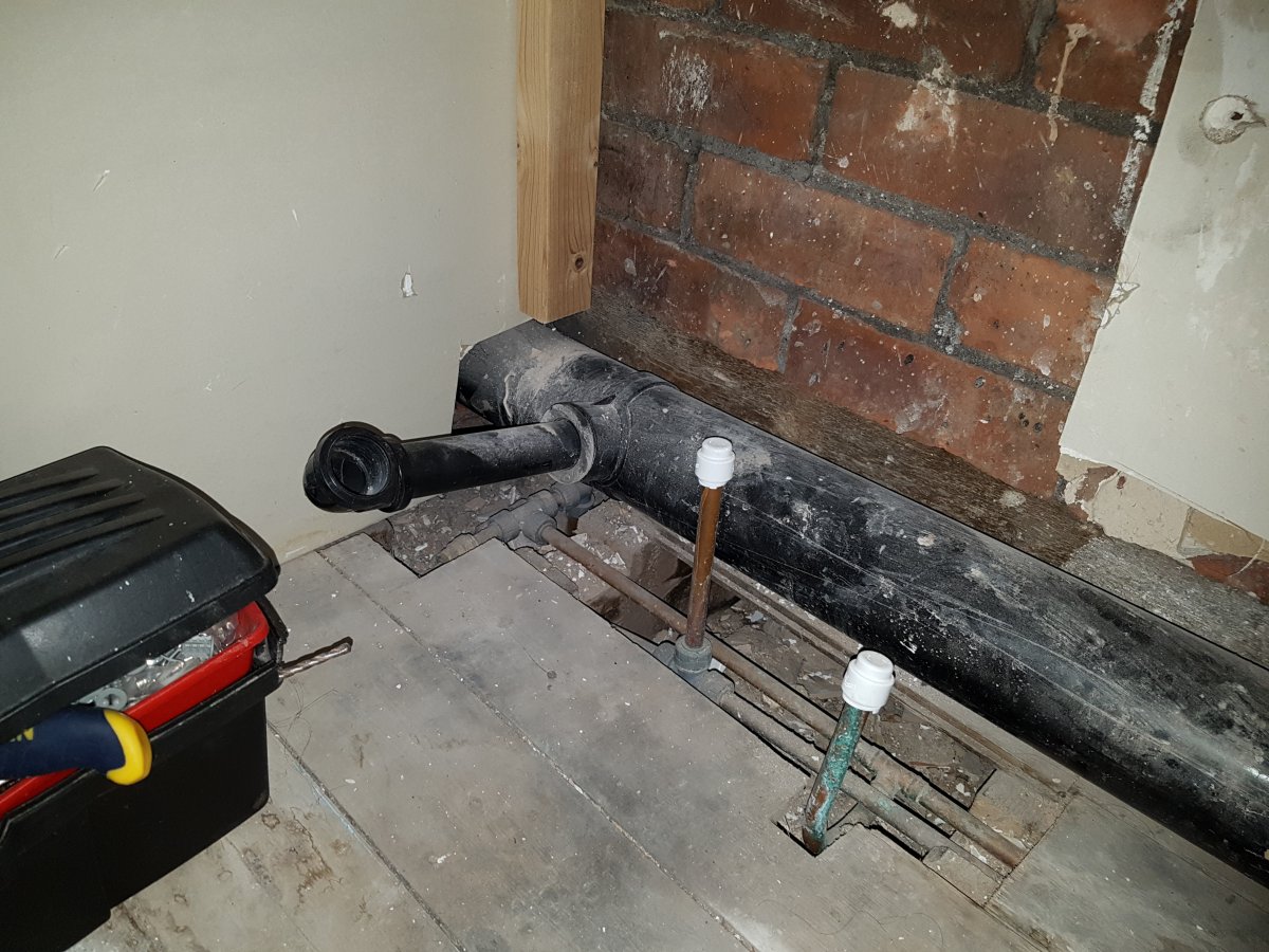

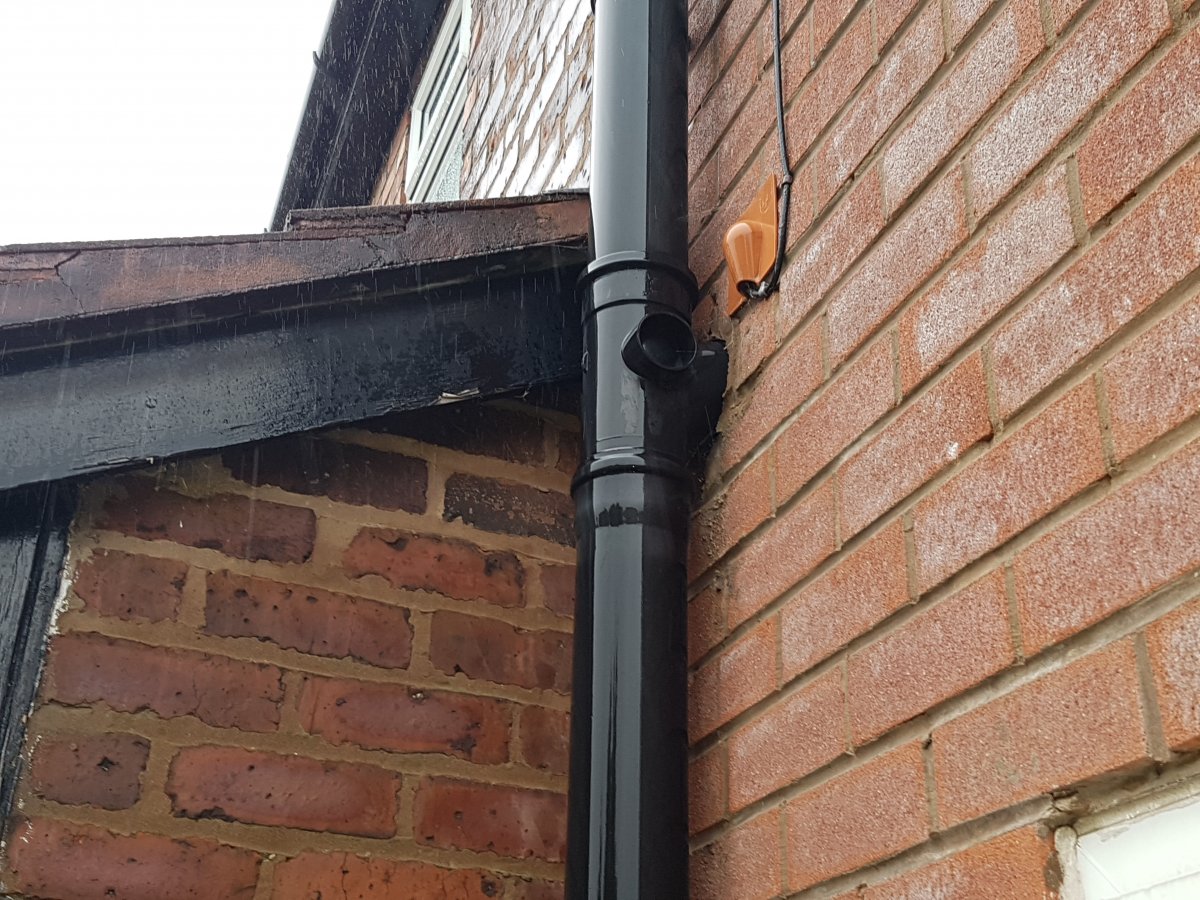

HELP NEEDED - Started a project to strip out the bath from our old Bathroom as we want to replace the Bath for a 1200 Shower Enclosure.
I need advice on how to fit waste pipe under floorboard level to the soil stack outside. When access is almost impossible due to a lean to roof on the back of the property.
See photos and full thread in Projects Forum.
Soil Pipe Unboxed.jpg Soil Pipe Lean To Roof.jpg Soil Pipe Bath.jpg Soil Pipe Extension Entry 1.jpg

The only option, without that great big step, is going to be to get access into the roofspace on that lean to, run the waste through there and connect to the stack at appropriate level. Personally I'd have taken the soil pipe through there too at time of construction, rather than box it in in the bathroom.

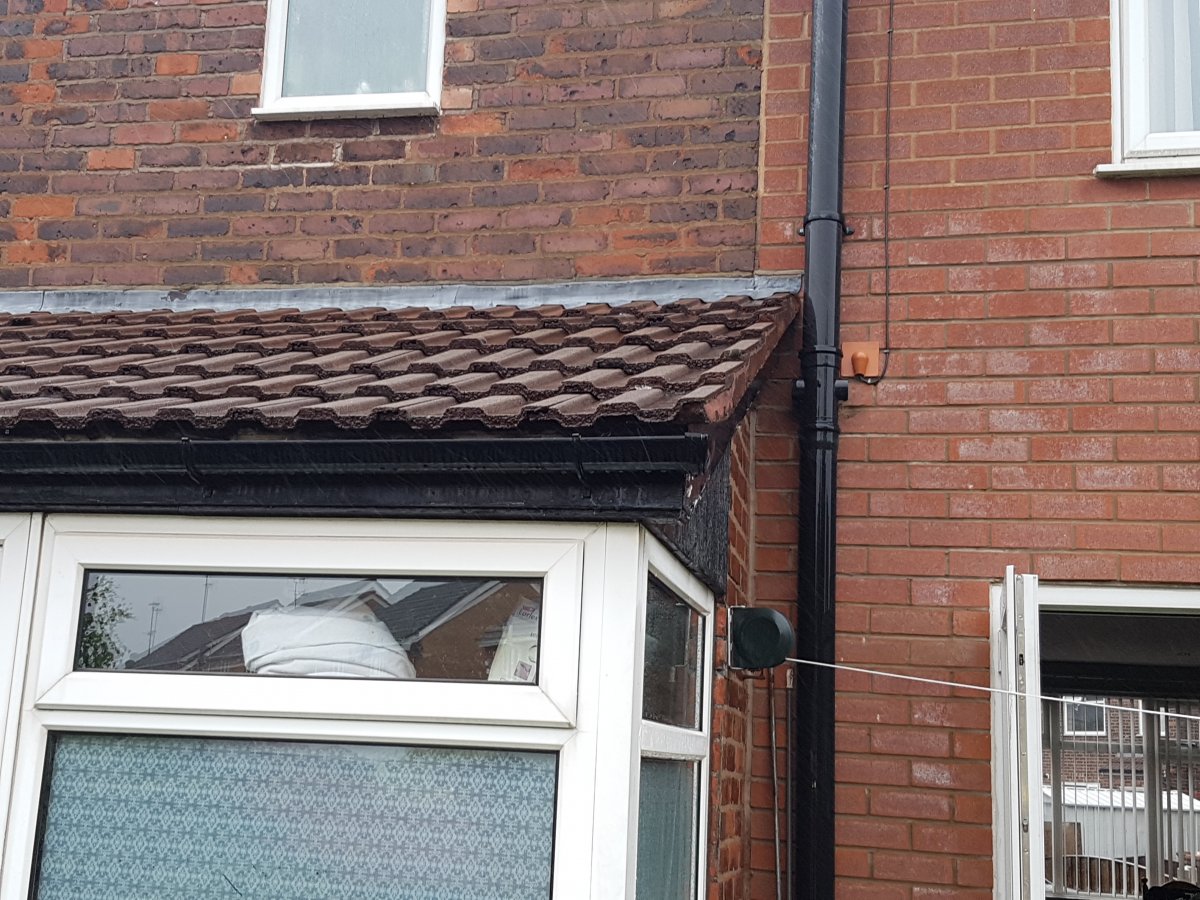

I'd cut a hole into the ceiling to gain access into that roof void, and then make a small hatch to make for any future needs. I really don't see there's any other way around it, other than the shower being up in the air. Might even be tempted to reroute the WC soil pipe through there too, making more room in the bathroom.
Apparently routing the soil stack in the roof void was considered when they did the extension. The builder apparently said, "he couldn't do it due to the flashing ridge of the lean to is where you would bring the soil pipe out" being at the level of where the flashing is pointed into the brickwork course.
Next step is to have a look in the void and make a hatch as you have suggested.

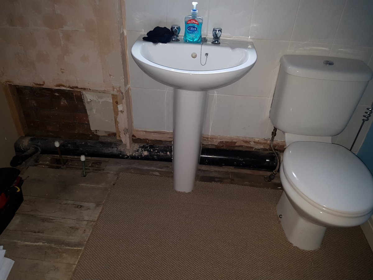

The bathroom is quite big anyhow so space is not an issue but when you look at the interior brick wall the brickwork course is not flat it is stepped back by 15mm to accommodate the interior soil pipe. All other houses in the street are like this.
Just my luck I guess.
Ideally the design should have taken the soil pipe height into account, the roof on the lean to could have been a slightly steeper pitch and there wouldn't have been an issue.... Whilst the soil pipe may have to remain as is, I don't think you'll have an option for the shower waste.

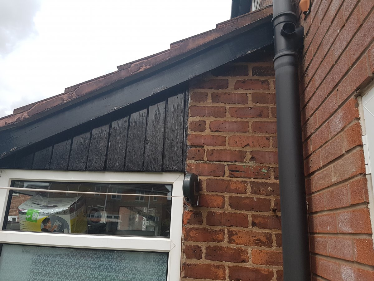

Took another look at my Shower waste issue the lean to roof is set further forward and the internal bathroom wall is not inline. See Photos
The inner bathroom wall is about 3' further back from the lean to.

If you look at the lean to roof photo.
The Lean to roof is set back 2 foot as can be seen from the side view of the lean to porch.

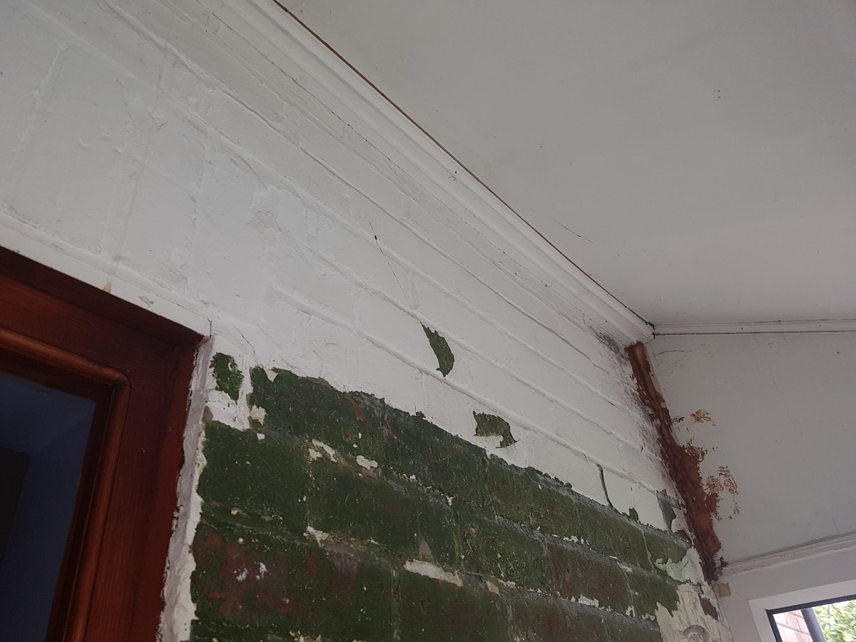

Also when I was stripping out the tiles we had a bit of an Ant problem coming out of the cavity.
