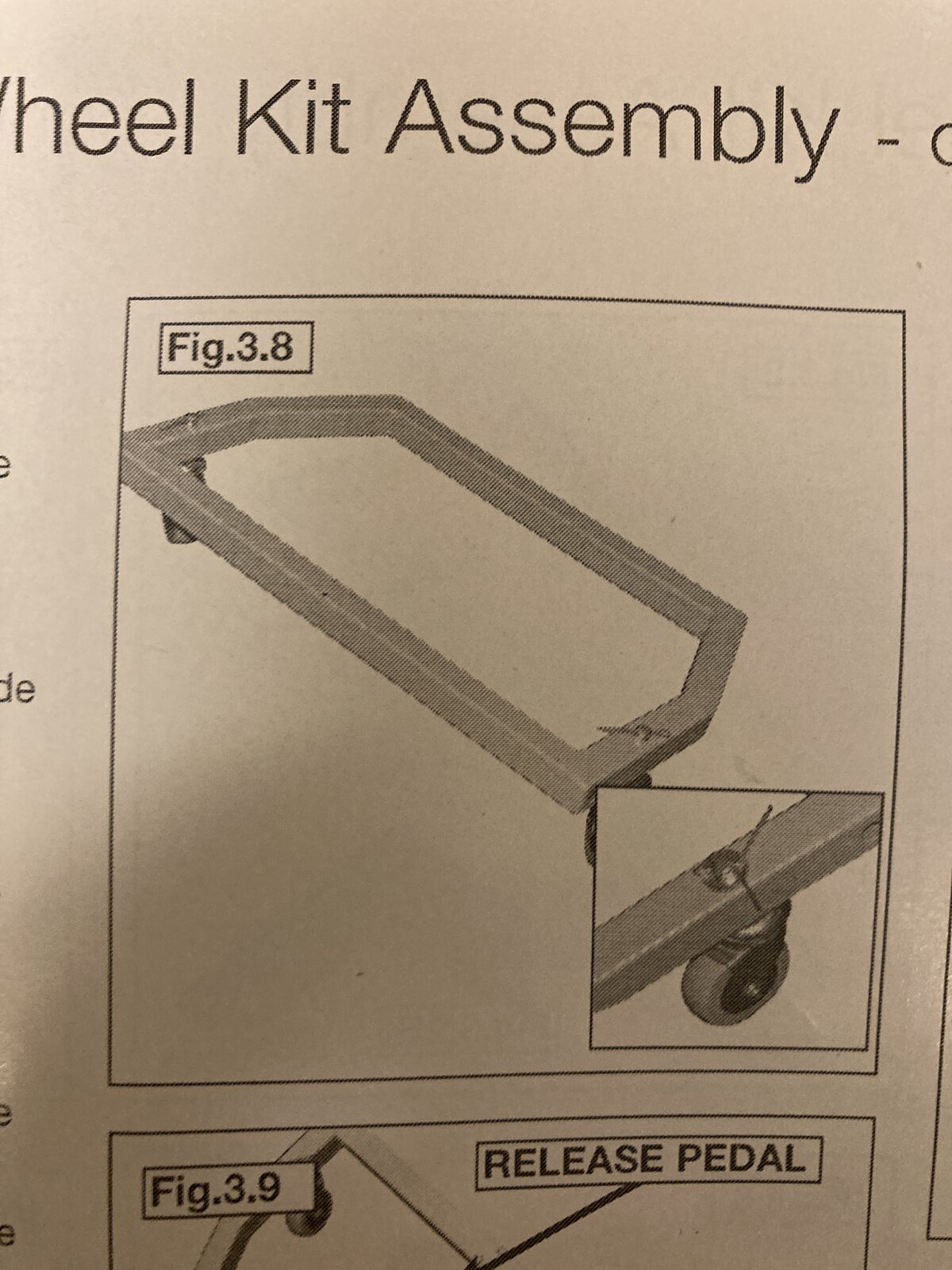

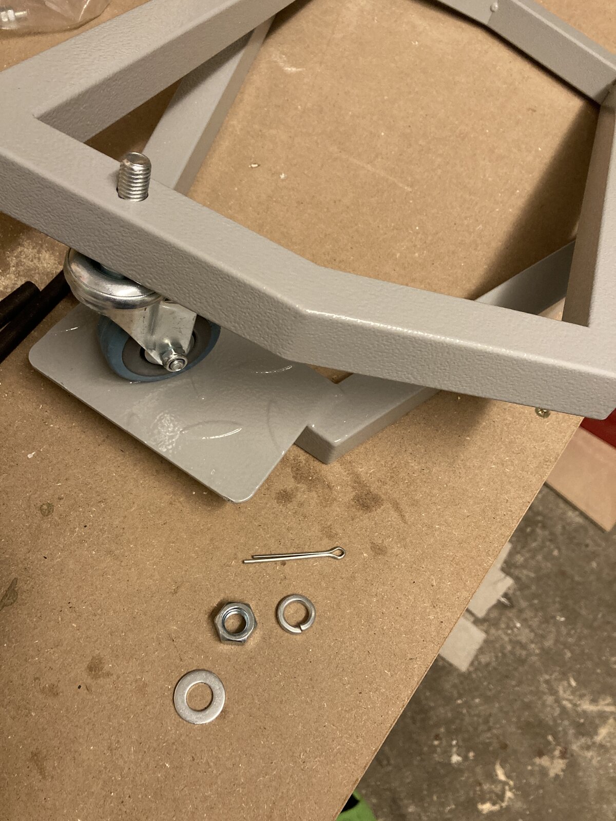

Hi there- bit of a long shot but does anyone have the Record Power BS 250 Band Saw with the stand and wheel kit?
I thought the instructions for the bandsaw itself were tricky but the ones for the stand are next level challenging. The instructions tell you to secure the wheels to the frame using the pin and washer provided- no other description and the pictures are completely blurred so impossible to fathom how it actually goes together.
The wheel itself comes with a bolt and washer loosely screwed onto the bolt, which are not referred to in any way in the instructions. I've taken a picture of the components. How does one attach the wheels using the pin and washer?? There's no hole for the pin to go through.

Ok thanks. I did wonder something like that, or they had changed the fitment method I.e bolt rather than pin and not updated the instructions. I don’t really get why you’d secure the wheels with a pin rather than bolt anyway but perhaps it will make sense when it’s all put together.
Yea makes no sense why you'd use a pin rather than nuts, if you use the nuts everywhere else you know you're supposed to on the sand then do you have some you can use on the castors? Or will you be four short?
Two alternatives for you - either get yourself a Nyloc nut and use that instead of the standard nut, or apply a thread locking compound (e.g. Loctite) to the nut. In both cases don't tighten the nut fully and the clevis pun isn't needed. Double nutting will also work
Are these castors such poor quality that the threaded stem has to turn within the holes in the frame? Rather than the wheels turning independently of the threaded stem?
Thanks all. Found a technical helpline which they actually answered quite quickly and were helpful in resolving this issue. Turns out they changed the design to secure the wheels with the nuts, but haven’t updated the instructions yet!
