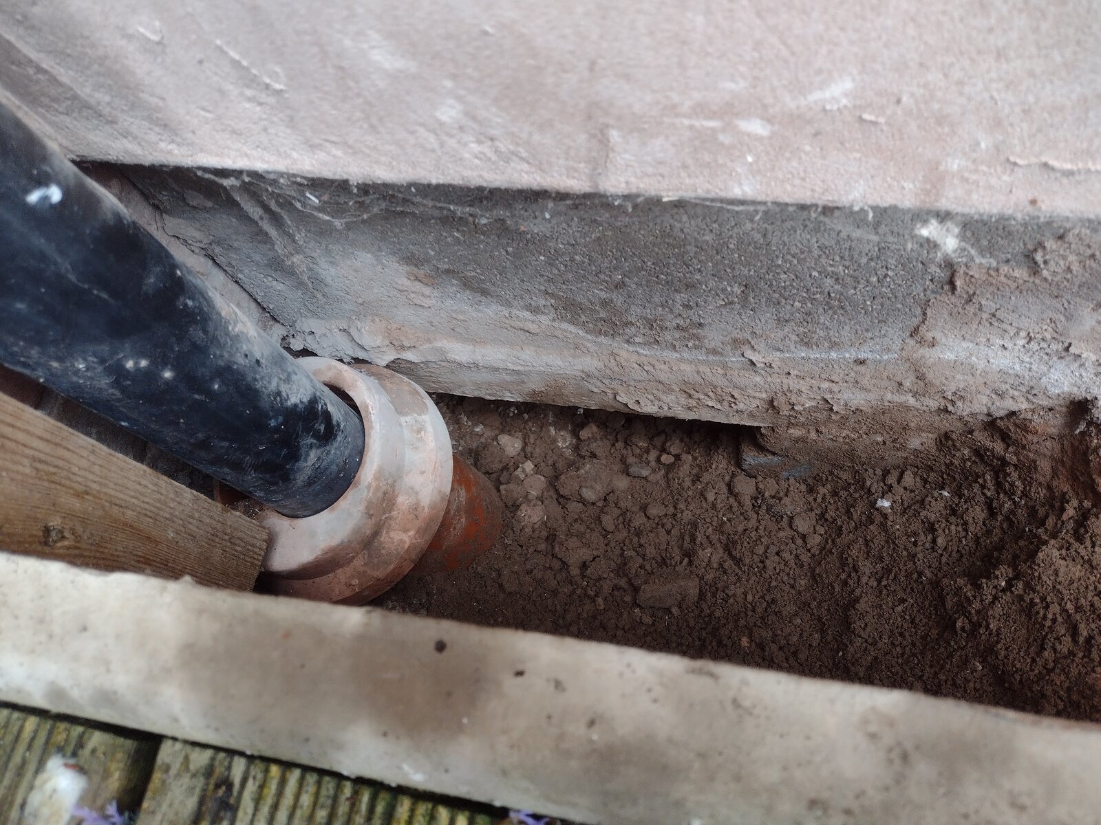

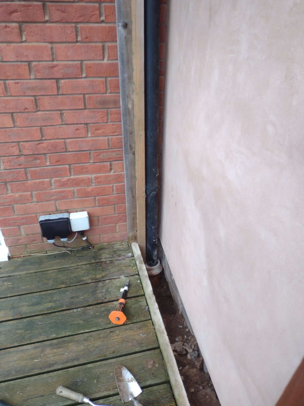

I have had a problem with rats getting into my extension and scaring the other half!
I have dug a trench along the edge (see pictures below) and there seems to be a large gaping hole around where the rain water down pipe goes underneath the extension. Im not a builder or anything but im guessing this has been bodged by whoever built this?? (Extension was already there when bought house).
How would you recommend fixing something like that?
Any thoughts or suggestions are welcome! Like i said i am no builder..
Cheers :)

Surely something like this when it was built should have been blocked off and sealed around the drain ?

If a soil pipe was once where the extension is and has been moved it's highly likely that this hasn't been capped correctly.

I would highly recommend a full drain survey by a reputable company as a starting point.
If your blocking any holes, use cement with crushed glass mixed in, stops them digging through.

The drain survey guy I used was more clued up than the pest control guy. That's where I found the old soil pipe, had to dig up the concrete screed to access the old soil pipe. Turned out the builder thought that the floor insulation was sufficient protection against rats rather than blocking the drain properly.
Hey Sxturbo,
We had a drain survey done expceting there to be a break in the pipe somewhere but they were all ok.
My next best guess is that they crawled up the soil pipe and chewed through the pan connector to the toilet in the extension but this is buried under some cupboards in the extension so ill be checking that next and installing a rat gate on the main soil line so no more can crawl up it.
I found some holes outside the extension right behind where the toilet is so im guessing they have come out of the back of the toilet and then burrowed down and out or out of the hole in the picture above.
