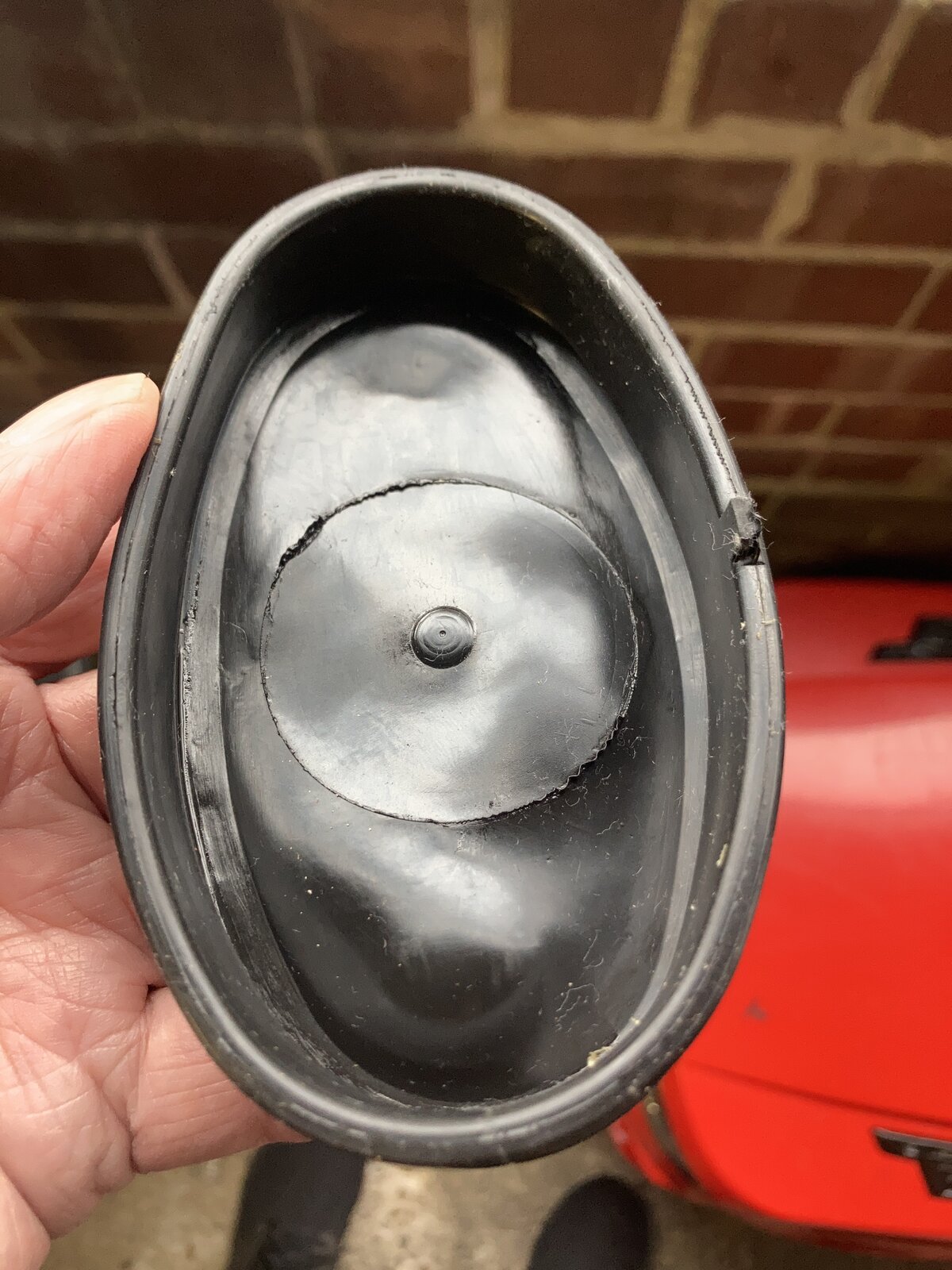

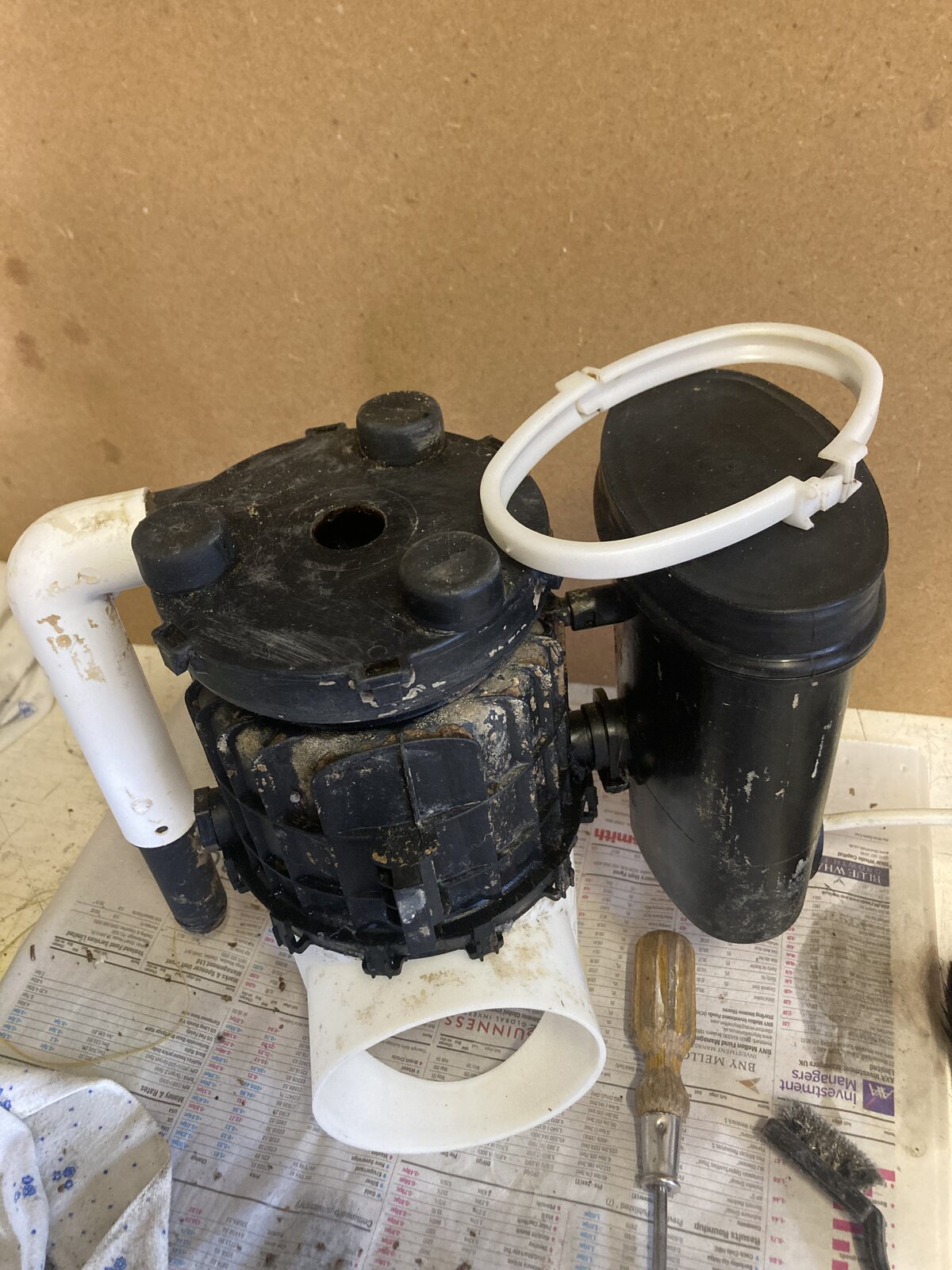

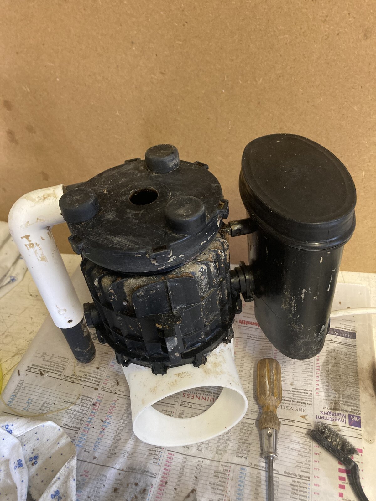

Our Saniflo has been failing to stop automatically for some time, just a gentle kick would solve it until recently when it would run forever.
Stripped and cleaned and removed the diaphragm. Found the micro switch works as it should until the diaphragm is replaced - permanently compressing the switch.
Is this how the diaphragms always fail, somehow gradually getting closer to operating the switch without the help of water pressure?
Thank you
Ray
I concluded the diaphragm has been "drying out" over the last 25 years becoming smaller and less flexible, not allowing the plunger to fall away from the micro switch.
After heating the diaphragm with an hair dryer and massaging it with WD40 it appears to work perfectly normal.
Just need to re-install it in the morning.

No, speaking from experience the diaphragm in our Saniflo is a lot more likely to fail to operate over time than it is to allow water in.
Thanks again for your help
Ray
I needed to renew the diaphragm yesterday after the "continuing to run" problem reoccurred.
As "Just pumps" and "dilalio" pointed out, it would have been a better idea to renew the rubber last March .... it works perfectly well now
