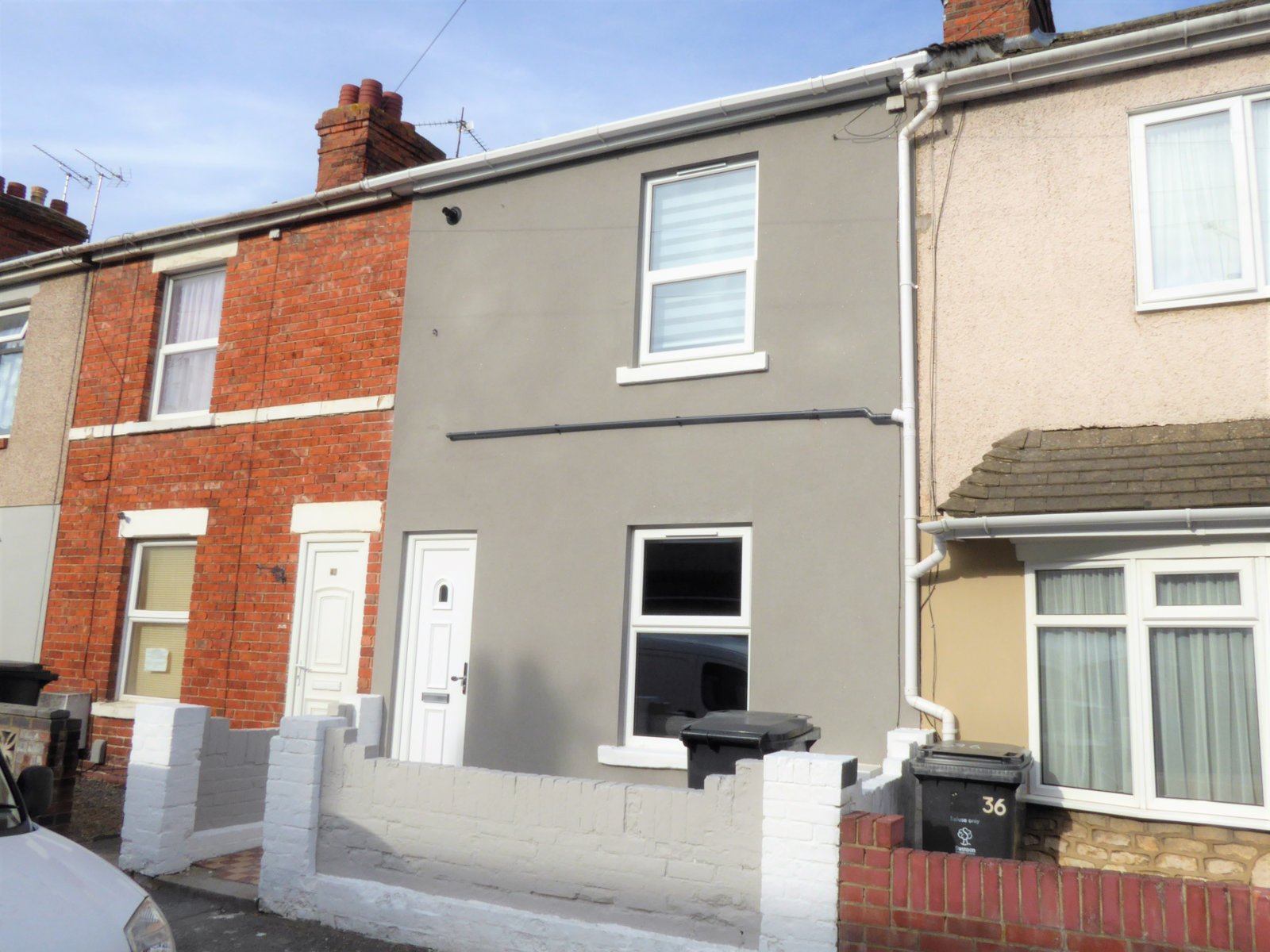

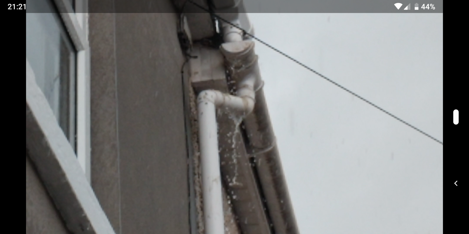

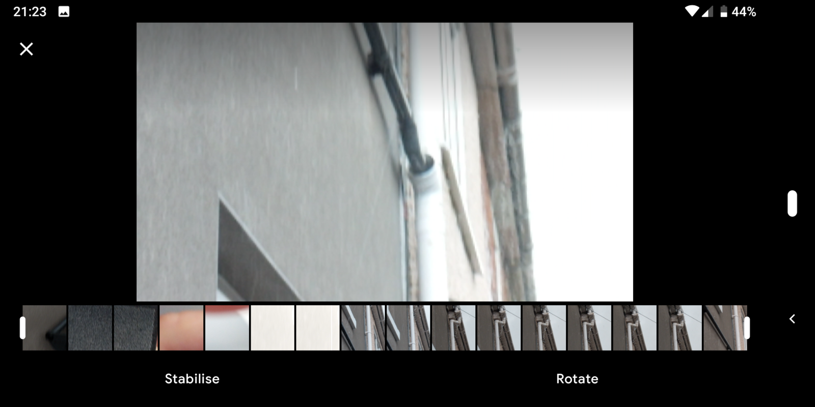

A couple for now....my house is the grey house on the left.

From what I can see initially is that it's their downpipe, but whilst you have a right (and they owe you a duty) to transfer rain water from your roof gutters, there is no similar right (or duty) to accept your condensate pipe - that will need to go into a limestone soakaway in the ground.
You can also install your own downpipe to your own soakaway if you can fit one in 5m from any building, and the ground is permeable enough (ie not solid clay). To install a new downpipe to an existing drain will need building regulations and water authority approval.
A better view of the house and small size of garden.

TBH, that condensate pipe may be incorrectly installed for several reasons in the first place.
And should only connect to the rainwater pipe if its a combined system.
The problem must be high up otherwise your boiler would be flooding.
I wonder if the water flowing down your gutter hits the water flowing the opposite way along their gutter, and stops it running freely down the outlet?
Maybe if you put an outlet on yours and joined both in a big hopper?
Either way, it’s not just your roof water going down there, it’s at least 1 other neighbour on the opposite side too.

No there is an air gap the output pipe is smaller diameter and sits in the black pipe (bit like a washing machine waste fitting) near the boiler in the cupboard upstairs. If the rain water backed that far up it'd start to overflow into the cupboard before getting to the boiler.
obviously a blockage Not the best offsets to use anyway and will be prone to blockage
fit a hopper at high level where the two separate pipes can empty into.
If Victor Meldrews over flows afterwards its his issue, if the hopper overflows its probably your doing .
