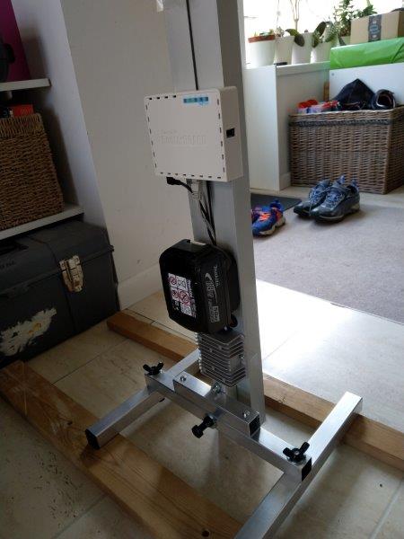

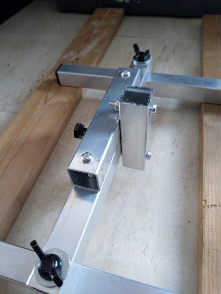

Just to report back. I ground down the top of an M6 bolt and that works fine. Thanks for the help. Here's the prototype stand with 2 ground down bolts - will make the next one a bit simpler, but this proves the concept and that the 100mm vertical piece in the photo is enough to hold the fixture.
Here's a 10s video of it doing its thing.
