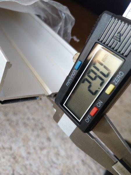

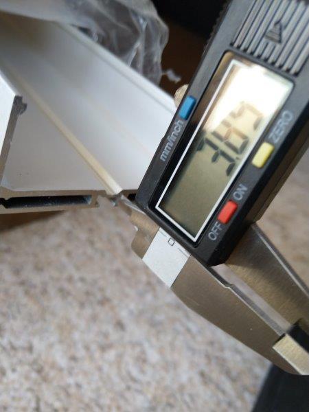

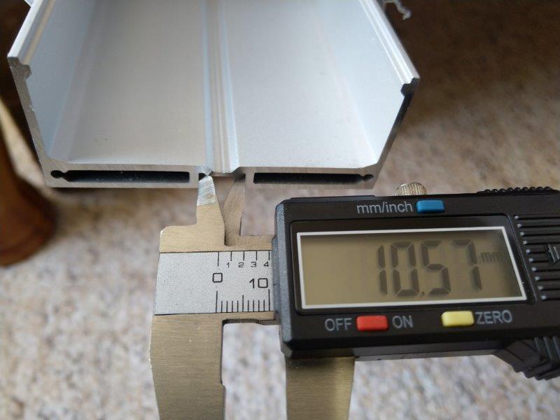

I'm trying to find a T bolt or nut that will fit into this track. All the ones I can see have the wrong shape, or are slightly too thick. I found some thin headed ones but they are too wide for the slot.
For background, I won't be suspending this fixture, It'll be stood on end, portable, battery powered from a Makita 18V pack, and filled with 624 addressable RGB LEDs and used to provide effect lighting for a band. There'll be 4 or 5 of them.
I'd like to attach the fixture to a tripod using the T-Slot and a lighting clamp arrangement. But 1st I need a T bolt. Ideally I don't want to drill through to the inside and bolt it that way, as I like the flexibility of the T-slot.
External Groove width - 6mm (An M6 bolt will fit and slide into the groove)
Internal Groove width -10mm
Groove depth - 3mm (narrowest) to 4mm (widest)
Photos below.

He's only got that 2.9mm to fit into, the heads are too tall.
M6 "half nuts" exist, but sadly they seem to be 3.2mm tall, as are DIN 562 'thin square nuts'.
Probably easier to make your own from some 10mm by 2.5mm flat bar stock. Drill and tap an M6 thread, then saw it off to, say, 20mm long. Longer nuts slide nicer BTW, instead of jamming up constantly.

Given the relatively low weight of what you're dealing with, do you actually need M6? As far as I can make out, an M4 panhead or cheesehead machine screw would have a head height of 2.4 mm (and, with a head diameter of ~8mm, would not slip through the slot). If you were concerned about it 'rattling about' (and/or not being centred) in the slot, you could even put a tiny bit of ~1mm thickness 'collar' around just the bit of thread which went thought the tract.
... just a thought! I personally would probably just grind down the head of an M6 bolt, which should only take 'a few seconds'!
Kind Regards, John
M6 roofing
That could work, a little bit needs filing off the top because they'll be 3.3mm(k) at the highest point. And the head is 15mm(d1) round, so can be filed down two sides to 10mm to fit in the slot.
