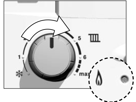

I believe this boiler heats water for radiators between 40c and 90c with 6 points on a wheel between those 50c differences. ((So roughly8.3c between each of the divisions beyond the min).
So , assuming I have my radiator dial set in the '4':
Then we would expect my boiler output radiator temperature to be around 64.9c.

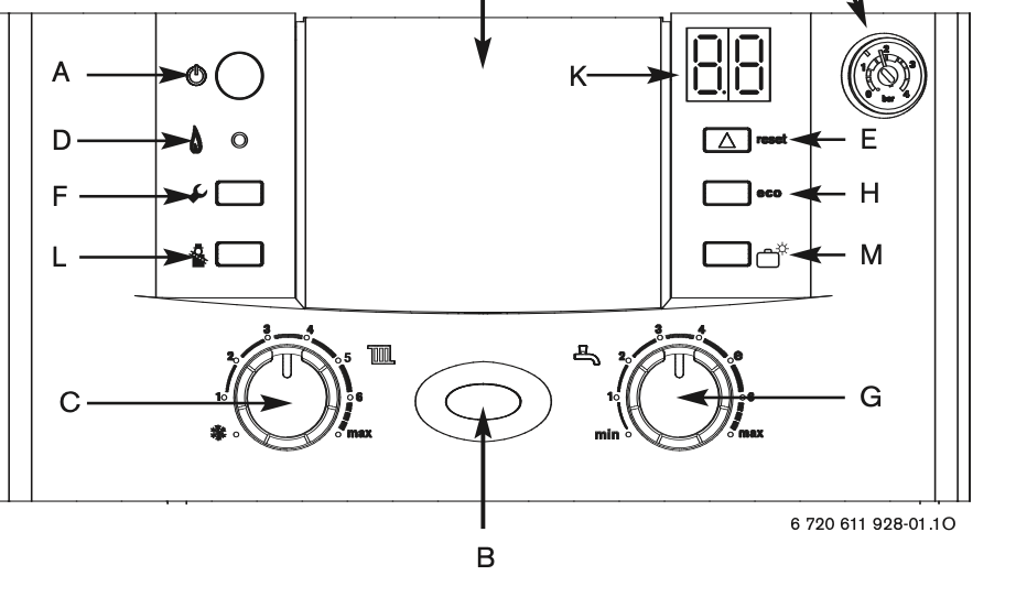

When the heating is on, I see a number on the screen (Marked K). As it stands this is showing '50', but appears to fluctuate between 50 and 66 -- so I am to assume this is the return temperature, suggesting I am only dissipating 14.9c in my radiators?

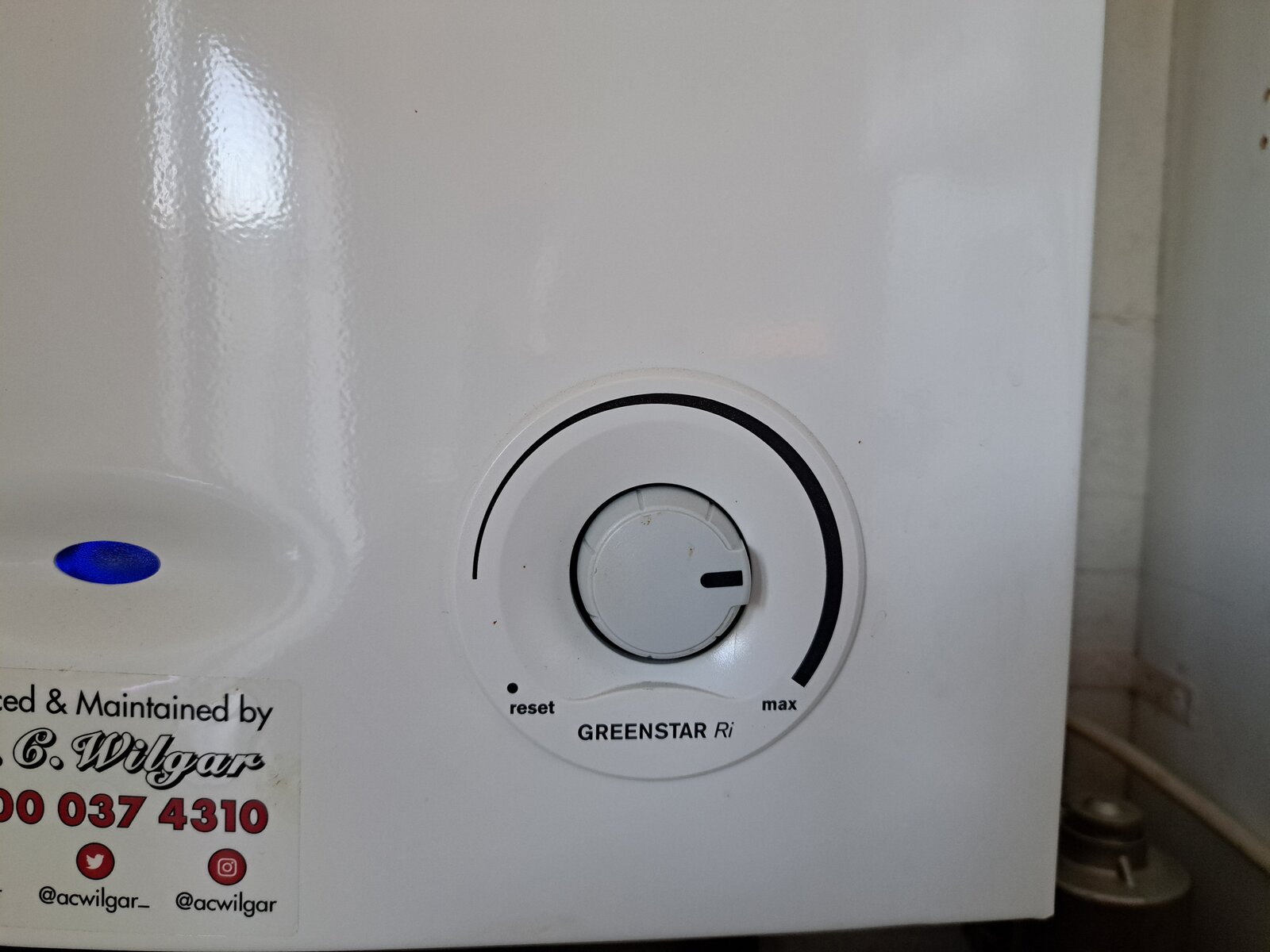

Can I also ask if I can apply the above calculation to my unmarked dial as I'd like to know my flow temperature. It's a Greenstar system boiler.20240119_101514.jpg
Thanks gas112 - it's just the manual that said 40 - 90 - not 82? Nevertheless, I can adjust my original post. Can you comment about my main questions?
