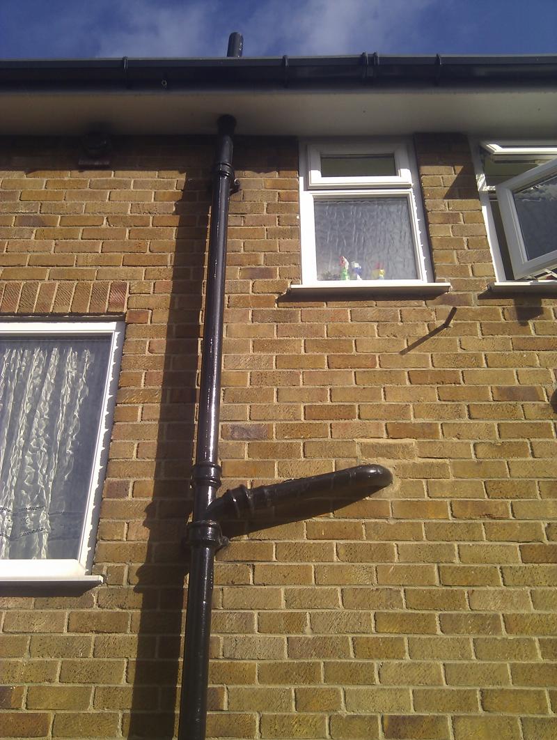

no luck with proper pics - but the attached pic, image two of those coming from my house (looks like the water from the house routes into it) and the long middle one flowing down the street.

@ Harry Bloomfield - think I'll ask the plumber that, but looks like all water from the house, including waste (can't see any other route out, but then i'm no expert)
So pour water down your sinks, washbasins and flush toilets, whilst someone watches for the flow. Pour water down rainwater gulleys and see where that goes..

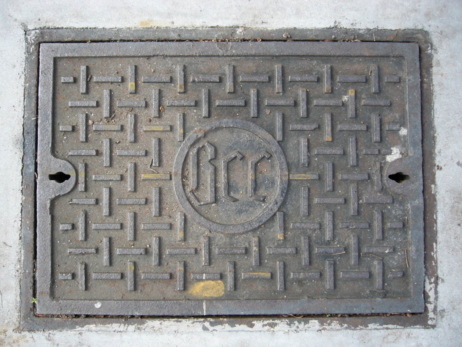

Tried that it all joins together and flows into hole (just outside the sink in my pic), for toilet waste tested it and soil pipe ends up in the same hole (a bit like the attached) - can hear water coming down. Then the only place i can imagine it going is that manhole, but can't lift it myself to see. Think i'll ask the plumber tomorrow to lift it and test again.
Unless there's a hidden route somewhere, i can't imagine there's anywhere else it would go.
That is the toilet and the pipe which continue up through the roof, is the vent pipe. Nothing to do with rain water from the roof.

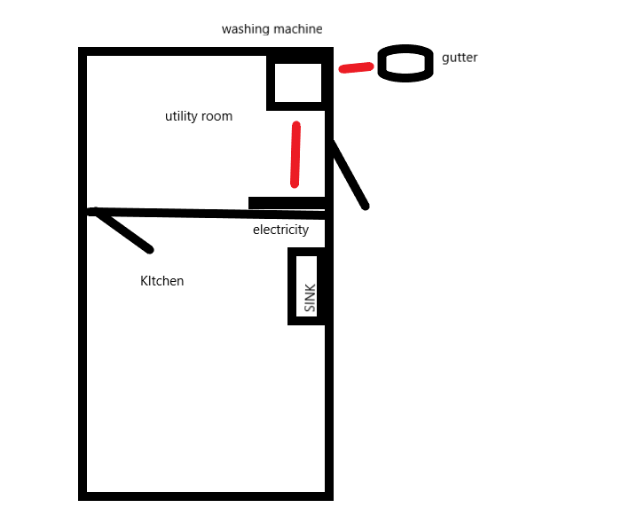

Regarding the water supply to the new site for the washing machine.
There should be no problem with doing this inside the house from your present sink position. If the water supply to your sink comes down the wall, (the hot one at least will probably come down the wall in that area assuming your hot tank is upstairs as usual), then the plumber can tee off both pipes at ceiling level and run them through the adjoining wall, above door height, then drop them down the wall in the utility room to a position suitable for the washing machine.
The electrician will do something similar with the electric cable(s) or maybe be able to spur off a socket in one of the upstairs rooms if one is available.
If the plumber is able to discharge the washing machine into the outside downspout he will have to ensure it is fitted in such a manner as to prevent any water flowing from the downspout back into the washing machine outlet. He will also have to have some sort of water trap to prevent smells from the drains being able to filter into the washing machine waste pipe.
Whatever you decide to do I would advise against using the 'builder', (substitute the words "possible cowboy" if you wish), to do any work as from your brief description he sounds as though he would do as he wishes, not what the law decrees.
Get a Plumber in who knows what they are doing, it seems pretty obvious your 'Builder' cant or wont do the job for whatever reason.
Modern washing machines are cold fill only, so you'll only need a cold supply, this should be fairly easy to run from the sink position next door. Suitable lagging may suffice to prevent it from freezing, but that also depends on construction of the utility room, and how cold it gets in the winter! Electricity supply can be taken from any suitable point, needs an Electrician to sort. Drainage, where doe the kitchen sink currently drain to? If the rainwater drain isn't suitable for grey water, there may be other options. Some pics of utility room, inside and out may help us tell you more.
