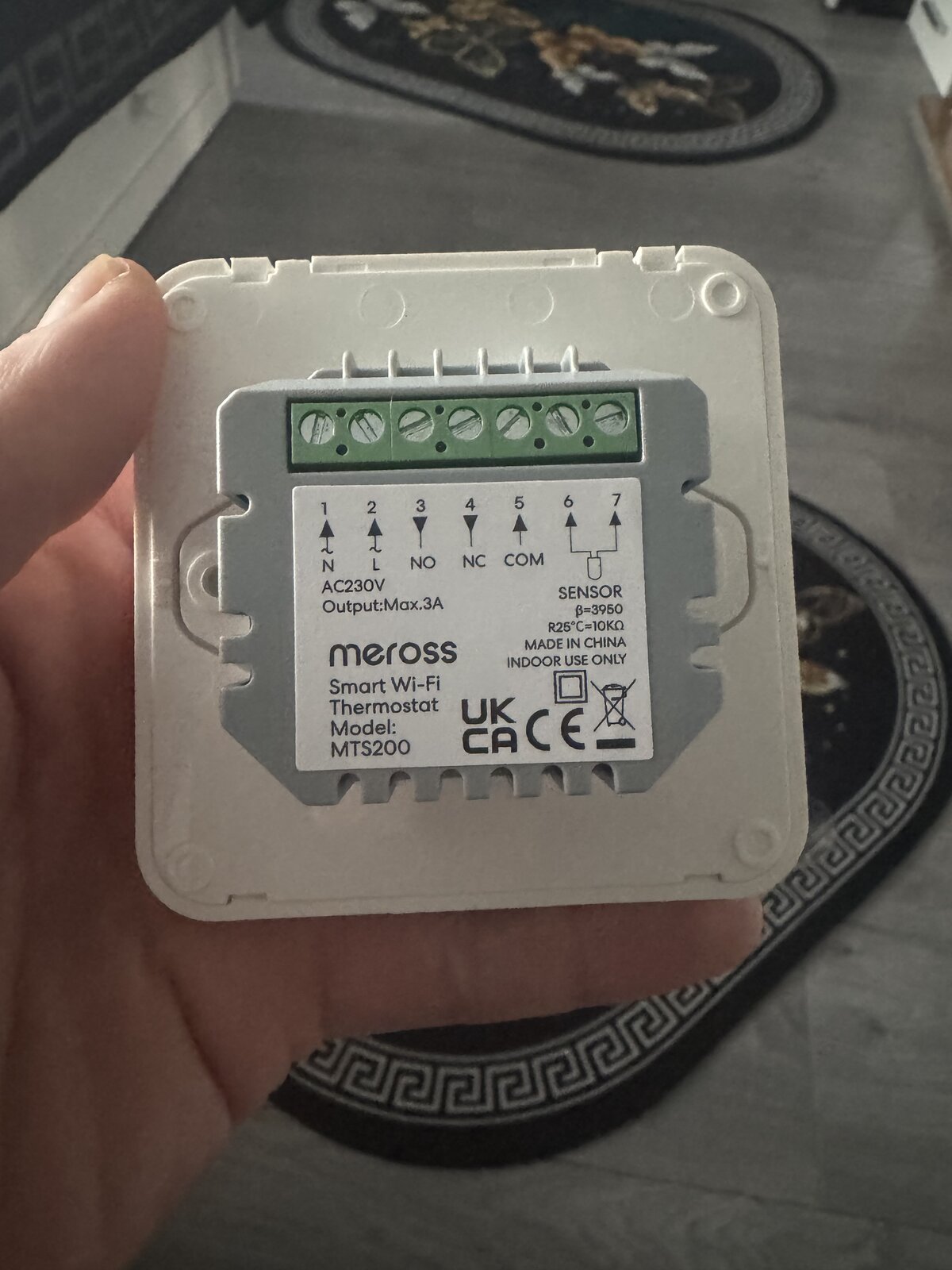

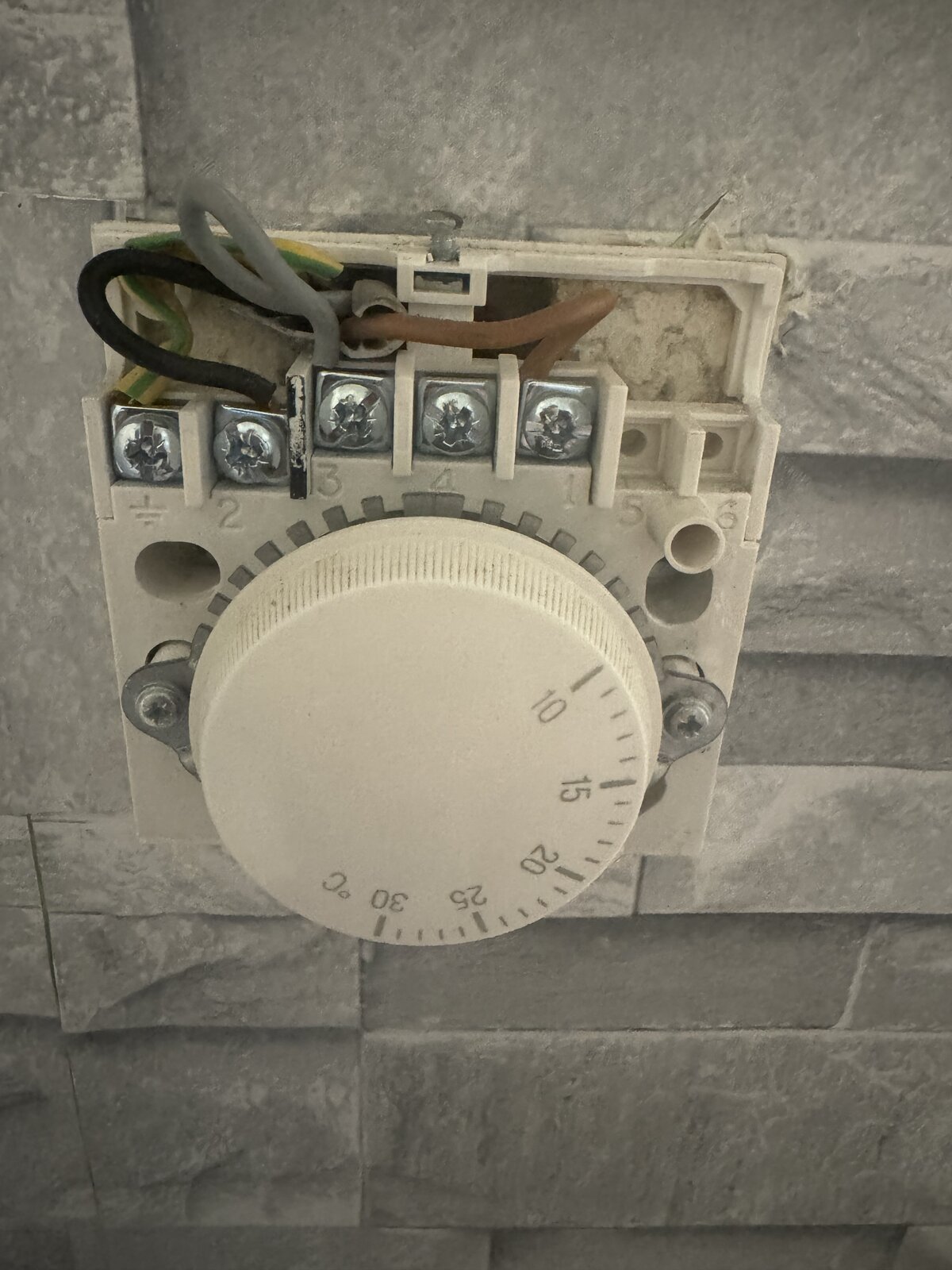

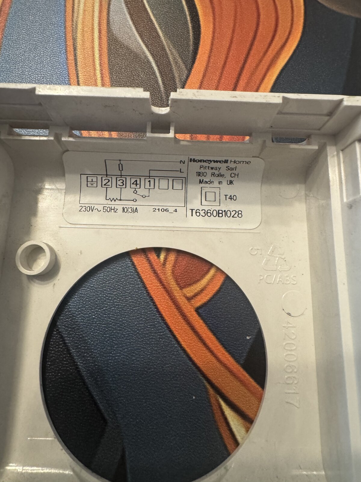

I need the help for change the old honeywell thermostat for the new one merossMTS200 , but i dont know how to set up the cable , can someone can help please

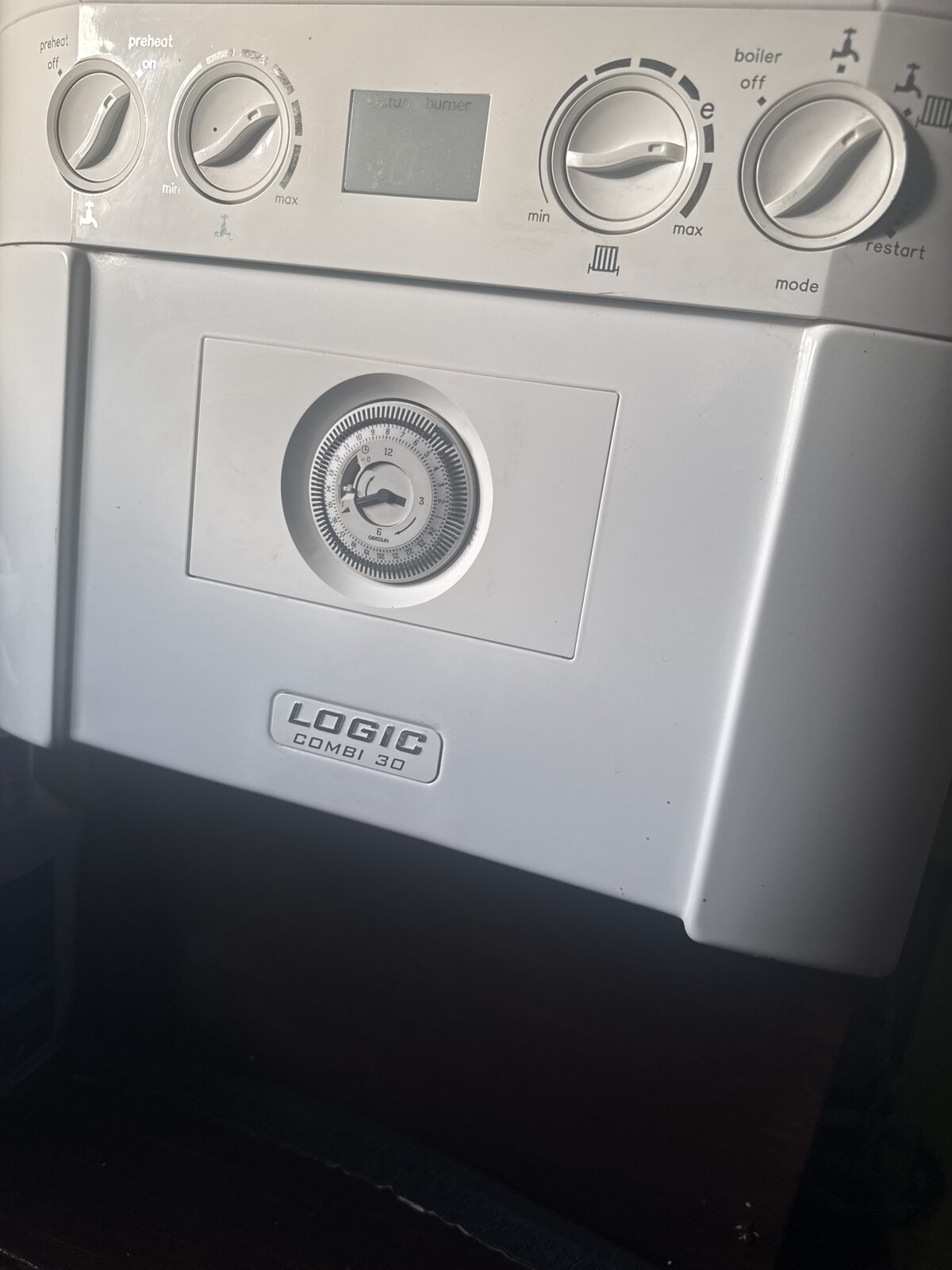

What boiler is it? The reason I ask is the Mehross needs a permanent live and permanent neutral, and if that's not being supplied it won't work

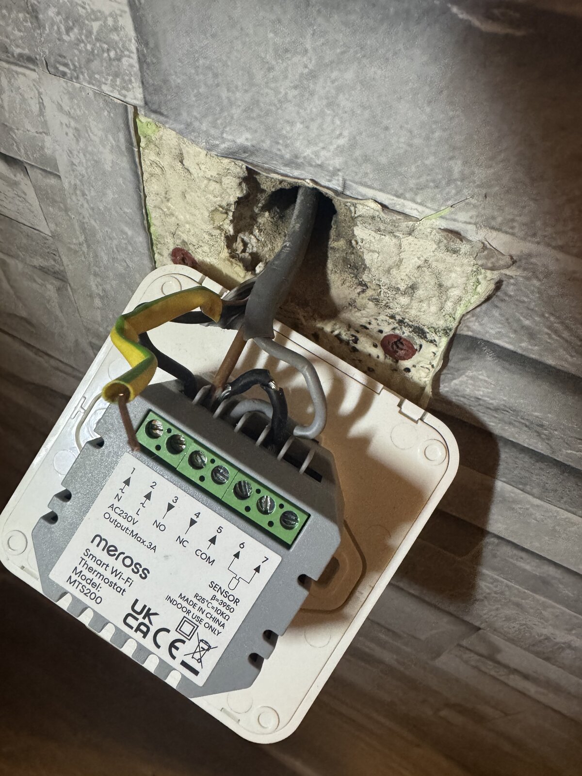

Hi guys i try set up now but looking like no power in
Have you got the screw touching the wire in the terminal and not on insulation? That link wire is dangerous. Also is the boiler on?
Yes mate . But still no power , dont wanna switch on
The power is fed from the boiler, so unless you switch on, then it won’t have power. As I stated in post#2, it needs a permanent live and permanent neutral.
