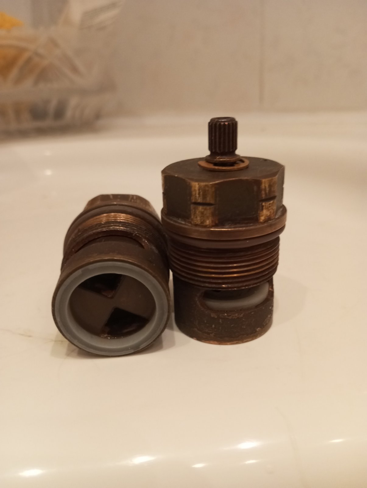

Hi everyone,
The faucet on my bathtub has stopped working — both the hot and cold water mechanisms. It is an old built-in fixture, approximately 30 years old, and of English manufacture. Unfortunately, I do not know the brand or model, and I am looking for suitable spare parts. Would anyone be able to advise me on this or offer some info for the model? Many thanks in advance for your help!
Try searching for tap cartridges on British DIY stores, e.g. Screwfix.
These ones aren't quite right but they are similar:
Also, I think you might be looking for 1/2" BSP (British Standard Pipe), but you'll have to measure them.
